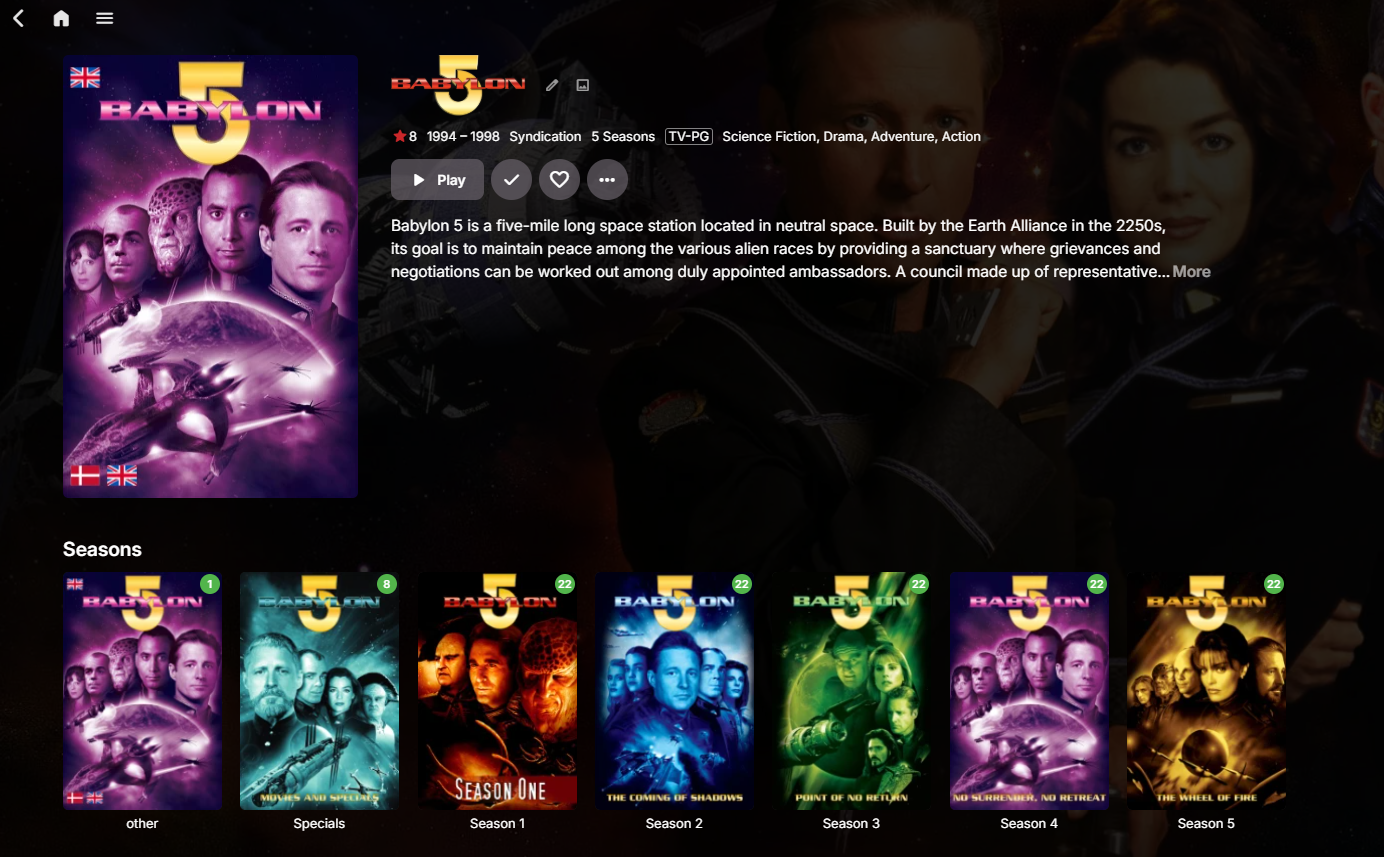

Neminem 1625 Posted May 18, 2025 Posted May 18, 2025 Jackpot Nice @yocker Now to see what happens when I remove the dummy srt files
Neminem 1625 Posted May 18, 2025 Posted May 18, 2025 As predicted subs flags went away. You might want to write that out in BOLD, to save your self some dumb support questions
yocker 1423 Posted May 18, 2025 Author Posted May 18, 2025 8 minutes ago, Neminem said: As predicted subs flags went away. You might want to write that out in BOLD, to save your self some dumb support questions What do you mean ?

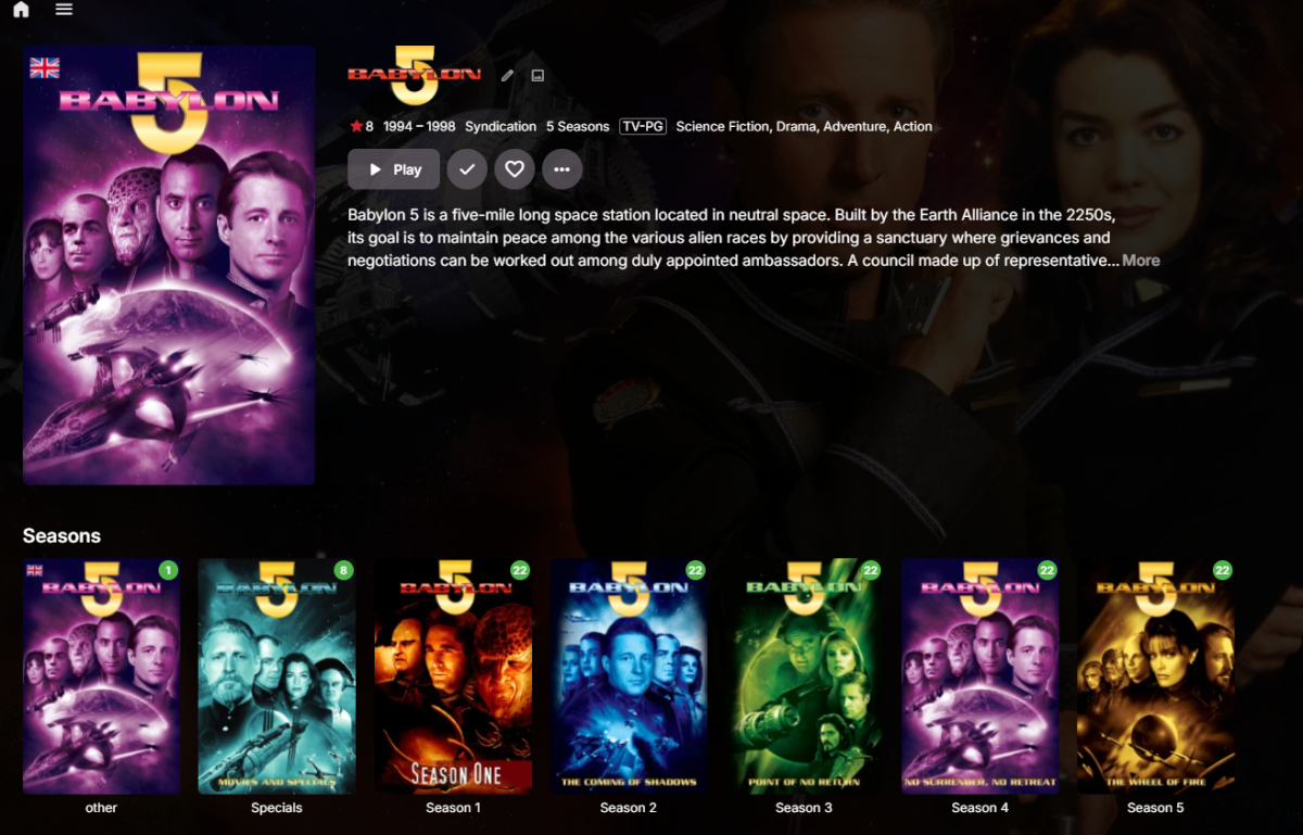

Neminem 1625 Posted May 18, 2025 Posted May 18, 2025 (edited) I created some dummy srt files for the video my "other" library. To make sure that I had da and en subs for all episodes. They are 0 bit srt files. I removed those dummy files, and sub flags was removed from poster.ย 38 minutes ago, Neminem said: Hmm I have created some dummy srt files, for that 1 file without srt files. And the episode is now showing language and subs on thumb. Ohh yes I'm sure all normal episodes + specials have srt files, checked that too. ย Edited May 18, 2025 by Neminem
yocker 1423 Posted May 18, 2025 Author Posted May 18, 2025 (edited) 3 minutes ago, Neminem said: I created some dummy srt files for the video my "other" library. To make sure that I had da and en subs for all episodes. They are 0 bit srt files. I removed those dummy files, and sub flags was removed from poster.ย ย Ah. The icons only shows if all episodes have for example english audio and/or subtitles.. If just one is missing it won't be shown Good point though, must remember to put that in the readme. Edited May 18, 2025 by yocker 1
Neminem 1625 Posted May 18, 2025 Posted May 18, 2025 (edited) Jep it was a test to see what would happen, if 1 episode had missing subs Edited May 18, 2025 by Neminem 1
yocker 1423 Posted May 18, 2025 Author Posted May 18, 2025 2 minutes ago, Neminem said: Jep it was a test to see what would happen, if 1 episode had missing subs I misunderstood you then sorry. Well.. Seems i can take the rest of the sunday off now. Again, i really appreciate the help!

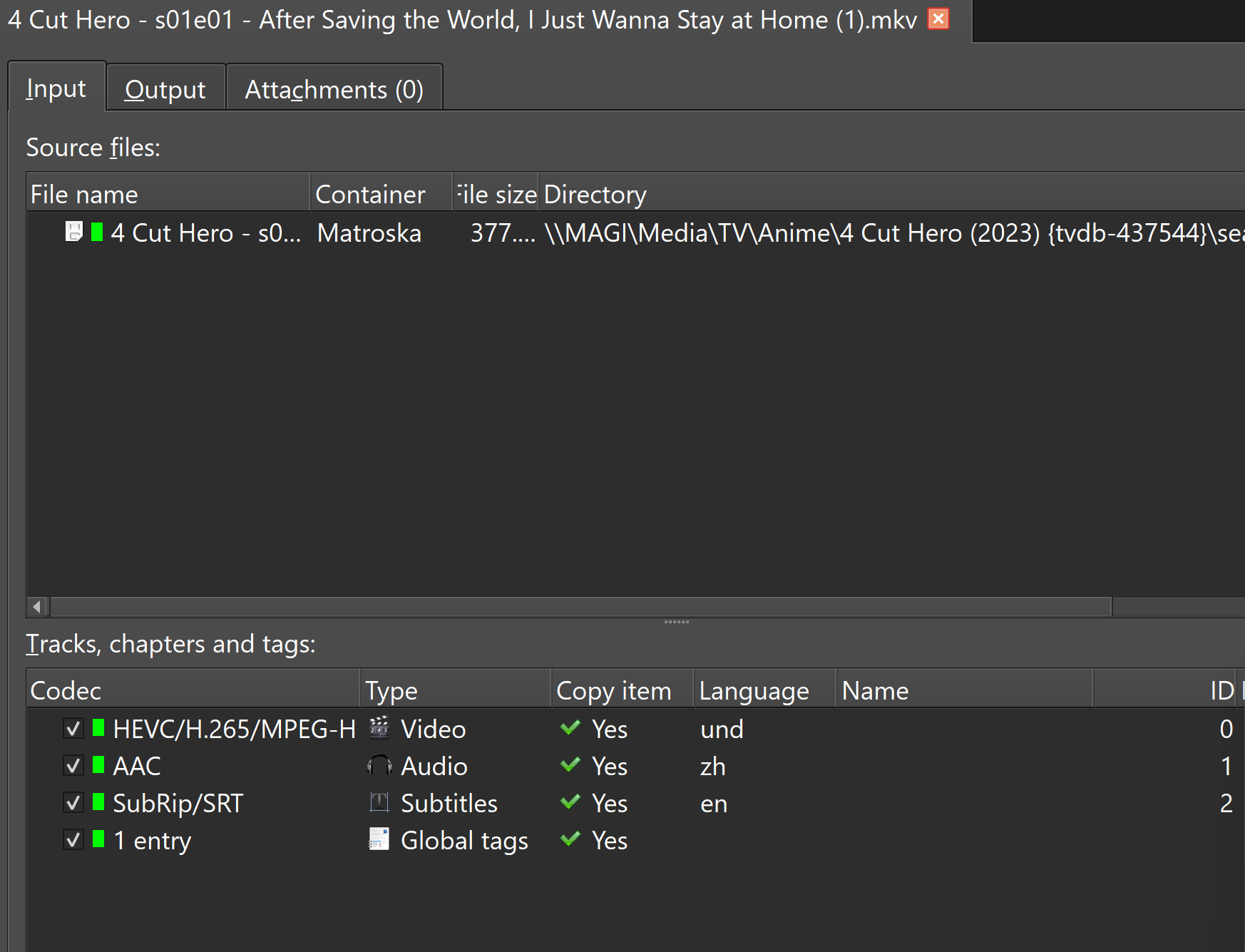

keitaro26 22 Posted May 18, 2025 Posted May 18, 2025 The series icons are working great, but I am having a problem with a Chinese language series. MKVTool shows the language code as zh and I have that in both my settings and an icon but it is not being labeled in Emby, neither the episodes nor the series.

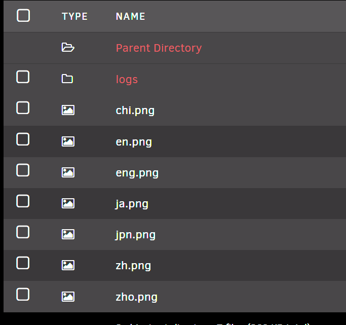

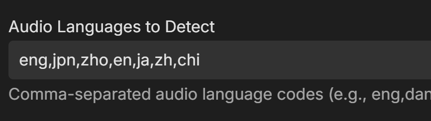

yocker 1423 Posted May 18, 2025 Author Posted May 18, 2025 3 minutes ago, keitaro26 said: The series icons are working great, but I am having a problem with a Chinese language series. MKVTool shows the language code as zh and I have that in both my settings and an icon but it is not being labeled in Emby, neither the episodes nor the series. Make sure the icons are named the same as the language code. If you have zh then the icons should be named zh.png and srt.zh.png ย
keitaro26 22 Posted May 18, 2025 Posted May 18, 2025 (edited) 8 minutes ago, yocker said: Make sure the icons are named the same as the language code. If you have zh then the icons should be named zh.png and srt.zh.png ย They are named the same. Edited May 18, 2025 by keitaro26
yocker 1423 Posted May 18, 2025 Author Posted May 18, 2025 (edited) 59 minutes ago, keitaro26 said: I appreciate it! This should fix it. I had problems with 2 and 3 letter language codes in an earlier version so changed it to just use a list until i had time to fix it. When i did that i forgot to add a lot of languages inc. Chinese. It's not the most elegant way of fixing it but will do for now until i have time to look further into it. Edit: Thank you for the bug report! EmbyIcons.dll Edited May 18, 2025 by yocker
keitaro26 22 Posted May 18, 2025 Posted May 18, 2025 21 minutes ago, yocker said: This should fix it. I had problems with 2 and 3 letter language codes in an earlier version so changed it to just use a list until i had time to fix it. When i did that i forgot to add a lot of languages inc. Chinese. It's not the most elegant way of fixing it but will do for now until i have time to look further into it. Edit: Thank you for the bug report! EmbyIcons.dll 44 kBย ยทย 1 download It's working perfectly now! Thanks again! 1
