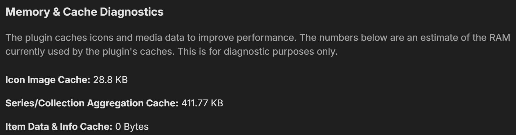

yocker 1423 Posted August 14, 2025 Author Posted August 14, 2025 2 minutes ago, keitaro26 said: I take it back. After going through my libraries to preload the cache, everything got much slower. I wonder if its just the sheer size of my libraries negatively impacting. I have over 100k files. I added a memory usage monitor in the troubleshooter for my own testing, can you check what that says ?
keitaro26 22 Posted August 14, 2025 Posted August 14, 2025 4 minutes ago, yocker said: I added a memory usage monitor in the troubleshooter for my own testing, can you check what that says ? 1

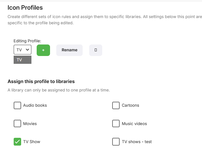

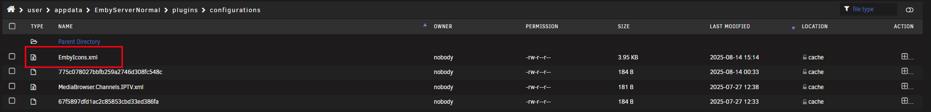

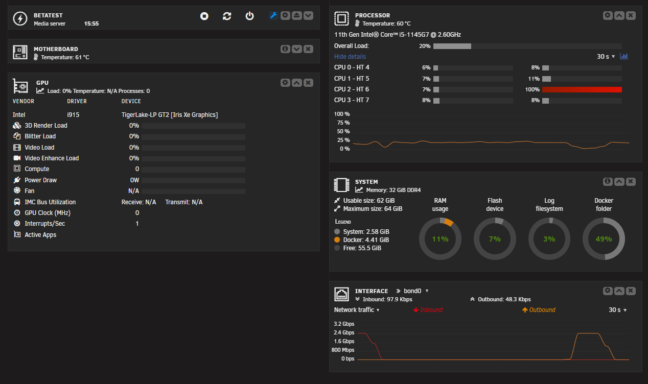

Neminem 1625 Posted August 14, 2025 Posted August 14, 2025 Just a quick question. Is the plugin creating cache for folders not enabled ? In this example Movies are not enabled. Movies and 2 more pages - Personal - Microsoft Edge 2025-08-14 15-28-50.mp4 I tested my deleting plugin and xml file. Not sure if that is enough to restart / retry / delete all. But even movie library is slow loading and that's not enabled in config.
yocker 1423 Posted August 14, 2025 Author Posted August 14, 2025 7 minutes ago, Neminem said: Just a quick question. Is the plugin creating cache for folders not enabled ? In this example Movies are not enabled. Movies and 2 more pages - Personal - Microsoft Edge 2025-08-14 15-28-50.mp4 40.52 MB · 0 downloads I tested my deleting plugin and xml file. Not sure if that is enough to restart / retry / delete all. But even movie library is slow loading and that's not enabled in config. Is that with the one i gave Sh0rty? I can't replicate it on my end.
Neminem 1625 Posted August 14, 2025 Posted August 14, 2025 Yes that the one I'm testing now But as always on my test system old NUC
sh0rty 728 Posted August 14, 2025 Posted August 14, 2025 Also after some time away the latest dll ist far better than the previous ones. Loading of recently added Movies and TV Shows still not as fast as 5.30.2, but okay.
yocker 1423 Posted August 14, 2025 Author Posted August 14, 2025 It made to ignore folders what it's not meant to work in so what you are seeing is strange.
