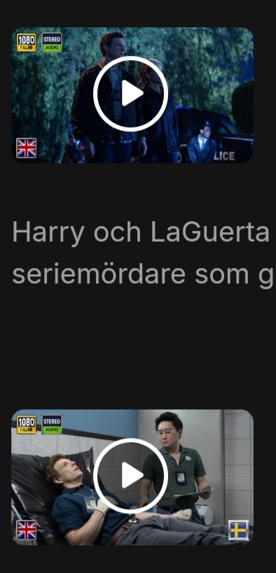

MediaIntelNUC 36 Posted June 29, 2025 Posted June 29, 2025 18 minutes ago, yocker said: Okay will look at it then. Until then, in case it might be this: For icons on TV show posters every single episode must have for example that same subtitle language. "Lite mode" changes that to only the first episode in a TV show to save on resources. Hi! I know, i have checked two examples in Dexter: Original Sin where ep.8 does not display swedish flag for subtitle but ep.9 does, pic attached. Both srt:s has the same languagecode, sv.srt wich is the same as all my attached srt:s. FYI i have not used "TV-lite" when scanning but regular scanning Both have same filename as mp4 file. Thanx! Dexter.Original.Sin.S01E09.Blood.Drive.1080p.WEBRip.x265-DH.sv.srt Dexter.Original.Sin.S01E08.Business.and.Pleasure.1080p.WEBRip.x265-DH.sv.srt

yocker 1423 Posted June 29, 2025 Author Posted June 29, 2025 17 minutes ago, MediaIntelNUC said: Im the one to say thanx, your plug-in is awesome,thanx for sharing It was because you used "sv" in your subtitles instead of "swe", something i hadn't taken into consideration. I edited the language detection to look for "sv" as well as a few more languages just to be safe. Thank you and enjoy! EmbyIcons.dll
MediaIntelNUC 36 Posted June 29, 2025 Posted June 29, 2025 Ok! Thanx, but all my external Srt files are all namned sv. aswell as both examples i attached, none is named swe. If the error is the namning sv, then none of the attached srt:s would be visible. Just so it understand it correctly..
yocker 1423 Posted June 29, 2025 Author Posted June 29, 2025 7 minutes ago, MediaIntelNUC said: Ok! Thanx, but all my external Srt files are all namned sv. aswell as both examples i attached, none is named swe. If the error is the namning sv, then none of the attached srt:s would be visible. Just so it understand it correctly.. That sounds strange. I tried replicating the precise same thing as you have, i don't have a swedish icon so i used a Chinese instead. I used the same .srt files as you sendt plug renaming my video files to match the srt files. I can't replicate it on my end. Have you tried a metadata refresh with forced "replace images" on? This is with the new version i made though so try and that see if it fixes it. If not then i will look further into i.

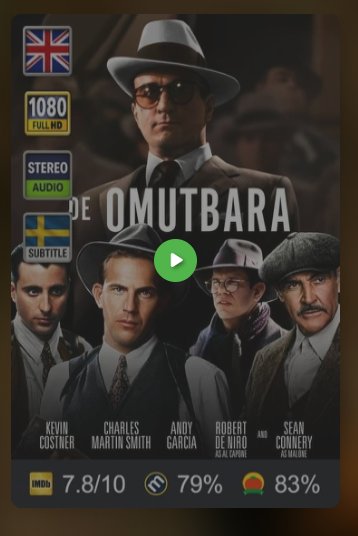

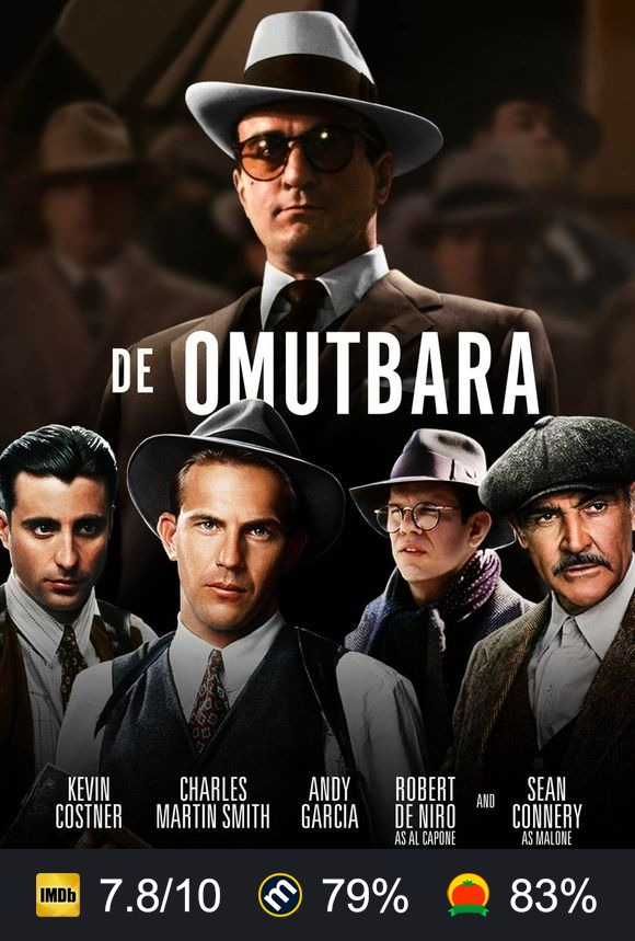

MediaIntelNUC 36 Posted June 30, 2025 Posted June 30, 2025 Everything works awesome.. This plugin is awesome.. You are awesome for making this plugin.. One question, i have this Rpdb-plugin that showes ratings on primary posters bottom, it downloads the poster with that information (pic attached) Is it possible to do that with your icons aswell? hope you understand the question:) One pic without your icons is from moviefiles on drive, the other from Emby library.. Thanx again! 1
yocker 1423 Posted June 30, 2025 Author Posted June 30, 2025 17 minutes ago, MediaIntelNUC said: Everything works awesome.. This plugin is awesome.. You are awesome for making this plugin.. One question, i have this Rpdb-plugin that showes ratings on primary posters bottom, it downloads the poster with that information (pic attached) Is it possible to do that with your icons aswell? hope you understand the question:) One pic without your icons is from moviefiles on drive, the other from Emby library.. Thanx again! Awesome! Happy it works! No sorry, not right now anyway. The community rating (IMDb) it shows right now is something it gets from Emby it self. Having it download, possibly through an API, other ratings and posters would require what amounts to a rewrite of the whole detection system. It has given me an idea to add an option to scale the poster in such a way, that the icons are drawn over and under the poster so that they no longer block movie names. Will look into that, might take a good while before i have that ready though so don't look to much forward to that. Anyway.. I'm very happy it works fully for you now, many thanks for your patience and thanks for flying EmbyIcons airlines!!
