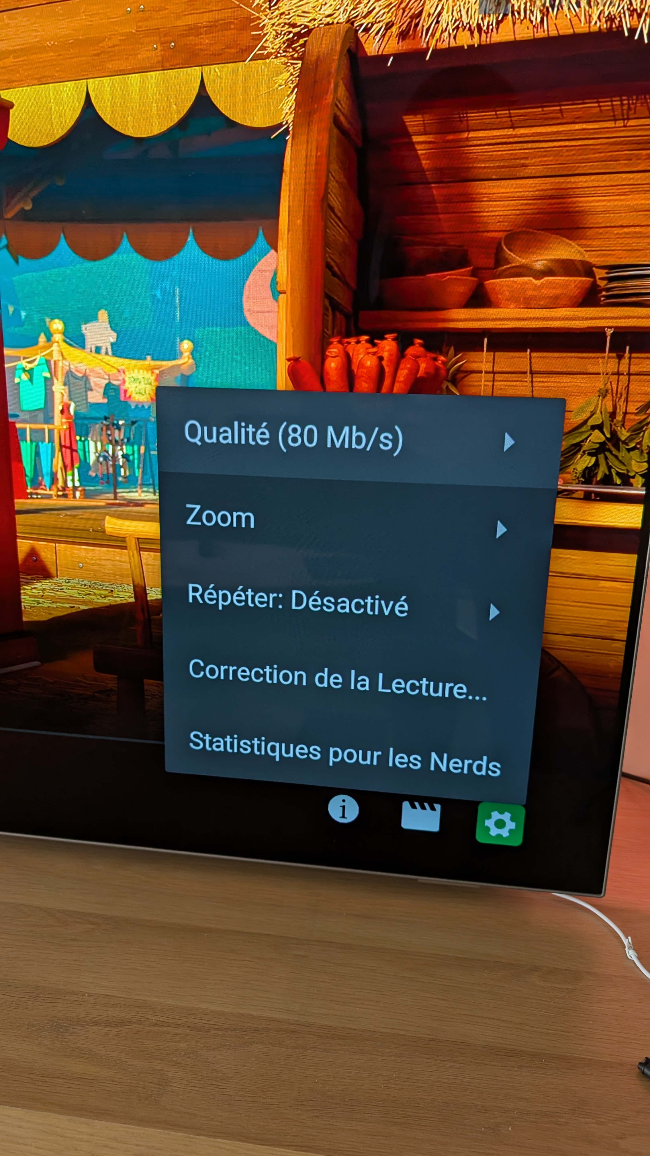

OUARZA 4 Posted May 10, 2025 Posted May 10, 2025 Hello, I am on Android TV and I do not have access to the change in the playback speed. How to do? Thank
GrimReaper 4897 Posted May 11, 2025 Posted May 11, 2025 Have you explored OSD Cog menu during playback?
OUARZA 4 Posted May 11, 2025 Author Posted May 11, 2025 6 hours ago, GrimReaper said: Have you explored OSD Cog menu during playback? How to access it? I did all the buttons on my remote.
GrimReaper 4897 Posted May 11, 2025 Posted May 11, 2025 During playback, bring up OSD (D-pad down), navigate to Cog icon (D-pad right-right-right...), select Speed (D-pad up-up..), D-pad OK.
OUARZA 4 Posted May 11, 2025 Author Posted May 11, 2025 (edited) Exactly, I don't have the speed. The problem is that I activated the speed but I don't know how, and above all I can't go back and be x1. Edited May 11, 2025 by OUARZA
GrimReaper 4897 Posted May 11, 2025 Posted May 11, 2025 (edited) Likely related to bitstreaming compressed audio. If you select Playback Correction it should trigger audio remux, which should give you Playback speed adjustment option afterwards. You can also download Standard Android app from your Store and see how does it compare. Edited May 11, 2025 by GrimReaper

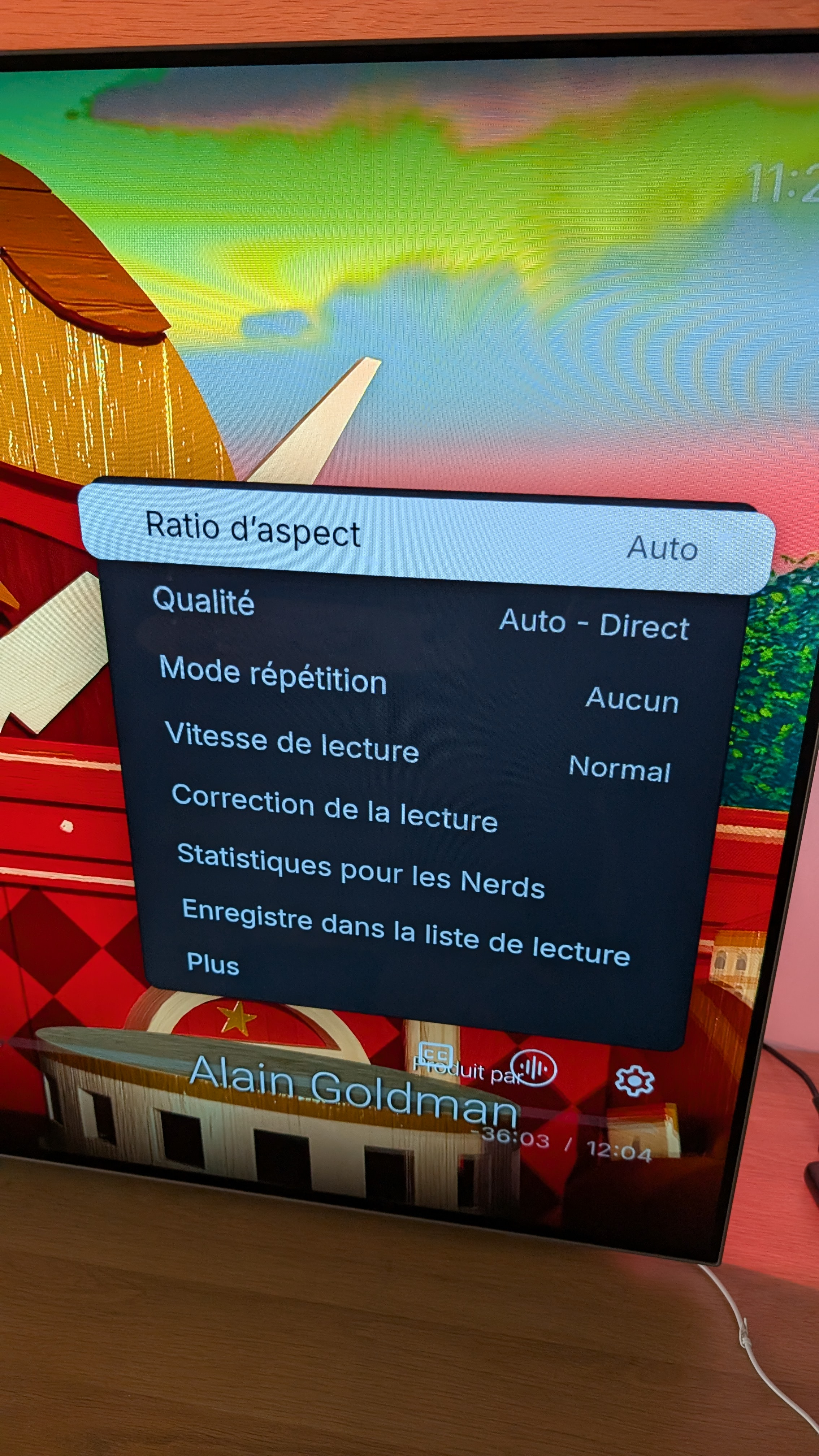

OUARZA 4 Posted May 11, 2025 Author Posted May 11, 2025 Indeed, I have to remux the audio instead of auto to get the speed setting. There are two strange things: 1/ How could I change the speed with my remote without having access to the speed setting in the cogwheel? 2/ I downloaded Emby for Android. On the same episode without any modifications, I have access to the speed setting. Should I use Emby for Android or Emby for Android TV on my Android TV? Emby for Android :
GrimReaper 4897 Posted May 11, 2025 Posted May 11, 2025 18 minutes ago, OUARZA said: 1/ How could I change the speed with my remote without having access to the speed setting in the cogwheel? Not implemented currently; you can lend your support here: 19 minutes ago, OUARZA said: 2/ I downloaded Emby for Android. On the same episode without any modifications, I have access to the speed setting. Should I use Emby for Android or Emby for Android TV on my Android TV? Generally, intention is to unify both apps/move towards the Standard one; if you're up for "some" reading, mega-thread re: feature-parity between the two apps:
OUARZA 4 Posted May 11, 2025 Author Posted May 11, 2025 1/ I'm not crazy, I managed to do it. I should have filmed. The only solution I found to get back to x1 playback speed is to clear the app cache and restart the TV.
Solution Luke 42243 Posted May 12, 2025 Solution Posted May 12, 2025 Hi, we recommend using Emby for android for best results with this function, thanks.
