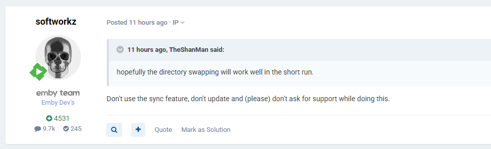

softworkz 5133 Posted May 14, 2025 Posted May 14, 2025 2 minutes ago, TheShanMan said: hopefully the directory swapping will work well in the short run. Don't use the sync feature, don't update and (please) don't ask for support while doing this.
TheShanMan 41 Posted May 14, 2025 Author Posted May 14, 2025 3 minutes ago, softworkz said: Of course these also support S-Video (or analog RGB, which is even better than S-Video). You will want (or even need) to drive both through the Nvidia when you go that route. Not that I saw, unless the dvi connector I saw is analog and you can get an s-video adapter for that. Not my preference. I'd probably just stick with 2 cards. 2 cards has worked fine in general for me for years (until this new Emby app). Just now, softworkz said: Don't use the sync feature, don't update and (please) don't ask for support while doing this. Why? If I'm swapping the whole Emby directory, there shouldn't be a sync issue, unless state is stored outside the directory too.
