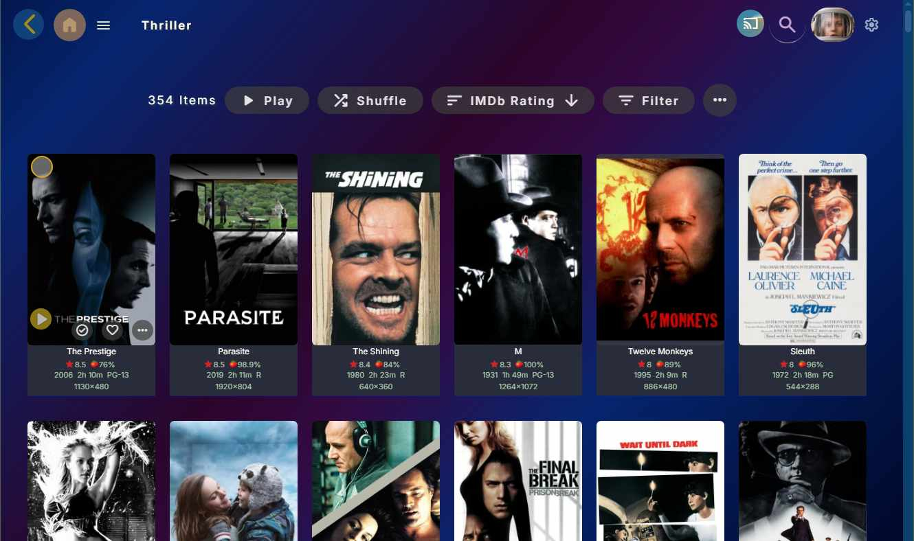

Currently, a genre page, for example, is presented when the URL has specific parameters which are values after the ? and & elements in the URL.  Look at the URL when you are on a genre page and you notice it ends in some parentId value followed by tab=genres.
The only extra pages that could be targeted with CSS are the home page and collection and playlist pages, but unfortunately the last two would override any background image you assiged to a specific collection page.  So, the custom style for background images tweak is really only good for the home page.  These CSS custom styles are available with my Custom State Street Theme.
Getting specific background images to the pages, you mentioned, you would need to add javascript so the CSS can then recognize this end parentId value and the tab=genres.  There is no method to add javascript inside the custom CSS.  There may be a plugin that allows additional javascript to be introduced in a custom way.  I have not bothered to look into this.  Even if that worked, it would likely default back to no custom javascript on every update and running additional custom javascripts is really not such a good idea.  It can conflict with the correct javascript functions. I believe this can only be a feature request.
The genre page is a little busy to have an image background.  My custom theme actually includes a choice of about 15 background swatch of blended colors at an angle for all pages that do not get an assigned background.  I prefer this solution.
Here is a genre page using the Custom State Street theme, which is available in the CSS style forum discussion.  If you use this custom CSS, be sure to scroll all the way to the bottom to get the latest update.  A new update is coming this month.

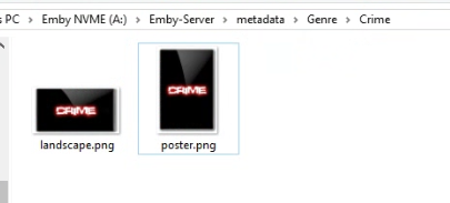

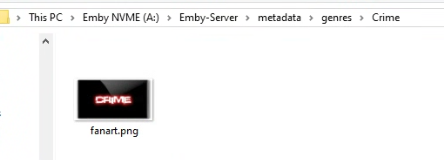

@LighthammerThere have been so many changes over the years as my primary server is still using the images in my Genre folder but if I make changes it migrates/saves to Genres folder.  So depending on how old your database is you could be using different folders but the UI will always save to the proper location and can see it in debug logging.
2025-05-07 08:53:33.076 Debug SqliteItemRepository: GetitemById Genre 207927 A:\Emby-Server\metadata\Genre\Crime
2025-05-07 08:53:33.078 Debug ProviderManager: Saving image to A:\Emby-Server\metadata\genres\Crime\fanart.png

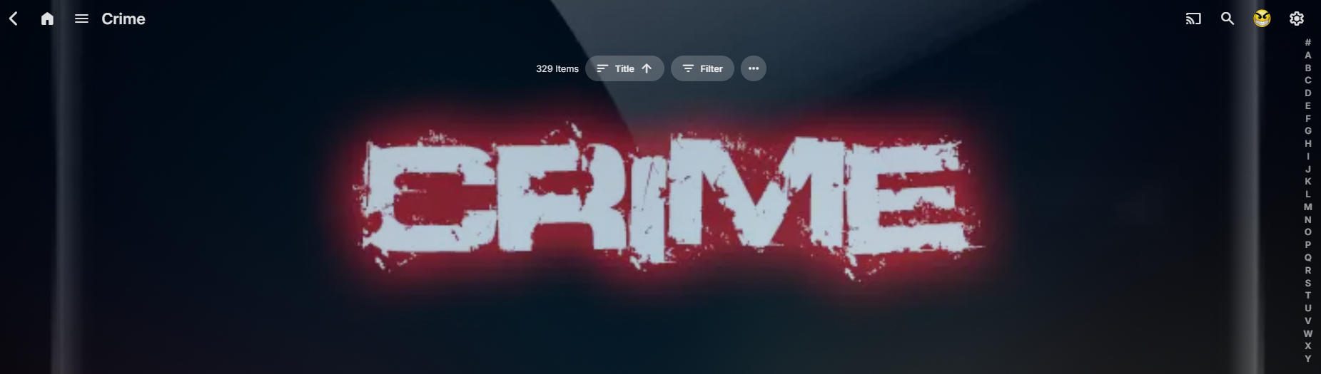

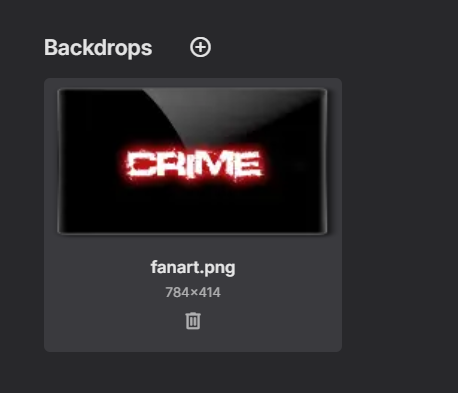

But had no issue saving a backdrop via Genre edit image on that genre and applying a backdrop to make it work assuming you have backdrops disabled as it will utilize library backdrops if you do.
Hide all media to show the backdrop.
But key is you cannot have backdrops enabled.
