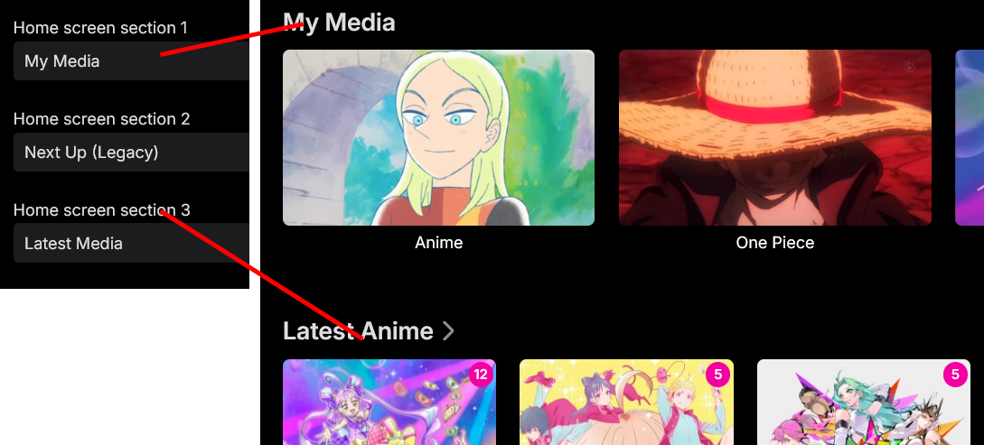

icegoddess222 8 Posted May 5, 2025 Posted May 5, 2025 hi ive been using the 'Next Up (Legacy)' as my main home screen section to keep tabs on what im watching and it recently vanished for me. i tried server resetting and toggling the section selection to a different section and back and neither have brought it back. is there anything i can do to get it reappear? im running server version 4.8.11.0 and it says its up to date thank you!

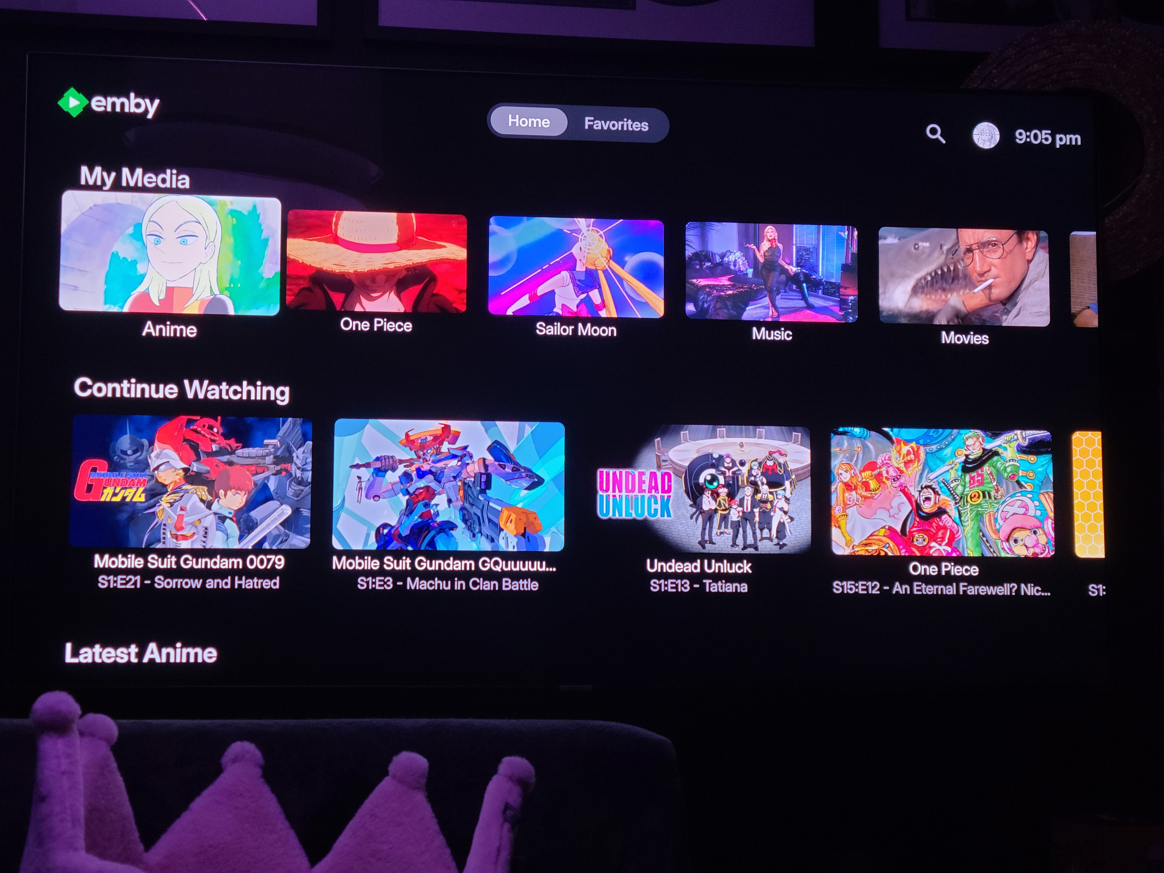

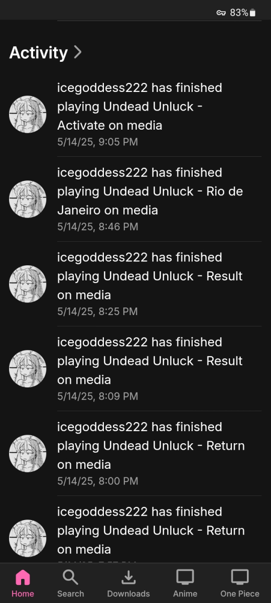

icegoddess222 8 Posted May 15, 2025 Author Posted May 15, 2025 is there anyway to get Next Up Legacy to work properly though? Continue Watching doesnt behave the same way and i prefer the way Next Up Legacy behaves. looking at the Activity (picture 1), you can see i just watched episode 12 of 'Undead Unluck' (episode titled 'Activate') but it remains in the third slot of Continue Watching (picture 2), when if the section was Next Up Legacy, it would be moved to the first slot
GrimReaper 4841 Posted May 15, 2025 Posted May 15, 2025 1 hour ago, icegoddess222 said: it remains in the third slot of Continue Watching (picture 2), when if the section was Next Up Legacy, it would be moved to the first slot That's odd, as it should also be displayed in the first slot in Continue Watching row; based on your Next Up (Legacy) not listing any items at all and your Continue Watching row having items out if order, it would appear that something is off with your system - for test purposes, could you: 1) Confirm that Next Up (Legacy) is not selected as a Home Screen section (select None instead), and have only Continue Watching row enabled 2) Mark Unded Unluck S01E13 Played - where does S01E14 show in Continue row? 3) Mark Undead Unluck Played on series level (which'll mark all episodes played), and then mark it Unplayed (click Play again) on series level, then click Played on first 12 episodes - where does E13 show now?
icegoddess222 8 Posted May 15, 2025 Author Posted May 15, 2025 okay it appears to be working normal today! i do have Next Up Legacy disabled as it doesnt display anything. but i did also try removing all sections and adding Next Up Legacy to see if it would appear then but it just showed a loading circle infinitely maybe the Continue Watching section was just experiencing a bug with my system last night thank you!
