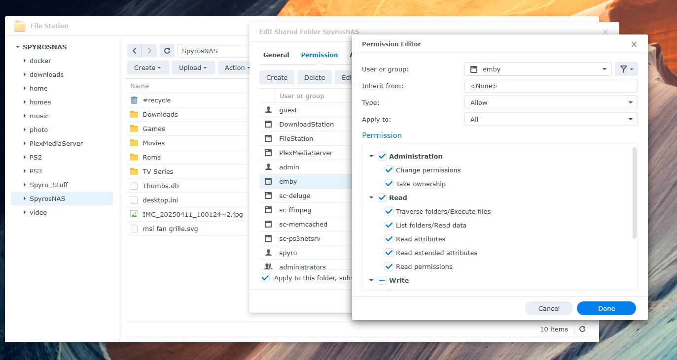

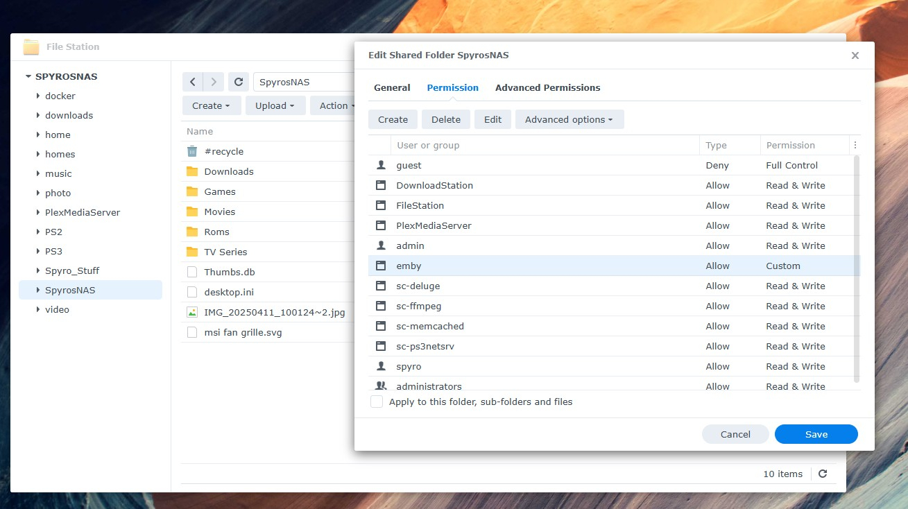

i launched emby using the http:192.168..... address and loads just fine. went through the web gui and got to the add folders area. at first the folders didnt show which was a easy fix by me just going to the synology file explorer and give the permissions to emby. my media is in the folders acordingly

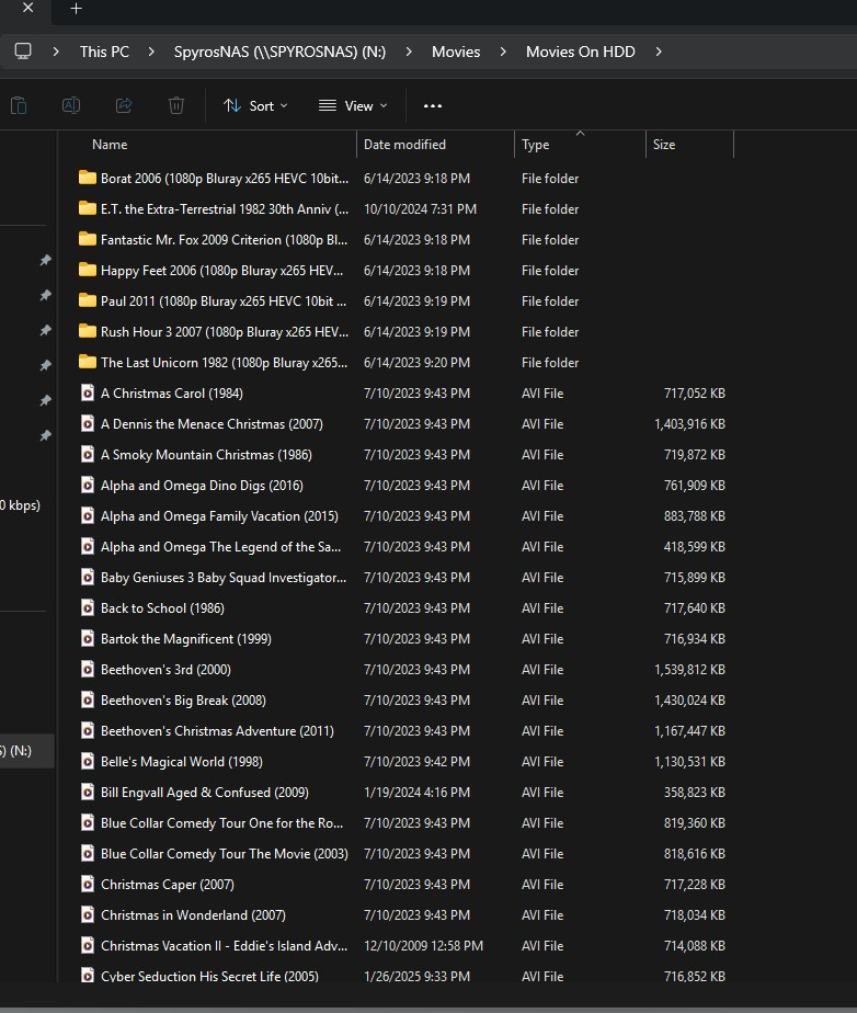

SpyroNAS/Movies

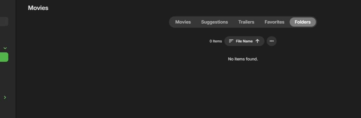

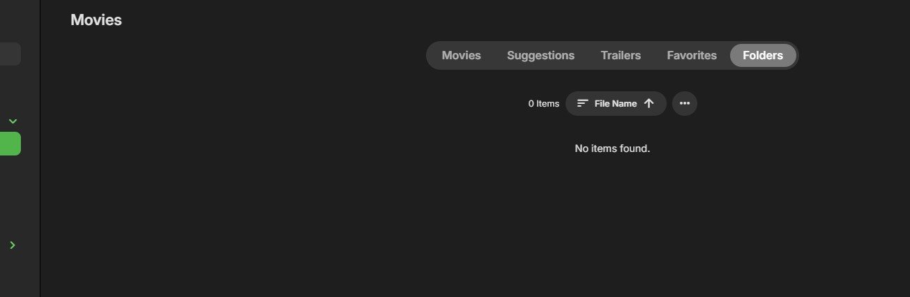

i added permissions to each and folders and sub folders show up accordingly in the setup gui. when i finish the gui, my music started populating and finished. but my tv series and movies never populate. nothing shows! i go to the folder list, nothing! i checked log and shows nothing!
here is my server log showing what i see (maybe i overlooked something???) to help u guys, it is 6:55pm as of typing this. i am going to take and hit scan library files on tv series and movies and write here after i did and attach the log file. (it showing finished at 6:57pm

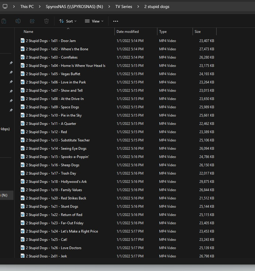

my media i also titled accordingly as showin in attachments:
permissions are also set for all the directories the same. aka subfolders
i am at a complete loss as i got music to work but not the other 2.. is it a bug? is something i got setup wrong? am i doing something wrong?
