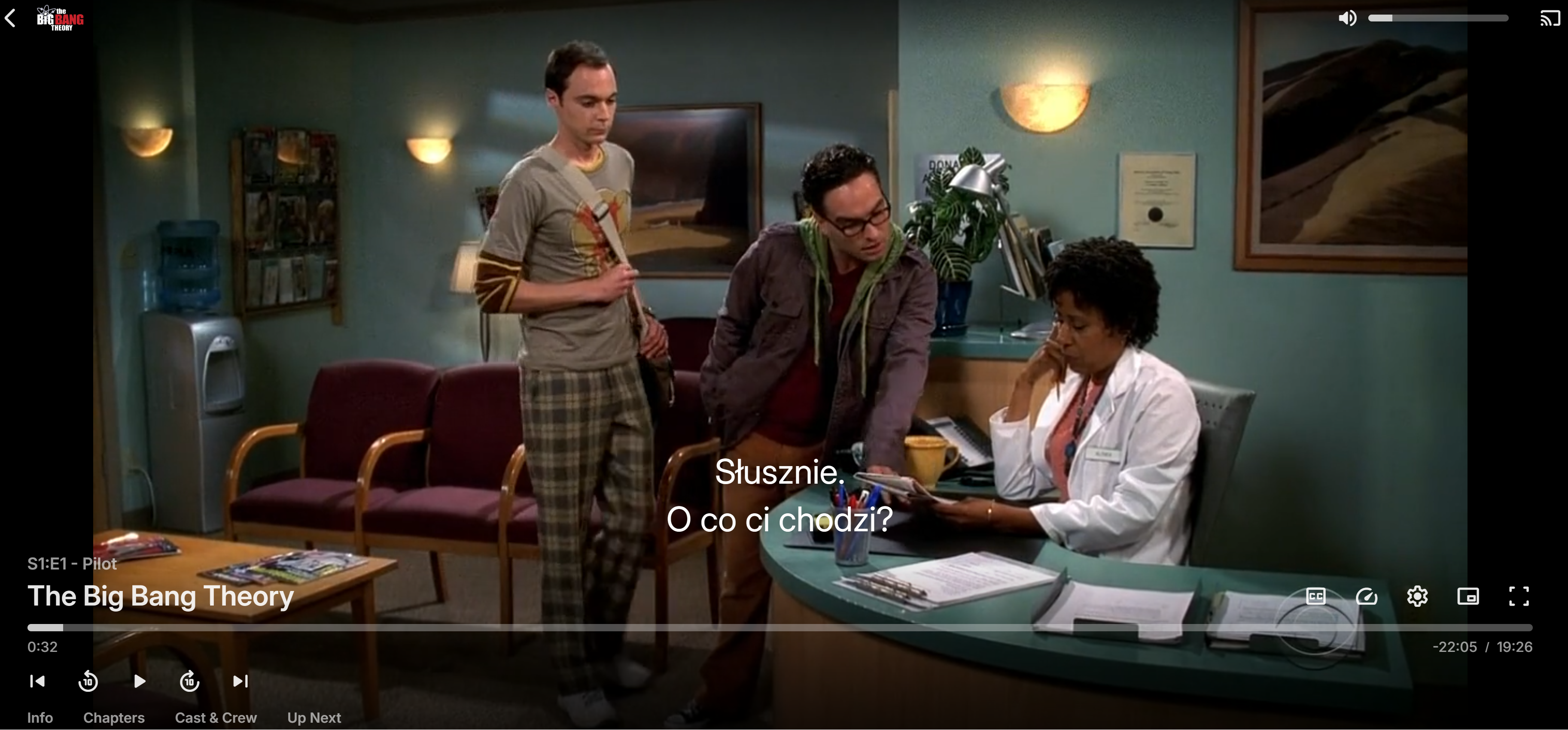

Kiniu 22 Posted May 1, 2025 Author Posted May 1, 2025 (edited) there it is: i assume that you dont understand polish so i will tell you this: the subs which are on the screen now suposed to be at 00:14 sec of the movie further gous then slower they get. i attach log file and no bazinga here... embyserver (1).txt Edited May 1, 2025 by Kiniu

GrimReaper 4896 Posted May 3, 2025 Posted May 3, 2025 (edited) On 5/1/2025 at 8:10 PM, Kiniu said: According your screenshot, that subtitle line (line 6) is showing where it is supposed to, timestamp 00:00:31.2, i.e. starts at approx. 31st second and last till approx. 36th (screenshot is at 32nd second); Quote 6 00:00:31,200 --> 00:00:35,700 Słusznie. O co ci chodzi? So it cannot be displayed 14 seconds earlier or later or at 00:14. What happened is that you likely have downloaded subs not suitable for your version of the episode video file, i.e. HDTV vs. WebRip/WebDL or BrRip. You can somewhat mitigate that by enabling hash-matches on OpenSubtitles (though it'll considerably reduce number of hits/downloads you'd get). Or you can use some external tool (like this one) to get those subs in sync. Or use Emby's Subtitle Offset feature during playback (if it's a constant offset, which often ain't the case). Edited May 3, 2025 by GrimReaper

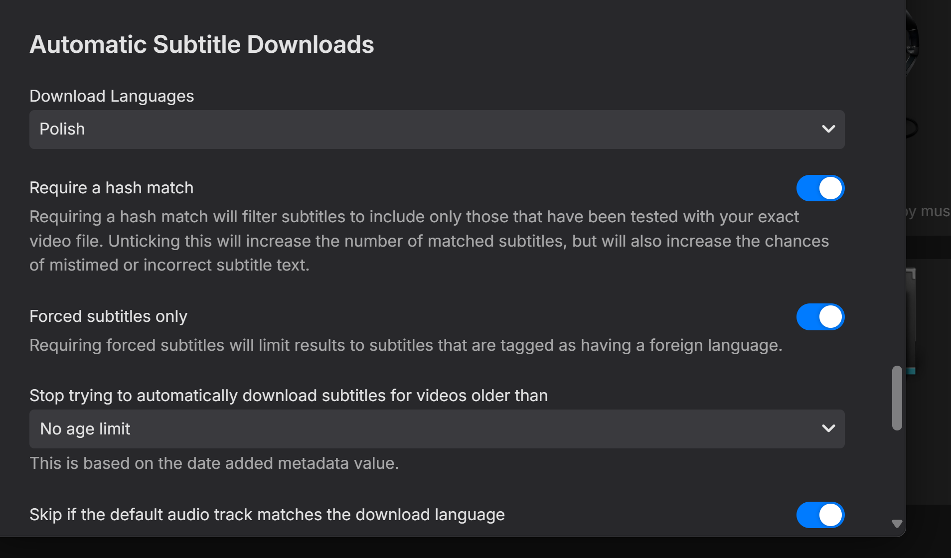

Kiniu 22 Posted May 3, 2025 Author Posted May 3, 2025 well it does display later i have no idea how i can show this otherwise to prove it, i just check your suggestion and i have this option selcted.all the subs download automatic.
GrimReaper 4896 Posted May 3, 2025 Posted May 3, 2025 2 minutes ago, Kiniu said: well it does display later Sorry, I'm not following that. Your screenshot shows that line is displayed where it should according your subtitle file, from 00:31 to 00:36.
GrimReaper 4896 Posted May 3, 2025 Posted May 3, 2025 1 minute ago, Kiniu said: here is the screenshot Then maybe it was downloaded from your other subtitle plugin/provider.
Kiniu 22 Posted May 3, 2025 Author Posted May 3, 2025 so it looks like emby reads file correctly , problem is that file itself is not good/right one... i will try to download some alternatives. thank u very much for your reply, i will post again if i find solution. have a nice day
GrimReaper 4896 Posted May 3, 2025 Posted May 3, 2025 3 minutes ago, Kiniu said: so it looks like emby reads file correctly , problem is that file itself is not good/right one... Correct. As a sidenote: you might wanna disable "Forced subtitles only" here: 17 minutes ago, Kiniu said:
