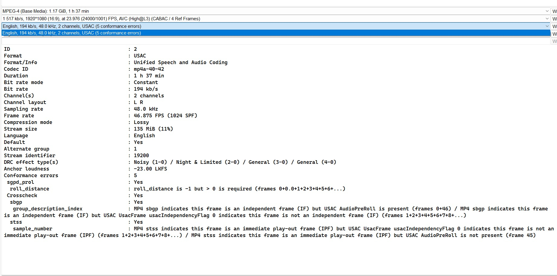

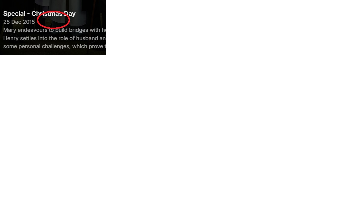

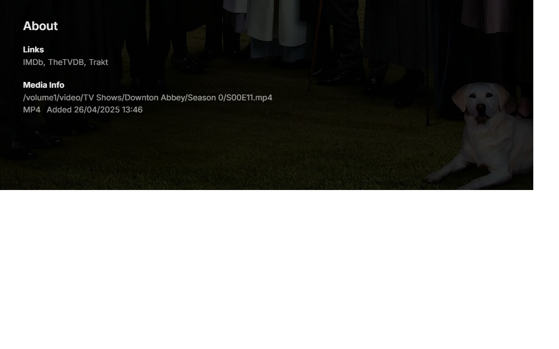

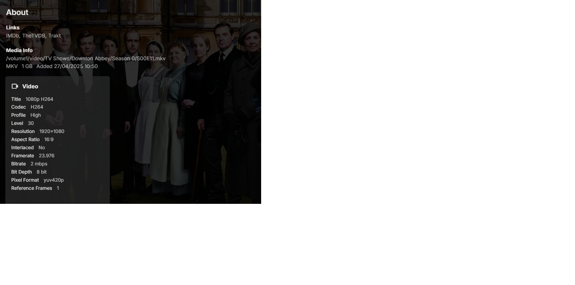

Paulguk 3 Posted April 27, 2025 Author Posted April 27, 2025 So I have attached some screen shots along with a before and after log. These are the actions I have carried out to aid you. 1. Placed problem file onto my NAS in the appropriate folder and ran a 'scan library files' of the season folder. 2. No media info shown giving duration of the episode or video and audio details (screenshots attached) 3. Downloaded first emby log (attached) 4. Loaded file into MediaInfo app and took a screenshot of the audio details to assist. 5. Stripped audio from the file using MKVToolNix. 6. Placed file without audio in the appropriate folder (overwriting the problem file) and ran a 'scan library files' of the season folder. 7. Details for the video now show. 8. Downloaded second emby log. embyserver (after audio stripped off and reindexed).txt embyserver (With issue).txt
