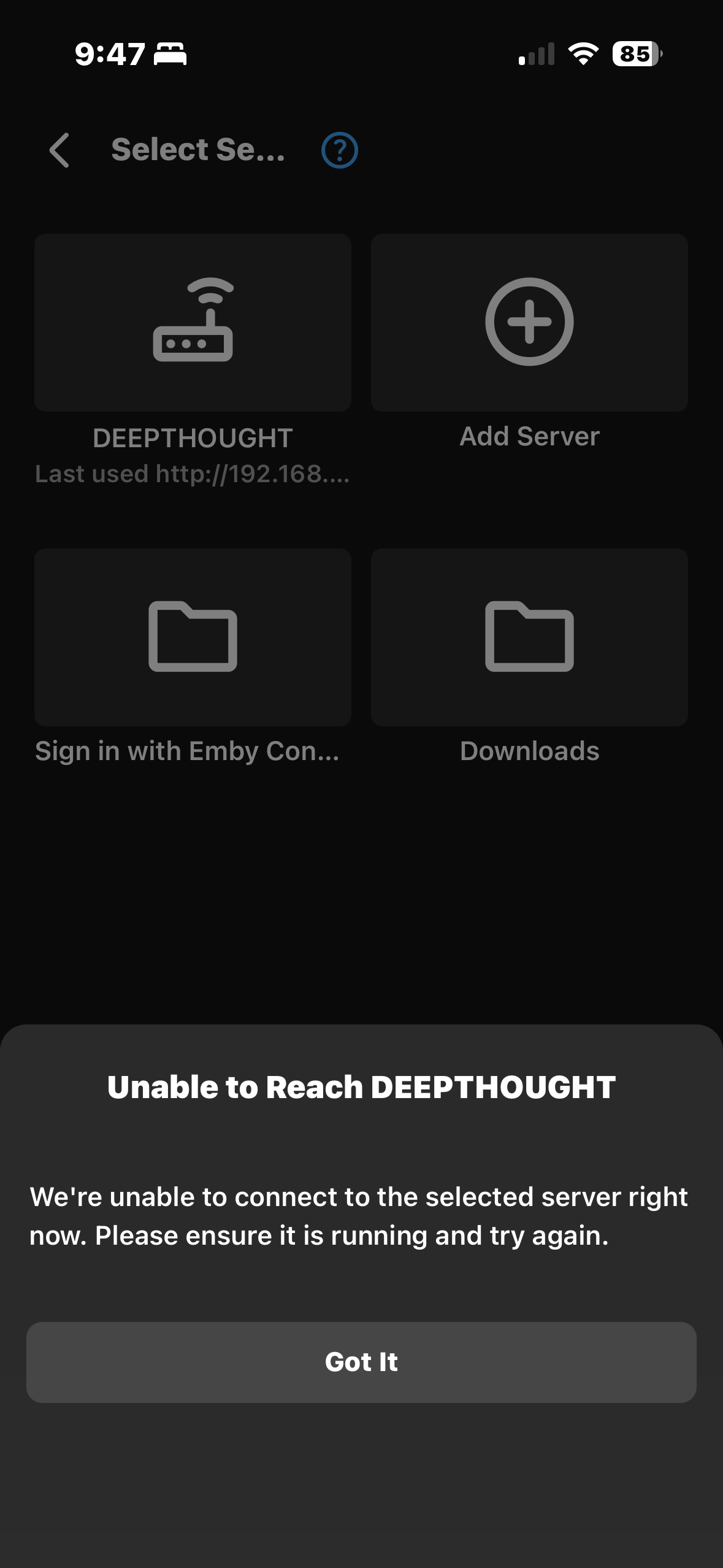

Tech127 20 Posted April 21, 2025 Posted April 21, 2025 (edited) Luke, if this is the wrong subcategory, I'm sorry. Feel free to move it What I'm trying to do is enable sleep on my Windows 11 Emby server. The WOL is what I'm having trouble with. I have FireTV devices local and away, and LibreElec running on my main entertainment center at home. WOL is enabled on the server and I have sent magic packets from my iphone using a WOL app and it will wake no problem, BUT if I open the Emby iphone app, it will not wake it. This is the initial test on the LAN where it's manually configured to the server IP and the default port. Nothing I have also tested from a firestick on the kitchen TV configured the same way as above and that won't wake it either. Part two is getting it to work if I'm on vacation with a firestick through the Cloudflare connection back to the server, but let's make it work locally first. Obviously I don't want it to sleep is something is playing on a client, but say 30 mins after I do. I assume I just set lets say 30 minute timeout in Windows and Emby will handle the keep awake until then? That's probably a question for later too, but there it is. Thanks! Edited April 21, 2025 by TechLife
Luke 42288 Posted April 21, 2025 Posted April 21, 2025 Hi, how did you try to wake the server using the Emby iphone app?
Tech127 20 Posted April 22, 2025 Author Posted April 22, 2025 All I did was open the app and let it try to connect to the server. After saying it was unavailable, I tapped it again for good measure.  I believe I read in the forum that it would automatically send a magic packet, but maybe I'm wrong?

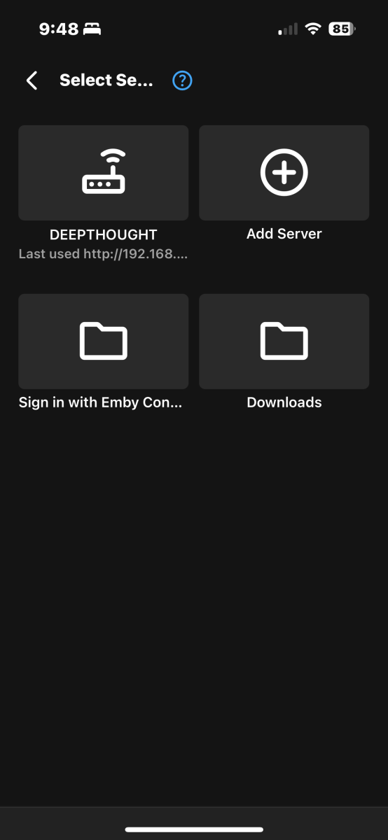

Luke 42288 Posted April 22, 2025 Posted April 22, 2025 Did you try using the WOL function on the server selection screen?
Luke 42288 Posted April 22, 2025 Posted April 22, 2025 Have you explored the long press context menu for a server?
Tech127 20 Posted April 22, 2025 Author Posted April 22, 2025 Didn’t know that was there, Luke. That worked. Thanks! Now, what do I do about the FireTVs?
