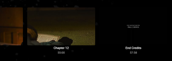

rbjtech 5344 Posted February 22, 2023 Posted February 22, 2023 (edited) 3 hours ago, CBers said: In the ATV app, you only get the next episode's synopsis if you press UP before the countdown ends. I believe #59 is using the CreditMarker's which currently only the Introskip Plugin creates/writes or manually created in the ChapterAPI Plugin. The AndroidTV client looks for this and brings the 'Next Episode' option up at exactly the time the credits roll for that episode, rather than the fixed 30 (or could be 40..) second from the end duration. So in the example above - it brings up the 'Play next Epsiode' dialogue/options at exactly 57:58 Edited February 22, 2023 by rbjtech
neik 874 Posted February 22, 2023 Author Posted February 22, 2023 9 hours ago, MBSki said: I'm interested to hear your experience, but I'm only seeing the 2 buttons and no episode info. There's just a big blank space under the buttons. ET is not picking up the Credit markers created by the Introskip plugin yet, ATV on the other hand is doing that just fine. A gap that needs to be closed IMO. What I noticed going back to ATV to test this: The more I use the ET app the more I like it also visually. It "just" needs some further love from the devs to replace the old one and free up some dev time hopefully due to avoiding maintaining two apps. 1

neik 874 Posted April 27, 2025 Author Posted April 27, 2025 Basically what this topic is about: ET for Android picking up end credit markers like Emby for AndroidTV is. Not sure if something happened there as I've using old ATV app for last month or so...
Solution Luke 42244 Posted April 27, 2025 Solution Posted April 27, 2025 Quote ET for Android picking up end credit markers like Emby for AndroidTV is. This was added a long time ago. 1
