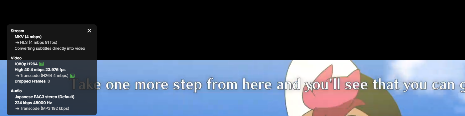

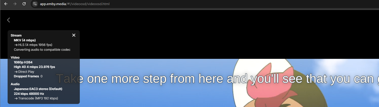

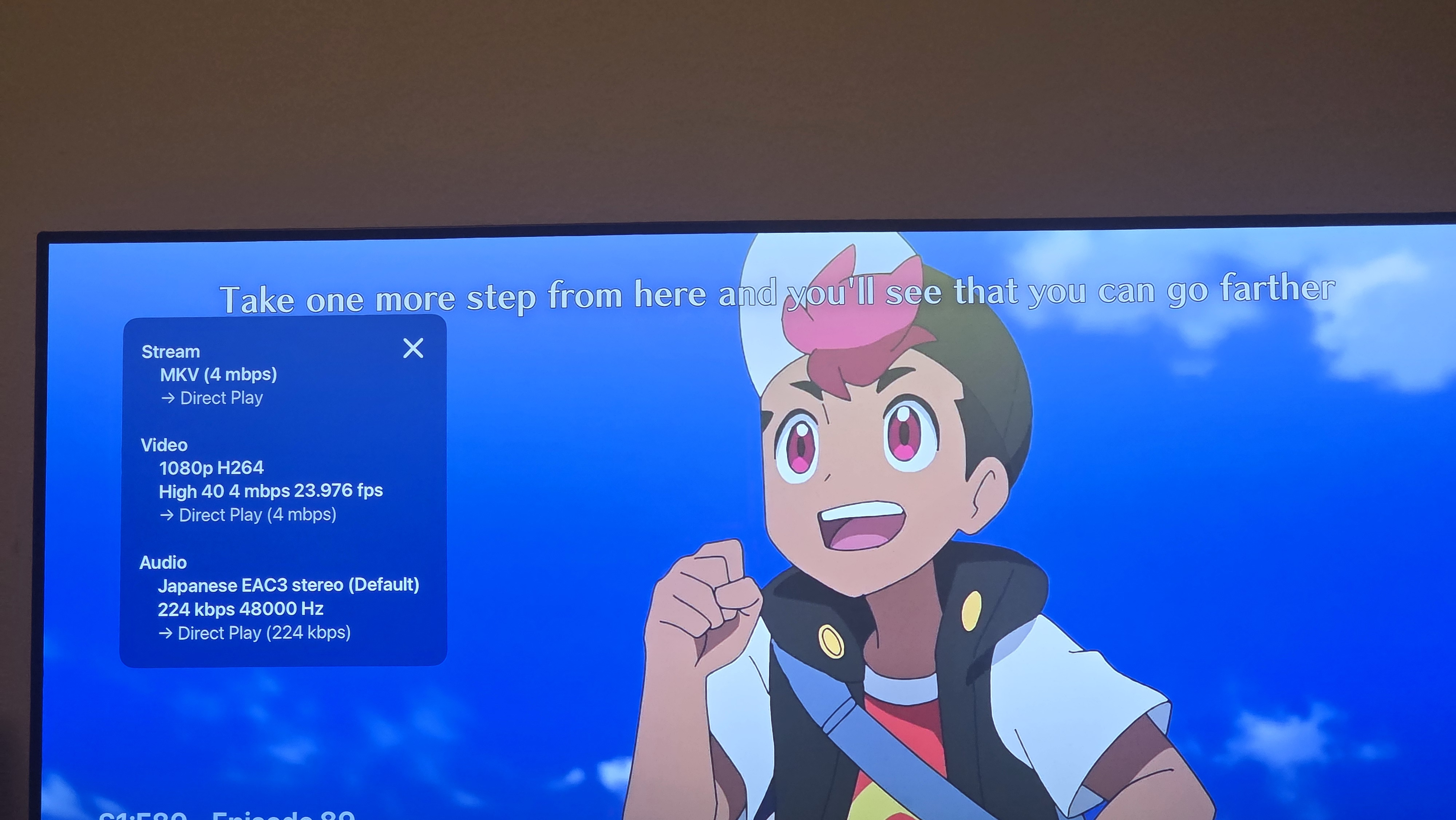

drapacioli 8 Posted April 20, 2025 Posted April 20, 2025 (edited) Hi, don't know where to start with this but long story short I tried updating my emby server instance tonight because I was getting oversized subtitles on some videos with formatted subs on the web player (.SSA/.ASS format, subs were larger than they were supposed to be according to the person responsible for formatting them, and were cutting off the screen). I had to update several times because I guess it had a lot to update since last time I did this, but after it was done, instead of fixing the subtitles, they disappeared completely during playback. Apparently, the only way to get them to show properly is to force transcoding by disabling subtitle extraction on the fly, but I'm trying to avoid using transcoding due to the fact this is running on a server with a few other time-sensitive processes that need the CPU to be available. But it gets weirder. If I access the server via the app.emby.media domain instead of directly via IP or through my own DDNS domain, the subtitles *do* work, and they're the correct size, but some of the formatting is dropped. So now I have three different ways I access the same file, and get three different results... What's going on here? Did I break something on my local instance by trying to update the server? If I check the console while trying to play back a video with these formatted subtitles, I see a few errors related to subtitles: Playback on app.emby.media domain - subtitles are missing formatting for the record: Same video file on direct IP (address bar not included for privacy), subtitles are missing, same encoding stats: Direct IP with subtitle extraction disabled, note formatting is different as well for some reason - probably correctly formatting it as part of the transcoding process?: I did try on my Apple TV as well, it seems to be fine which to me seems to suggest it's a problem specifically with the web player: Edited April 20, 2025 by drapacioli Added screenshots

Luke 42290 Posted April 20, 2025 Posted April 20, 2025 OK currently what happens with the web app when direct playing is custom fonts from .ass subtitles are not supported, so that's why you're seeing a generic font there. This has been added on the 4.9 beta channel though.
drapacioli 8 Posted April 20, 2025 Author Posted April 20, 2025 (edited) 12 minutes ago, Luke said: OK currently what happens with the web app when direct playing is custom fonts from .ass subtitles are not supported, so that's why you're seeing a generic font there. This has been added on the 4.9 beta channel though. That makes sense. Still kind of weird how it behaved differently between domains though. I'll give the beta a try, thanks. Edited April 20, 2025 by drapacioli

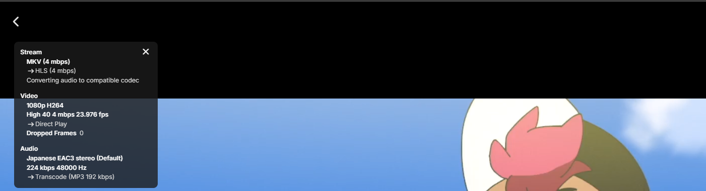

drapacioli 8 Posted April 20, 2025 Author Posted April 20, 2025 (edited) Hmm, beta has created a new issue. Now whenever I try to play on either my own domain/IP or on the app.emby.media domain, I get this error with *any* file I attempt to play back, subtitles or not: Console: Despite the error, Emby does not seem to log anything in the server .txt log, nor does it attempt to create a log file for playback. Should I just try a clean install at this point? Edited April 20, 2025 by drapacioli
Luke 42290 Posted April 20, 2025 Posted April 20, 2025 HI, yes I just realized that myself. It's an issue in the newest build. It will be resolved in the next build. Probably get one up in the morning. Thanks. 1
drapacioli 8 Posted April 20, 2025 Author Posted April 20, 2025 (edited) 2 minutes ago, Luke said: HI, yes I just realized that myself. It's an issue in the newest build. It will be resolved in the next build. Probably get one up in the morning. Thanks. Yes, thank you for confirming. It seems to be transcoding in general that causes this error. In my case it appears to be every file because the audio generally gets transcoded to match a valid format for the web player, but a handful of files I tried just now were able to play with direct stream for all of audio, video, and subtitles. I'll check again on the next build when it's available, appreciate it! Edited April 20, 2025 by drapacioli 1
