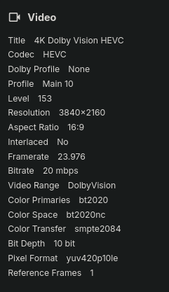

DePingus 2 Posted April 17, 2025 Posted April 17, 2025 (edited) Reporting a bug. The issue is that when I start a movie right after opening the app, the TV will switch modes from 120Hz SDR to 60Hz HDR. Then, if I back out of the movie and immediately start it again, the mode changes from 60Hz HDR to 24Hz HDR. The movie looks best at 24Hz (I guess because it matches the framerate) and the mode should probably be going from 120Hz SDR to 24Hz HDR the first time. My settings are at default, except I have to set ForceSystemDecoder on the Xbox app to get HDR to automatically turn on when I play a HDR movie. Here is my software and hardware: Emby Server 4.8.11.0 on Linux with Intel HD 630 Emby Xbox 2.222.70.0 on Xbox Series XS LG OLED 4K at 120Hz with VRR enabled Here are the steps to reproduce: Start Xbox. The console is at 120Hz SDR Open Emby on Xbox. The app stays at 120Hz SDR Direct Play a HDR movie, the mode changes to 60Hz HDR Back out of the movie. The mode stays at 60Hz HDR Play the same movie again. The mode changes to 24Hz HDR Back out of the movie. The mode stays at 24Hz HDR And here is a movie: Edited April 17, 2025 by DePingus typo
