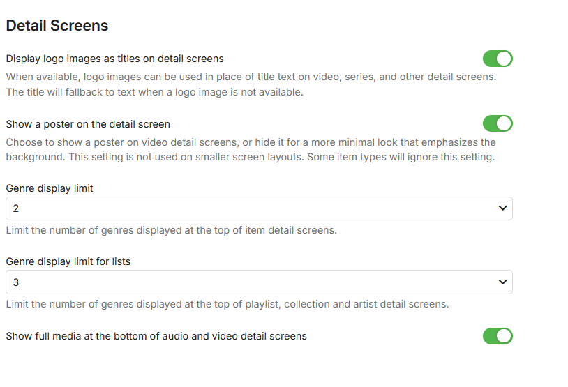

pwhodges 2132 Posted April 14, 2025 Posted April 14, 2025 (edited) What movies are you saying are also viewed as series? - knowing that would probably make discussion of your options easier. You can split versions apart again with the button at the top of the media info at the very bottom of the movie details screen. However, you have to enable the media info display for the button to be there (in your personal display options, at the very bottom). Paul Edited April 14, 2025 by pwhodges

kbeck 81 Posted April 15, 2025 Author Posted April 15, 2025 18 hours ago, pwhodges said: What movies are you saying are also viewed as series? - knowing that would probably make discussion of your options easier. You can split versions apart again with the button at the top of the media info at the very bottom of the movie details screen. However, you have to enable the media info display for the button to be there (in your personal display options, at the very bottom). Paul I think I see the option to enable (it already was) but see nothing to split in the details screen.

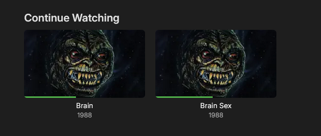

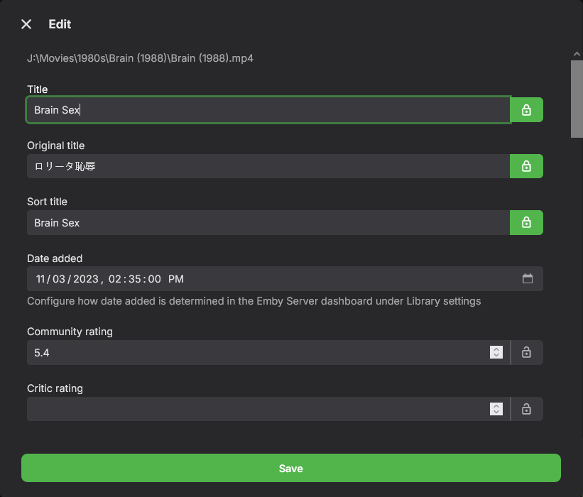

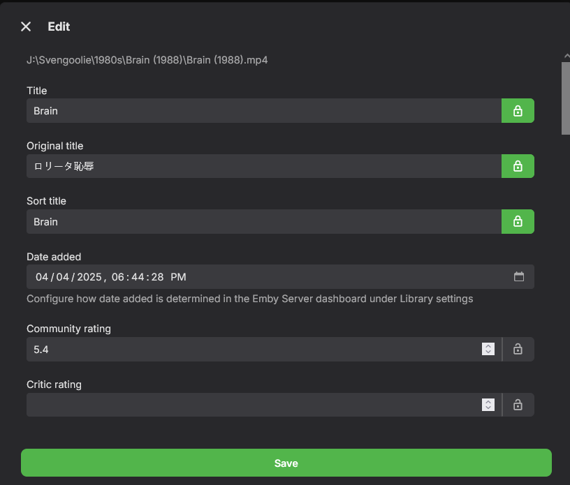

kbeck 81 Posted April 15, 2025 Author Posted April 15, 2025 I didn't think they were but in the Continue Watching it shows 2 movies with similar names. Metadata of both points to the same file but the name in the 2 metadatas are 2 different names. So I'm guessing there are 2 Metadata Entries??
Luke 43551 Posted April 15, 2025 Posted April 15, 2025 Quote Metadata of both points to the same file What do you mean by this? This appears to be two files that are not grouped together.
kbeck 81 Posted April 15, 2025 Author Posted April 15, 2025 I was partially wrong. It's 2 files in 2 different folders, with different metadata but why does playing one play both? I only opened 1 file.
bakes82 167 Posted April 15, 2025 Posted April 15, 2025 All systems do this because its two items in the database, plex does this, jelly, emby, you either merger them or you have 2 files on continue watching because they store tracking by the imdb/tvdb/tmdb etc and not unique file id since you could change the file but most people would still want it marked watched. 1
kbeck 81 Posted April 15, 2025 Author Posted April 15, 2025 I refreshed the metadata and now only shows 1 in Continue Watching. Have no idea what that 2nd display was all about. Let's pretend like it never happened.
Luke 43551 Posted April 15, 2025 Posted April 15, 2025 20 minutes ago, kbeck said: I refreshed the metadata and now only shows 1 in Continue Watching. Have no idea what that 2nd display was all about. Let's pretend like it never happened. Something in the metadata changed sufficiently enough such that the two are not using the same user data anymore. 1
