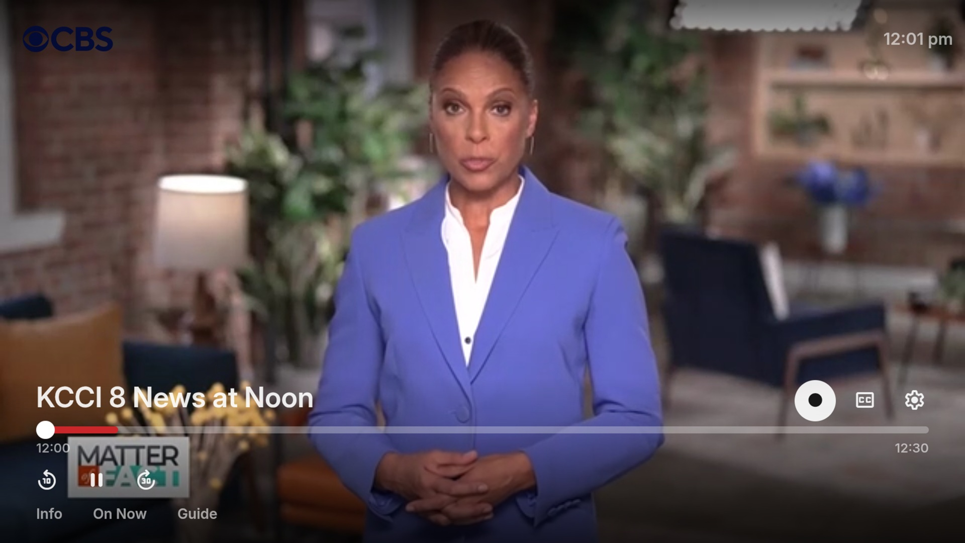

myoldvcr 21 Posted April 17, 2025 Author Posted April 17, 2025 Here is a more detailed explanation of the issue I am seeing with live IPTV using the Android app on my NVShield. First I created an M3U tuner using this link from Github https://iptv-org.github.io/iptv/subdivisions/us-ia.m3u Then I played a channel using the Android app without mapping the channel to any guide. The timeline indicator progressed normally and I could rewind without any issue. Next I mapped the channel using the appropriate source and channel data from the Emby guide. After mapping the channel I played the channel. The time line buffer progressed but the timeline indicator was stuck at the beginning. When I tried to rewind or skip ahead the stream immediately froze. Hopefully the logs will give some clues. Screen grab from the NVShield. ffmpeg-transcode-92d8bf64-cfba-44de-91ff-01879d8278d0_1.zip

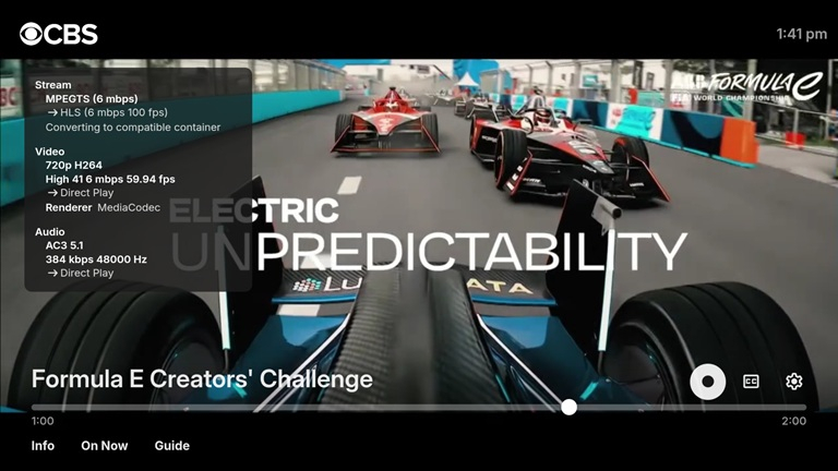

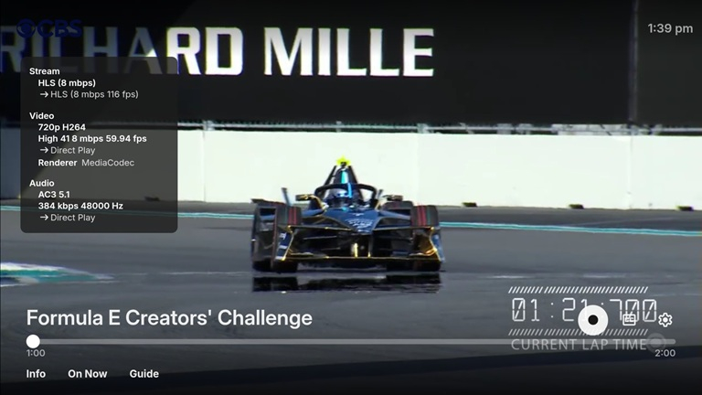

myoldvcr 21 Posted August 9, 2025 Author Posted August 9, 2025 On 7/27/2025 at 6:10 PM, Luke said: Hi, we’ll take a look at that. Thanks. I have some more observations with this issue. The first pic shows a channel from an Emby M3U tuner source directly from my Tablo Dual tuner. The second pic shows the same channel from my Tablo dual tuner except it was exported from NextPVR as an M3U, then imported into Emby. In both pics "Force Conversion for Formats MPEGTS" is enabled. Timeline indicator is stuck at the beginning. "Stats for nerds" indicates the stream is already HLS and does not need to be converted. When using my "nextpvr workaround" mentioned earlier "Stats for nerds" shows that the M3U source stream is MPEGTS and Emby converts it to HLS. Notice the timeline marker is correct now. Hope this helps. embyserver.txt
Luke 42241 Posted August 9, 2025 Posted August 9, 2025 3 hours ago, myoldvcr said: I have some more observations with this issue. The first pic shows a channel from an Emby M3U tuner source directly from my Tablo Dual tuner. The second pic shows the same channel from my Tablo dual tuner except it was exported from NextPVR as an M3U, then imported into Emby. In both pics "Force Conversion for Formats MPEGTS" is enabled. Timeline indicator is stuck at the beginning. "Stats for nerds" indicates the stream is already HLS and does not need to be converted. When using my "nextpvr workaround" mentioned earlier "Stats for nerds" shows that the M3U source stream is MPEGTS and Emby converts it to HLS. Notice the timeline marker is correct now. Hope this helps. embyserver.txt 5.25 MB · 0 downloads Do the tablo HLS manifests not contain #EXT-X-PROGRAM-DATE-TIME: ? When it gets converted through emby server, the server will insert those values into the output hls.
myoldvcr 21 Posted August 9, 2025 Author Posted August 9, 2025 (edited) 46 minutes ago, Luke said: Do the tablo HLS manifests not contain #EXT-X-PROGRAM-DATE-TIME: ? When it gets converted through emby server, the server will insert those values into the output hls. I don't know about #EXT-X-PROGRAM-DATE-TIME from the Tablo. However all of my IPTV sources behave the same way so they must be missing that parameter as well. With NextPVR I create an "Extra" for the Tablo and iptv sources which uses ffmpeg to convert the stream to MPEGTS so maybe #EXT-X-PROGRAM-DATE-TIME: gets added somehow which makes the timeline work properly. Edited August 10, 2025 by myoldvcr
