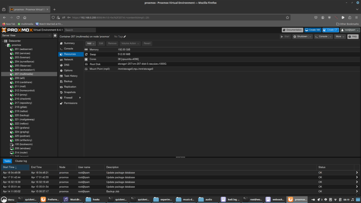

quickmic 1709 Posted April 18, 2025 Posted April 18, 2025 (edited) Yes, I run Emby in an LXC container on proxmox. There is no need to use docker and actually makes no sense to run a container in a container. Simply use the debian 12 standard container template and install Emby server amd64.deb from here: https://github.com/MediaBrowser/Emby.Releases/releases Stable or beta is up to you. If the media files are available on the host then mount the drive into the container and don't use smb or nfs. No need for this extra layer. root@proxmox:~# cat /etc/pve/lxc/207.conf arch: amd64 cores: 38 cpuunits: 4096 features: nesting=1 hostname: multimedia memory: 196608 mp0: /mnt/storage0,mp=/mnt/storage0 nameserver: 192.168.0.202 net0: name=eth0,bridge=vmbr0,gw=192.168.0.5,hwaddr=16:D3:29:2C:8B:97,ip=192.168.0.207/24,type=veth onboot: 1 ostype: debian rootfs: storage1:207/vm-207-disk-0.raw,size=1000G searchdomain: rms-systems.intranet swap: 512 root@proxmox:~# Important for performance, use an nvme/ssd as container store. Edited April 18, 2025 by quickmic
