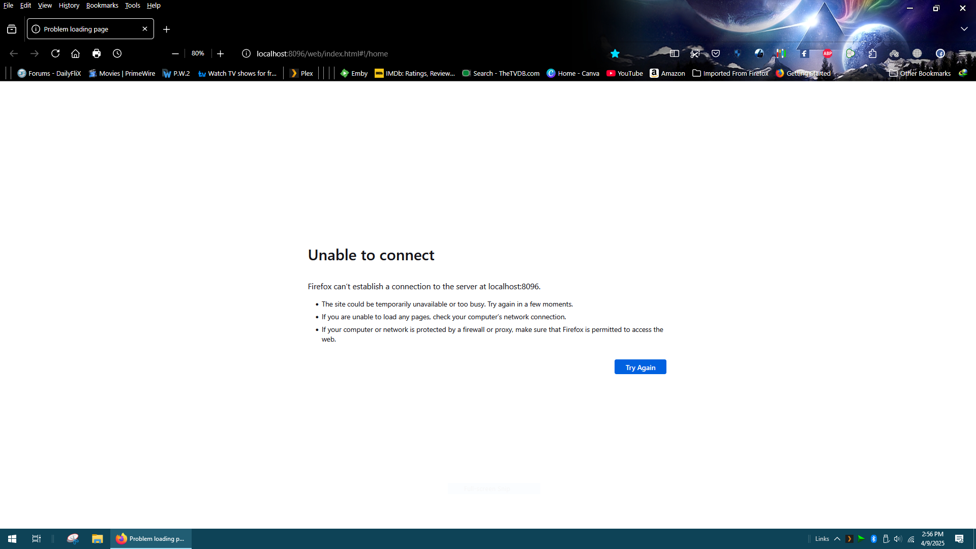

Trekdriver3 12 Posted April 9, 2025 Author Posted April 9, 2025 9 minutes ago, Luke said: OK, is your emby server running? Are you trying to connect remotely or inside your home network? Has your server's LAN or WAN ip address changed? Trying to connect from inside my home. Nothing has changed since yesterday. The screen shot I sent was my t.v. I cannot connect on any device. P.C. (win 10) Locol host 8096, None of my televisions, nor on my androif phone app. I have no idea if the server is running as I can't connect.
Luke 42176 Posted April 9, 2025 Posted April 9, 2025 Quote I have no idea if the server is running as I can't connect. If it is your server you really should know this. Is the server application running on the server machine? What did you install Emby Server on? Can you use the Emby web interface that you used to setup the server?
Trekdriver3 12 Posted April 9, 2025 Author Posted April 9, 2025 2 minutes ago, Trekdriver3 said: Trying to connect from inside my home. Nothing has changed since yesterday. The screen shot I sent was my t.v. I cannot connect on any device. P.C. (win 10) Locol host 8096, None of my televisions, nor on my android phone app. I have no idea if the server is running as I can't connect. Screenshot of my p.c.
Solution Luke 42176 Posted April 9, 2025 Solution Posted April 9, 2025 OK so the server probably isn't running .did you try starting up the server application from the windows start menu?
