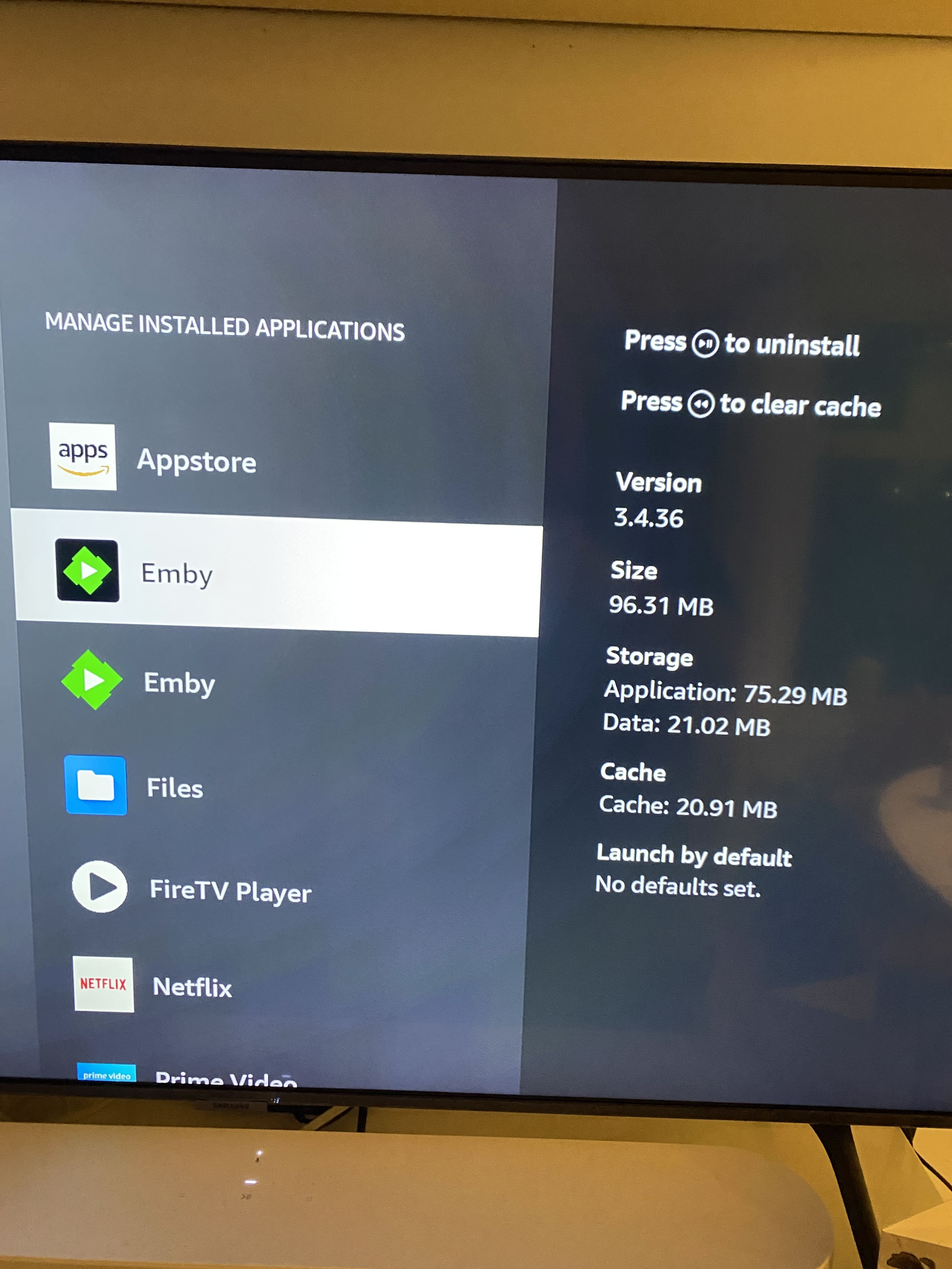

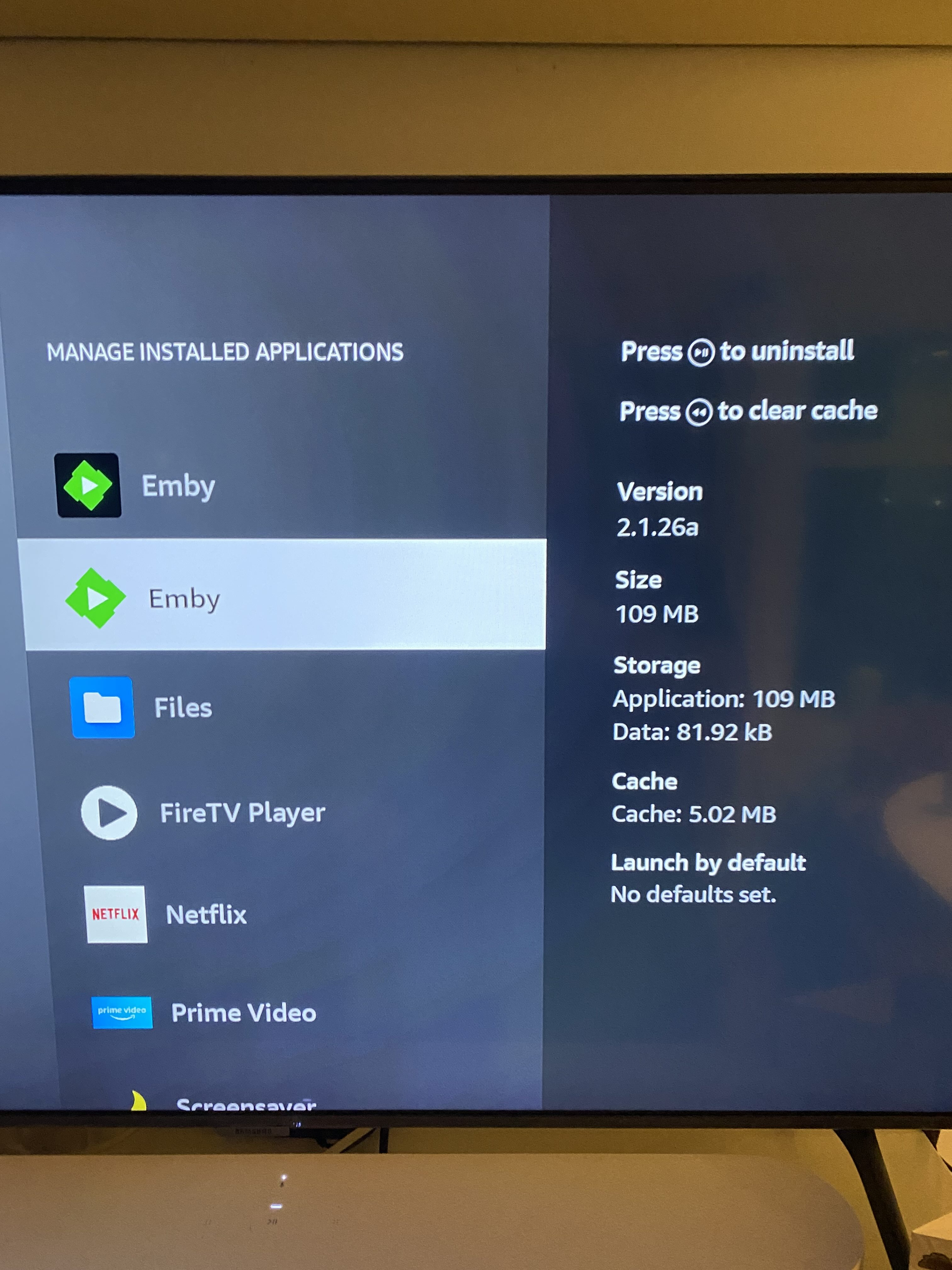

What I have noticed is that the Emby Fire TV app version 2.1.26a works and version 3.4.36 does not. I have no idea how I ended up with both versions on the Fire Stick at the same time. Perhaps the earlier version was restored from a backup during the setup while the later version was installed from the Amazon appstore. I know that during setup I saw the restore process occur automatically and I also know I manually installed the Emby app from the appstore manually.

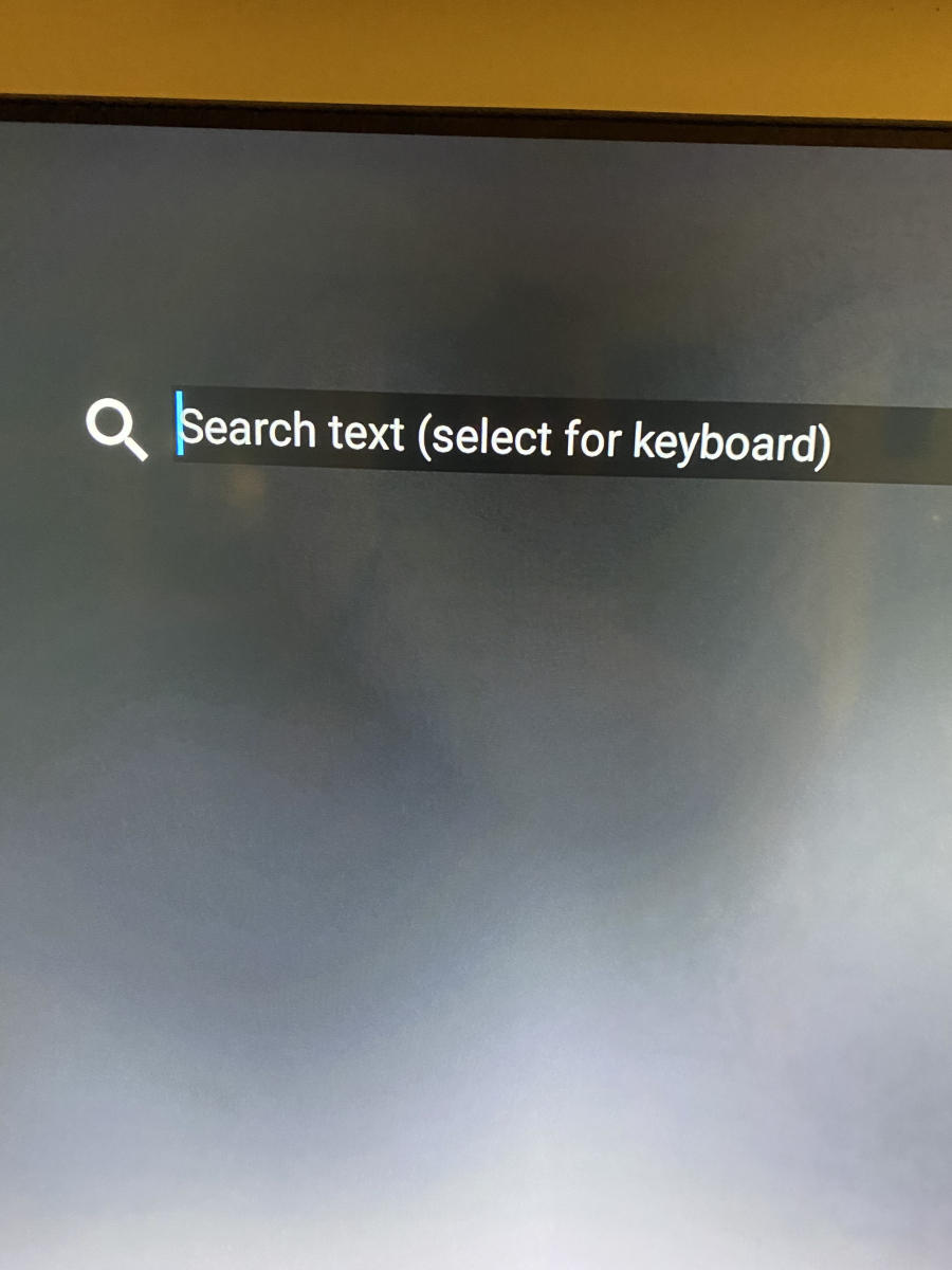

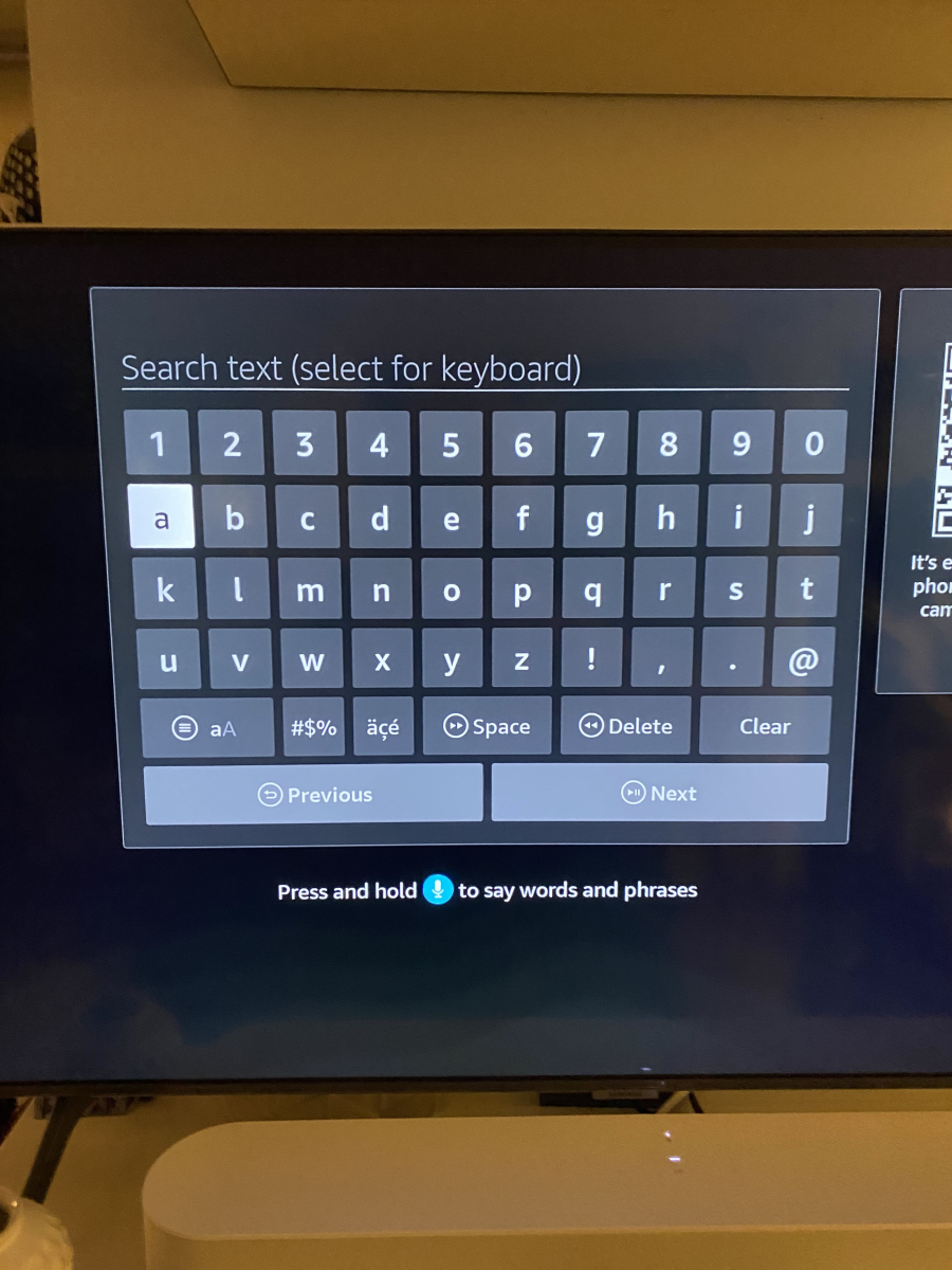

In order to get the feature to "work" you must click on the search (magnifying glass) icon from either the pop-out sidebar or from the top right of the main/home screen. You then must move the cursor to inside the text input area and press the select button which will cause a non-qwerty virtual keyboard to appear. At this point you can use the mic (Alexa) button to do the speech-to-text entry. An example would be to search for CNN by saying "sea n n" while holding the mic button. The text box will show "CNN" and only content within the Emby app will show in the search results.

Version 3.4.36

Version 2.1.26a
This "working" version allows you to place the cursor in the text box (note the "select for keyboard")
Once you hit the select button this virtual keyboard appears and the mic button is able to be used (note the "Press and hold to say words and phrases" below the keyboard)
