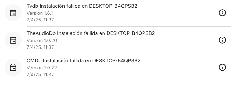

MwxicanJoker 0 Posted April 7, 2025 Posted April 7, 2025 From aproximately 3 weeks ago, I´m getting this messages of "failed instalation", I´ve restarted the server several times, even shuting down and turnign on again the emby service but it seems to do nothing. what does that mean?? what do i need to do to solve it? the error message details show this: " Tvdb Instalación fallida en DESKTOP-B4QPSB2 7/4/25, 11:37 Cancelling connection to https://embydata.com/admin/service/packageFiles/Tvdb.dll_1.6.1.exe due to a previous timeout. "

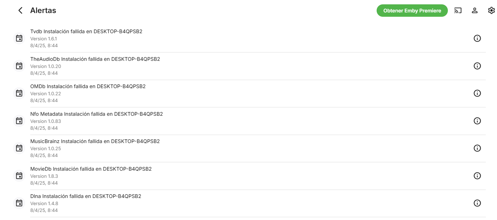

MwxicanJoker 0 Posted April 8, 2025 Author Posted April 8, 2025 11 hours ago, Luke said: Hi there, please attach the Emby server log from when the problem occurred: How to Report a Problem Thanks! Here is the most recent server log, checking the alerts on the server I see more instances failing to install, as shown on this screenshot. Also if I click the links shown on the alert message it tries to download a file wich microsoft smartscreen flags as dangerous and wont let it install. embyserver.txt

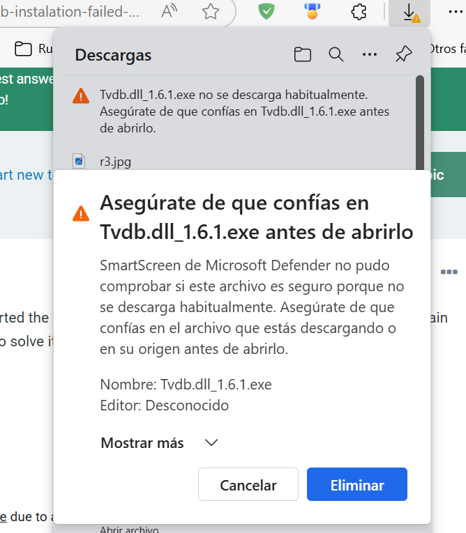

MwxicanJoker 0 Posted April 8, 2025 Author Posted April 8, 2025 16 hours ago, Happy2Play said: Yes would need to see server log but would suggest a issue communicating with with embydata server for the update. Are you able to click that link and download the plugin? I just uploaded the server log, I´ve tried to click on the link shown on the alerts but microsoft block the download, if i force the file dounload it says that it cant be installed on my system ( W10 pro x64)
MwxicanJoker 0 Posted April 8, 2025 Author Posted April 8, 2025 16 minutes ago, MwxicanJoker said: Here is the most recent server log, checking the alerts on the server I see more instances failing to install, as shown on this screenshot. Also if I click the links shown on the alert message it tries to download a file wich microsoft smartscreen flags as dangerous and wont let it install. embyserver.txt 80.05 kB · 0 downloads I forgot to add this screenshot
Luke 42176 Posted April 8, 2025 Posted April 8, 2025 Hi, your connections to embydata.com are timing out and failing. Do you have something that could be blocking this? Are you using a vpn?

Happy2Play 9798 Posted April 8, 2025 Posted April 8, 2025 3 hours ago, MwxicanJoker said: microsoft smartscreen flags as dangerous and wont let it install. Will guess something flaky with smartscreen and will require manual intervention. But may need to see the exact message.

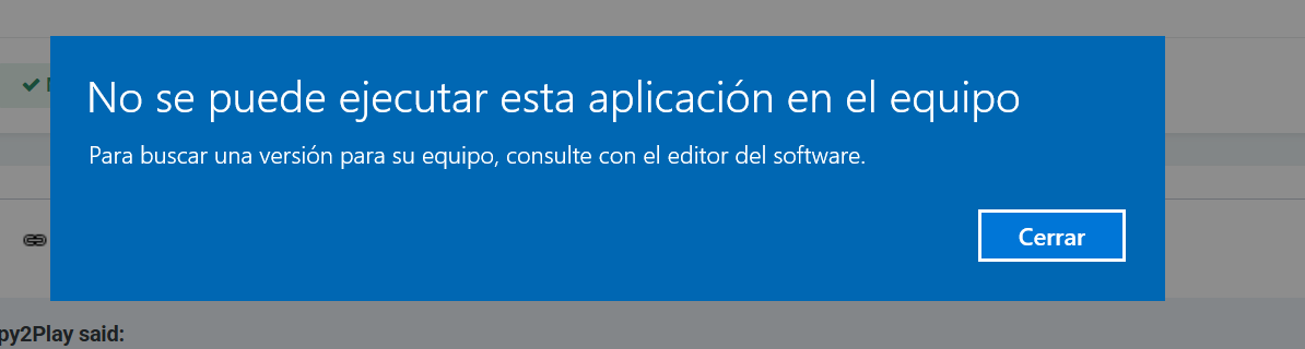

MwxicanJoker 0 Posted April 8, 2025 Author Posted April 8, 2025 3 minutes ago, Happy2Play said: Will guess something flaky with smartscreen and will require manual intervention. But may need to see the exact message. It says: "Microsoft defender smartscreen couldn't verify if this is a safe file because it is not downloaded regularly, make sure you trust the file and its origin before opening it" which is a normal message for unknown developers files, you select the option to "keep it anyways", and when runing it, the other message says. " this program con not run in this system to find a version for your system please contact the software developer" right now I'm thinking that the best solution is to uninstall emby service, clean registry and perform a fresh install. I´ve been running this server from several months to this day and hadnt have those kind f error messages
Luke 42176 Posted April 8, 2025 Posted April 8, 2025 Quote " this program con not run in this system to find a version for your system please contact the software developer" This is normal. Even though the downloaded extension is exe, it is not meant to be a runnable program. The server just unpacks the plugin from within it.
