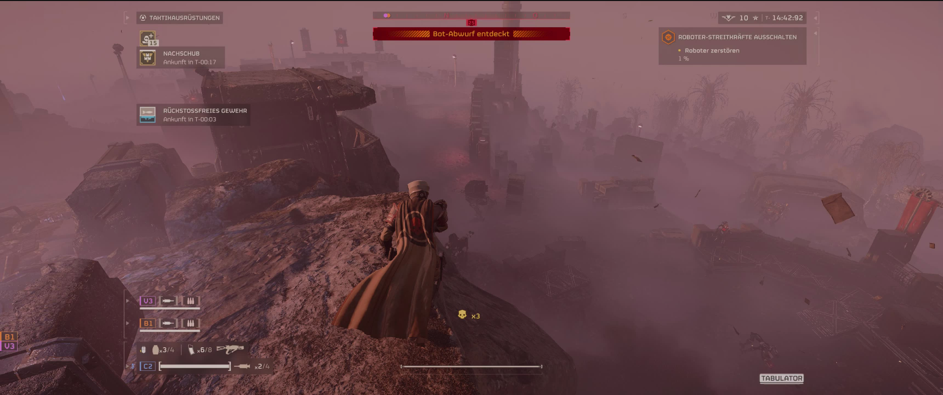

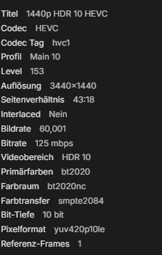

Is it possible to generate preview images of HDR content with correct tone mapping?
I'm currently working with HDR video recordings (in this case, gameplay footage captured in HDR), and I'm noticing that the generated preview thumbnails don't reflect the proper tone-mapped look—they appear either washed out or incorrectly exposed.
I've attached example screenshots showing the difference between the preview image and the actual video playback.
This issue doesn’t seem limited to just game captures—I've seen similar problems with other HDR sources as well.
For reference, my system is capable of hardware tone mapping (RTX 3070).
Is there a way to ensure that previews are generated with the correct tone mapping applied?

From memory, the preview images use a 'quick' version of tonemapping to speed up the process as it's very intensive when properly tonemapping every image.   It used to use some type of gamma/colour correction that was even quicker (but looked poor), but tonemapping was added and tbh, I've been ok with the result.
Prior to this, I added tonemapping to the bif creation myself via a script - to note, the MediaInfo plugin also has that same ffmpeg code/syntax under the BIF Generator tab.  That does the full tonemapping which may produce better results - but test first as I haven't looked at that code in a long time since it got updated in the Core.
Adding @softworkzwho added it - he may be able to provide further info.
btw - it's also worth added the generated preview log file - as that will show the ffmpeg syntax used.   It may simply be that the tonemapping algorithm default (hable) does not work well with the game graphics output, but others are available.  (the plugin allowed you to change it)

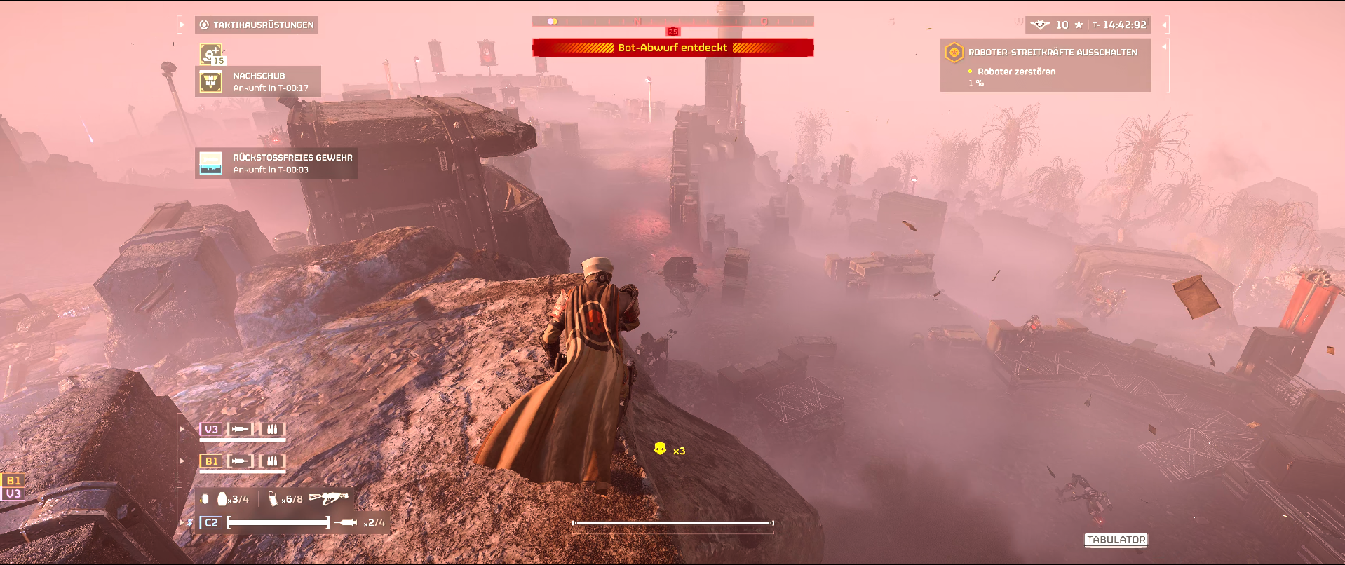

Alright, issue resolved.
Turns out the problem was caused by the tone mapping algorithm selected in the transcoding settings
I switched it from Hable to Mobius (both for software and CUDA), and just like that — problem gone
From what I’ve read, Mobius is slightly slower than Hable, but with an RTX 3070, performance isn’t an issue at all
(This  is the new thumbnail)
