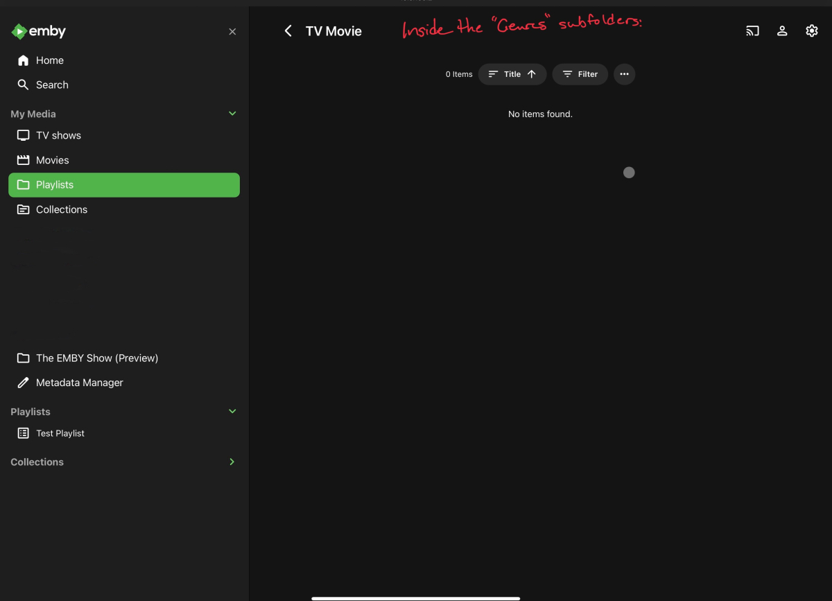

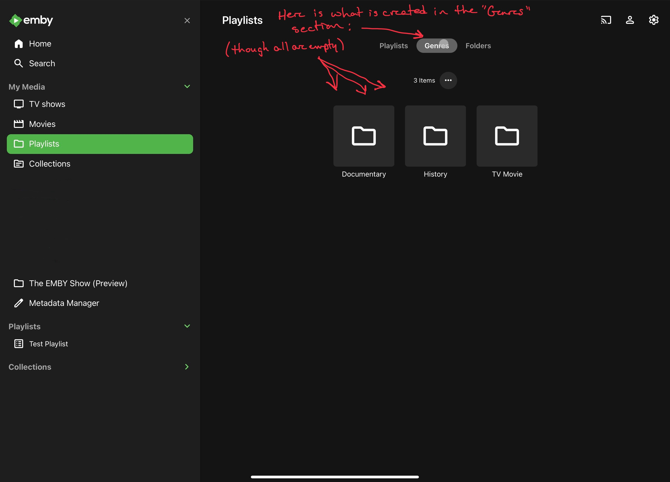

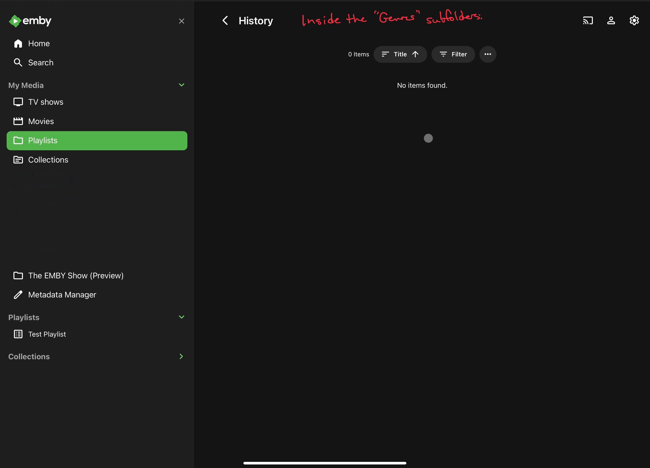

piecesofme 3 Posted April 6, 2025 Author Posted April 6, 2025 (edited) Hey Luke, thanks so much for responding. Sure, happy to give you some specific examples.. Here is a link with several screenshots: https://imgpile.com/p/imfaBiy When I click on the “Playlist” link on the left of the web interface, I have three sections at the top/center: Playlist, Genre, Folders. Playlists is where the playlists that I manually create end up. Then there’s Genres which shows several genre folders, and then Folders, which shows several show folders. I’ve included screenshots that show into two of the Genre folders and two of the Folder folders. All of those are empty. I can’t tell where they are pulling from to get the empty Genre or Folder playlist folders. FWIW, I have these same three sections also come up on AppleTV and other Emby interfaces. Edited April 6, 2025 by piecesofme Add’l info.

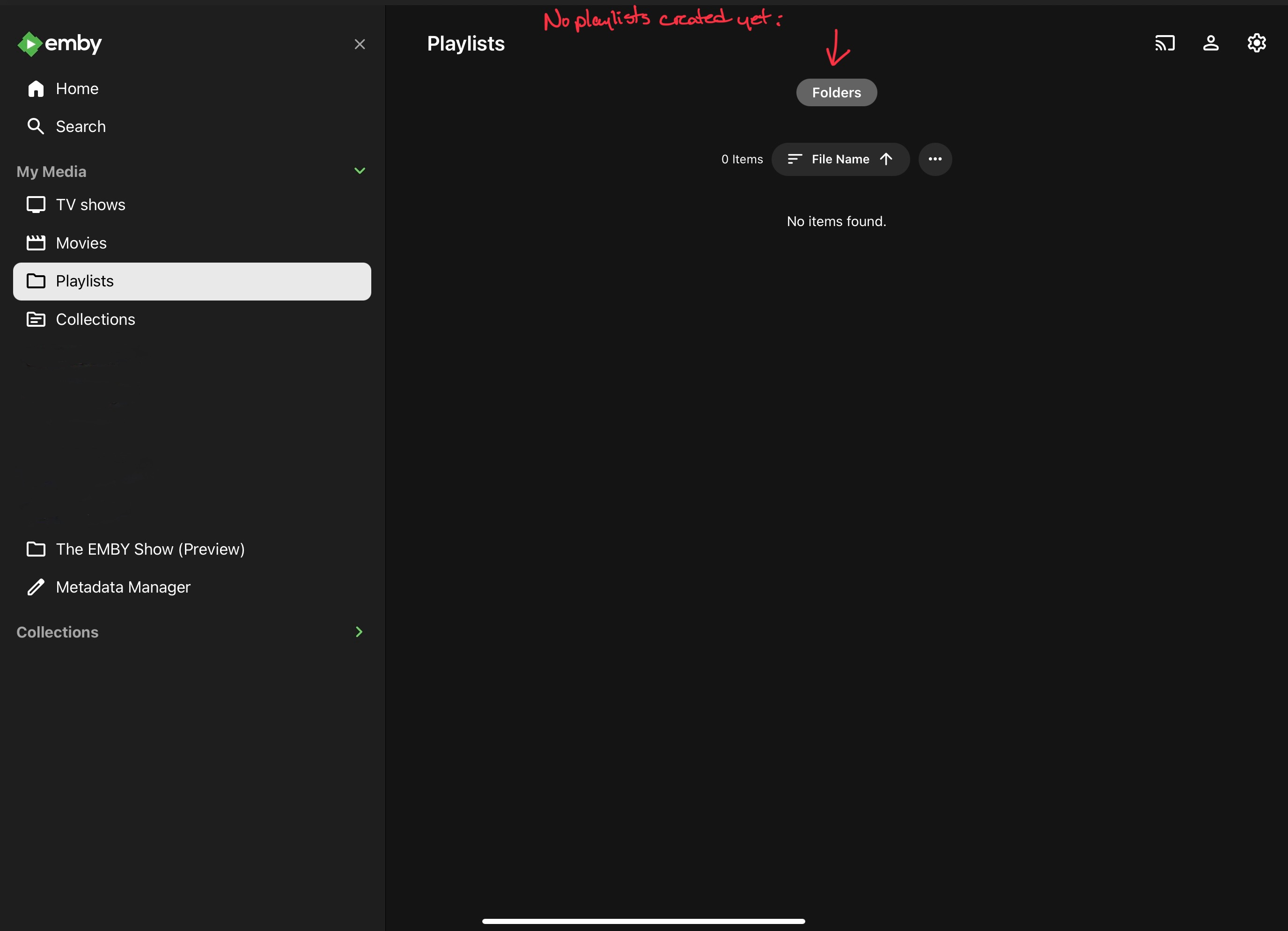

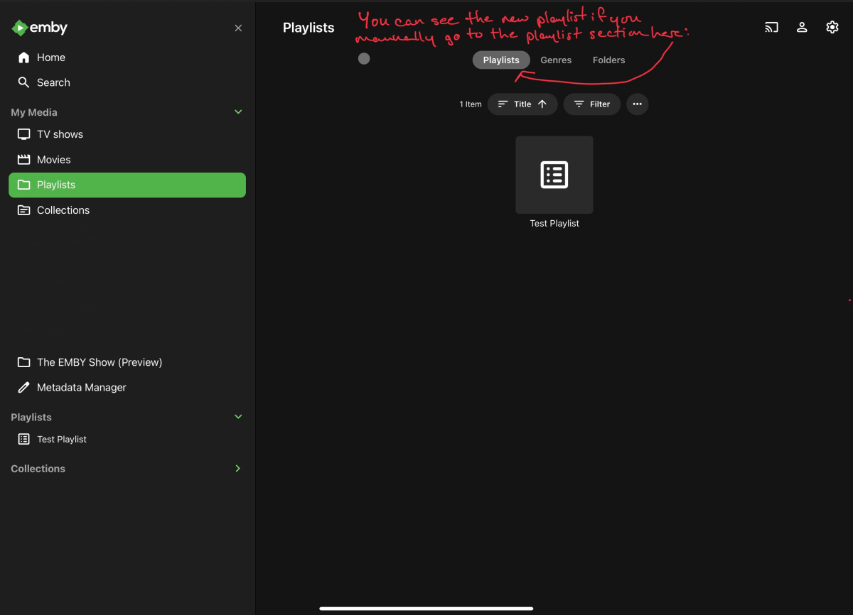

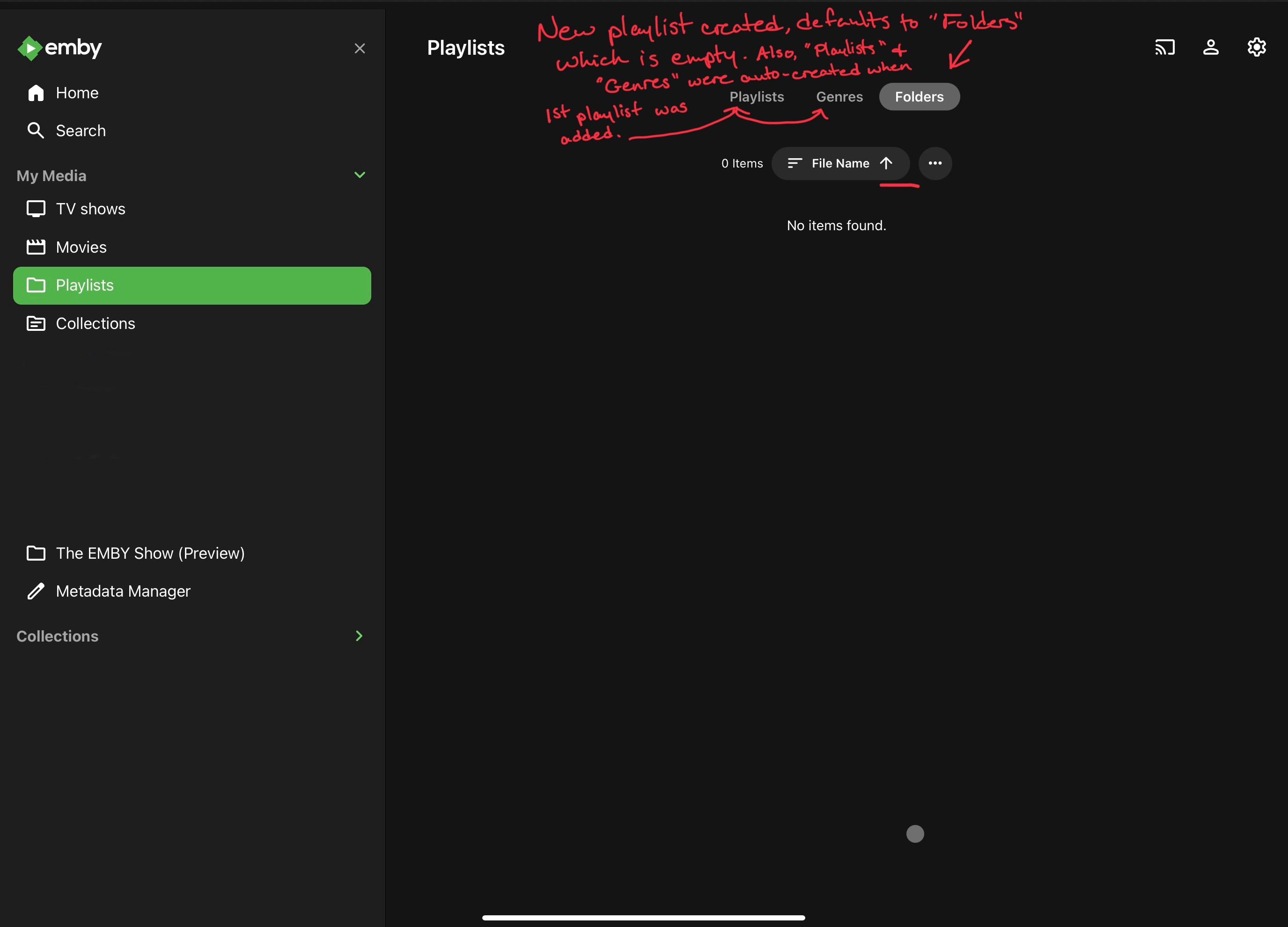

piecesofme 3 Posted July 23, 2025 Author Posted July 23, 2025 Hey @Luke, thanks so much for your response. I’m really sorry I missed it awhile back. Looking to move back over to Emby entirely but need playlists feature working correctly. I’m still having issues with video playlists acting strange. In answer to your question, this is definitely not a library I created and then called Playlists. This is the navigation section where video playlists appear once they are created. I’ve created & deleted all my playlists numerous times now trying to troubleshot. Here’s what I’ve found: -Before I add any playlist, one section shows up in the “Playlists” area titled: “Folders”. When I click on that, it’s empty. -When I add a new playlist, two additional (new) sections/categories suddenly appear at the top of the playlists section next to the above mentioned “Folders”: “Genres” and “Playlists”. -Not sure what/why those genre folders appear (or why those genres specifically) but when I click into those Genre folders, each one is empty. -The “Folders” section also remains empty. -What makes this even more confusing (especially for non-tech inclined family members) is that when I navigate to & click on the “Playlist” category, the category will default the “Folder” section which shows up as empty, making it appear to the user that no playlists exist - even though they do. It’s not clear that one needs to navigate over to the “Playlist” section at the top of the “Playlists” category to actually view any playlists. -This may be a new feature but all the individual playlists that are created also show up in the sidebar, at least on the web app. Don’t know if that’s expected behavior for video playlists. I’ve included additional screenshots to try to better illustrate what’s going on. Please let me know if you need more info and I’ll try to supply it. Since this seems to continue happening after a lot of testing, I’m giving some thought to doing a clean install to see if that would help - though I’m completely open to other advice/ideas. I’m running Emby on MacOS. I don’t might redoing some light setup but I really don’t want to lose all my additional metadata (Emby is setup to use nfo files & save images to the folder so that part should be OK but then there are additional things like custom collections, genres, etc that I don’t want to have to redo from scratch & don’t know where that data lives, so to speak). I also don’t know if one loses the benefits of a clean install if we simply upload a backup from the problematic Emby install to the new Emby install, since one doesn’t know if the data contained in the backup is what’s causing the issues in the first place. Any assistance would be hugely appreciated. Thanks in advance!
Luke 42237 Posted July 27, 2025 Posted July 27, 2025 Hi, was this a really old install that you upgraded when you came back to Emby? It looks like the playlists library might have lost it's content type. If you're just coming back now you might want to consider a fresh start.
piecesofme 3 Posted July 28, 2025 Author Posted July 28, 2025 Hi @Luke, thanks so much for getting back to me. No, I can’t say that it was a really old install…at least not one that I had jumped back into. I have been keeping Emby updated with almost every step upgrade over the past few years just not been using it as our primary interface. Having said that, when I couldn’t find any other info to help troubleshoot, and with your earlier response that those other sections shouldn’t be showing up at the top, I opted to try a clean install. I did a lot of cleanup work in the new install and then backed that up. I then attempted to use the previous backup data so I wouldn’t lose all of that but the issue above with the playlists instantly came back. Fortunately, since I had the clean install backed up, I was able to revert to that. I do still have some other things that I’m trying to figure out so I can move back over to Emby for good. But I’ll make separate posts for those. Thanks for confirming the clean install was the right way to go. Sometimes, it’s not worth going down the rabbit hole for something like this that one may not be able to fix without a clean start anyway. 1
