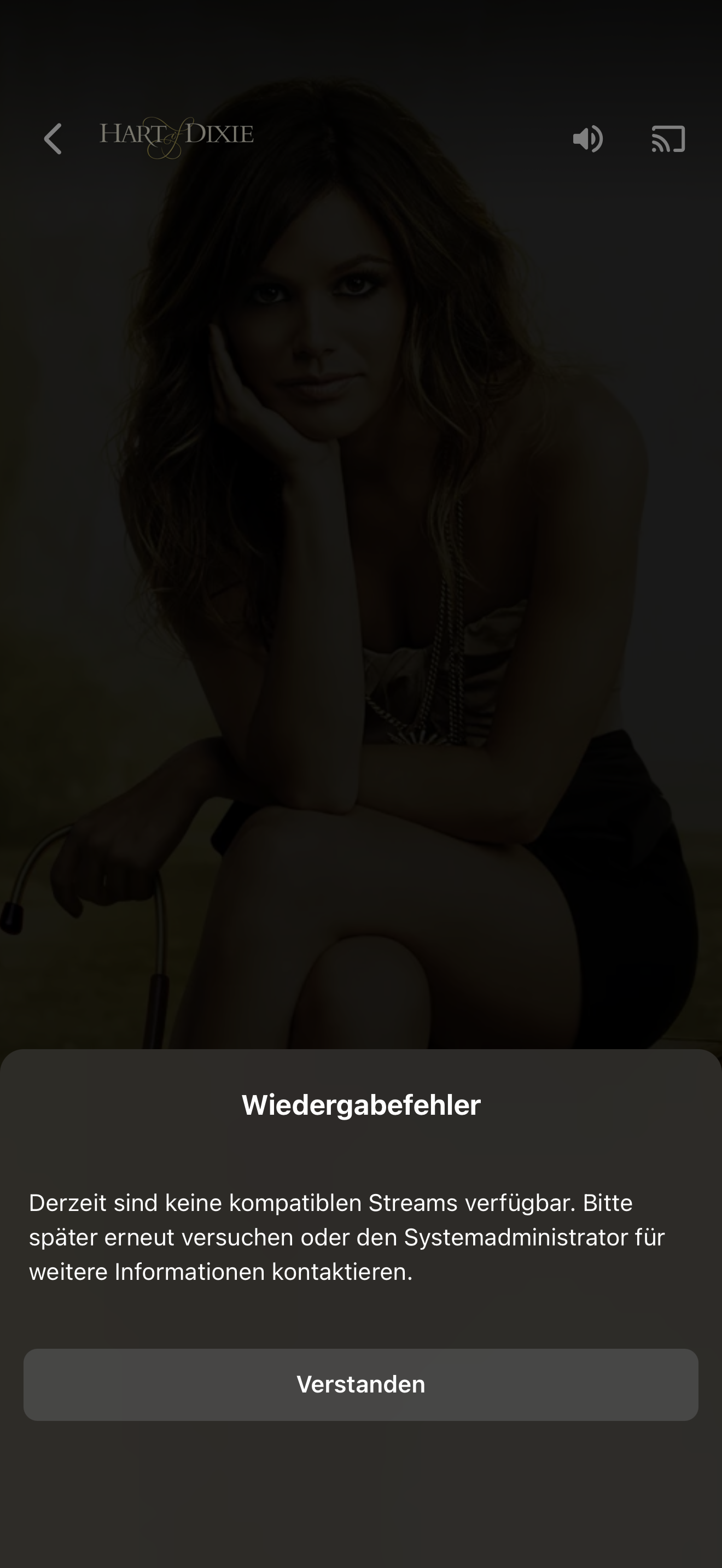

wsxws 8 Posted April 6, 2025 Author Posted April 6, 2025 (edited) server.log attached. first media start with normal log, secnd with debug enabled also find eclosed the error-message from the iphone, but it just says the topic in german words this error occours on all HEVC files ive got. on android they run fine (mobile phone, tablet, shieldTV) accessing emby via browser works fine on iphone too. its just the IOS-app (2.2.37) not working here. embyserver (2).txt Edited April 6, 2025 by wsxws 1
mKenfenheuer 0 Posted May 5, 2025 Posted May 5, 2025 Hi all, same problem here. Tried to reinstall the app, logged in locally and not via domain, forced transcoding by setting the max quality to 1080p- 5mbps in app settings. Nothing works, same error as above "No compatible streams found." The same files play via webbrowser just fine. Other files like Castle or Too Fast and Too Furious 2 also play fine on the app but Vaiana does not for example. ffmpeg-transcode-5dd898b7-20ff-45fa-88df-e1b3f45e482f_1.txt ffmpeg-transcode-1539dbdd-dfe8-4775-9df2-d17481a2cda8_1.txt embyserver-63882016971.txt hardware_detection-63882016976.txt ffmpeg-transcode-88877dbf-cb94-4205-b734-edc248584007_1.txt ffmpeg-transcode-3777c99c-0667-4721-931b-d3dc3aaee1fd_1.txt ffmpeg-transcode-6d43872a-91ec-4514-ad21-d9e1e7d3dab4_1.txt embyserver-63882018294.txt embyserver-63882018267(1).txt embyserver-63882018498.txt
