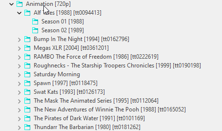

How are your files named and organized?
See  attatched.
Sorry for the delay, I used  to have a really good app for spitting out folder/file layouts, but I cant remember what it was. I was trying to find it quick >.> (this isnt it).
Lighthammer
Animation [720p] would be the root folder mapped in the TV Series Library.
Likewise, things like Animation [1080p], Live Action [720p] and Live Action [1080p] would also be mapped as the top folder in the TV Series Library.

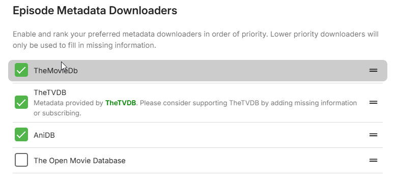

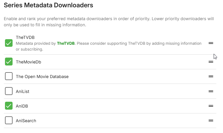

Additionally, what metadata fetchers are enabled on the library, and in what order?
I thought I mentioned this.
#1.) IMDB
#2.) TMDB
#3.) TVDB
I generally have  AniDB, AniList, etc disabled  atm as part of my troubleshooting.
