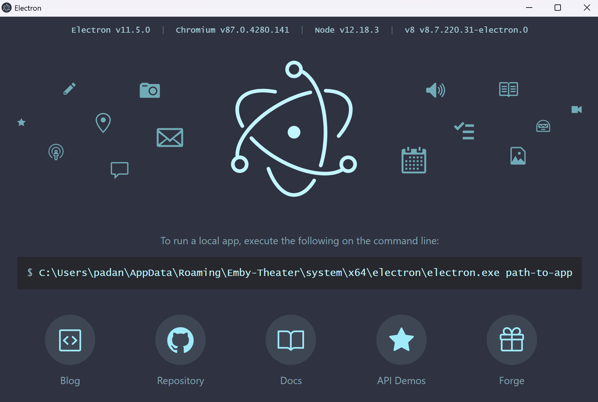

Same problem here. Emby Theater crashed on second launch and refuses to load since then.
If i click on the Electron icon showing up on the taskbar i get the following... Nothing suspicious in AppData\Roaming\Emby-Theater\logs.
I don't want to use the native Windows app as it is not compatible with external players and i need MPC-BE to enjoy MadVR on my projector.
Edited by padanagua
