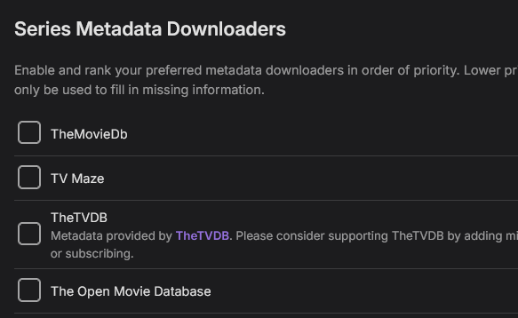

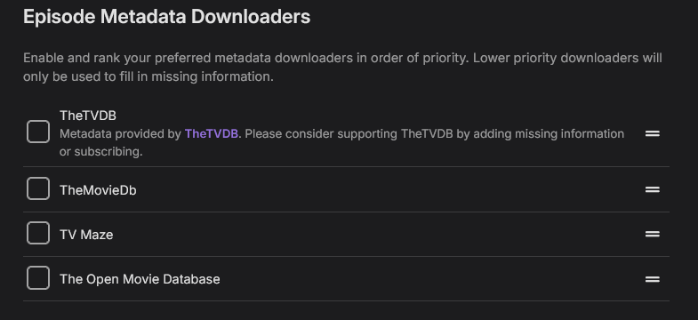

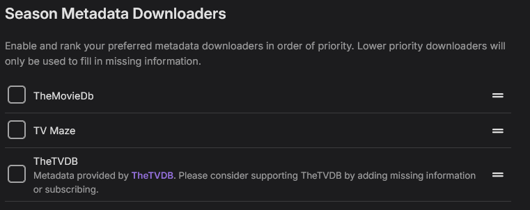

GrimReaper 4926 Posted April 3, 2025 Posted April 3, 2025 3 minutes ago, Luke said: Refresh metadata isn’t the right way because that prioritizes internet metadata first, so the nfo edits will just get overwritten. It might work for you if all internet metadata is disabled. 7 hours ago, Smitty018210 said: I don't use Emby to download metadata (I use TMM) and have all metadata downloading disabled in Emby 6 hours ago, GrimReaper said: Are you positive you have all metadata-downloaders disabled in Emby 6 hours ago, Smitty018210 said: Yup everything is turned off
Smitty018210 147 Posted April 3, 2025 Author Posted April 3, 2025 4 minutes ago, Luke said: Refresh metadata isn’t the right way because that prioritizes internet metadata first, so the nfo edits will just get overwritten. It might work for you if all internet metadata is disabled. All of the internet downloading is turned off

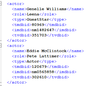

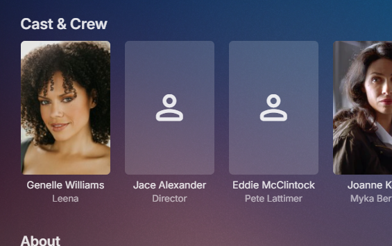

Smitty018210 147 Posted April 3, 2025 Author Posted April 3, 2025 (edited) Ok, so I think it has some thing to do with this: <type>GuestStar</type> Any of the actors that have that "type" under the actors name in the nfo file emby dose not honor the changes made to the order of the cast list. If I go in and delete that line of code from the nfo file then I run a liberty scan then emby see the changes and reorders the actor list. I am guess this something that TMM adds that emby dose not and that is what is causing the issue. Edited April 3, 2025 by Smitty018210

Smitty018210 147 Posted April 3, 2025 Author Posted April 3, 2025 (edited) 9 minutes ago, Happy2Play said: Can you provide a specific example? Hey Happy, I uploaded the nfo file before in an earlier post, but here it is again. If you look at actor Genelle Williams for example she has <type>GuestStar</type> under her name. If I try and move her in the cast listing it dose not show up in emby, but If I go into the nfo file delete that line of code then emby see the change and it shows up. Should add that I am not getting actor list form TVDB. I have TMM set to download actors list from TMBD. Could that be what is causing this issue? Warehouse 13 - 1x01 - Pilot.nfo Edited April 3, 2025 by Smitty018210

Happy2Play 9814 Posted April 3, 2025 Posted April 3, 2025 5 minutes ago, Smitty018210 said: Hey Happy, I uploaded the nfo file before in an earlier post, but here it is again. If you look at actor Genelle Williams for example she has <type>GuestStar</type> under her name. If I try and move her in the cast listing it dose not show up in emby, but If I go into the nfo file delete that line of code then emby see the change and it shows up Warehouse 13 - 1x01 - Pilot.nfo 12.2 kB · 0 downloads I had no issue drag and droping this actor. But you have to ensure you maintain your Cast Lock unless you have Emby writing nfo files to rewrite the actual order.
