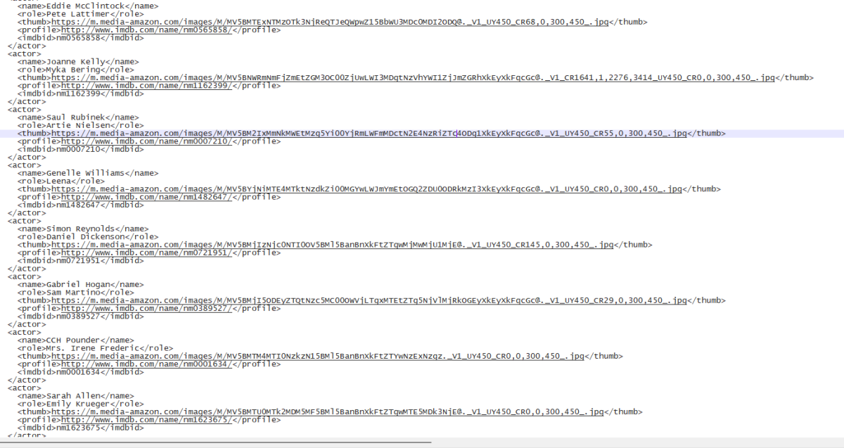

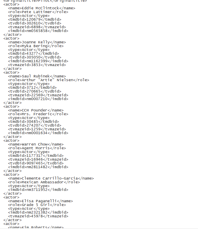

Smitty018210 147 Posted April 3, 2025 Author Posted April 3, 2025 (edited) Ok, so this is strange. I did a re-scan of the episode in TTM and look at the .nfo file in Notepad++ and it looked like this. I then went into the emby metadata editor and moved person again and saved then did a library refresh and looked at the .nfo file again and it looked like this. Why was it changed? Edit: The person that I moved still didn't save again. Edited April 3, 2025 by Smitty018210

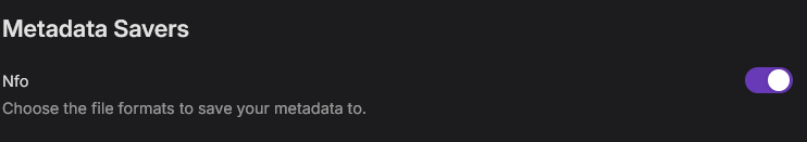

GrimReaper 4926 Posted April 3, 2025 Posted April 3, 2025 (edited) 6 minutes ago, Smitty018210 said: Why was it changed? You likely have Metadata Savers>NFO enabled in library settings - you generally wouldn't want to do that, it is never a good idea to have multiple software wtite/rewrite your NFOs. Have only TMM write 'em (backend) and Emby only read' em (front-end). Edited April 3, 2025 by GrimReaper

GrimReaper 4926 Posted April 3, 2025 Posted April 3, 2025 6 minutes ago, Smitty018210 said: I then went into the emby metadata editor and moved person again and saved then did a library refresh and looked at the .nfo file again and it looked like this. Can you post that NFO?
Smitty018210 147 Posted April 3, 2025 Author Posted April 3, 2025 1 minute ago, GrimReaper said: You likely have Metadata Savers>NFO enabled in library settings - you workshop want to do that, or is never a good idea to have multiple software wtite/rewrite your NFOs. Have only TMM write 'em (backend) and Emby only read' em (front-end). This?
GrimReaper 4926 Posted April 3, 2025 Posted April 3, 2025 Just now, Smitty018210 said: This? Yes. Turn that off.
Smitty018210 147 Posted April 3, 2025 Author Posted April 3, 2025 Just now, GrimReaper said: Yes. Turn that off. Ok, thanks will try that. I've only switch over to TMM in the last few months. Still trying to fine tune settings. THANKS!

Smitty018210 147 Posted April 3, 2025 Author Posted April 3, 2025 (edited) 6 minutes ago, GrimReaper said: You might post server log so it can be seen what calls were made. Either way, i'd tick/untick (enable/disable) all those settings just in case no setting remained hanging/unchanged. Ok, so I edited the cast order in TMM and refreshed the emby library and emby is still no showing updated list? thanks for the help. Still unsure what I am doing wrong. Also attached log and nfo Edit. .nfo file appears correct after editing. Emby just dose not seem to read the new order. embyserver.txt Warehouse 13 - 1x01 - Pilot.nfo Edited April 3, 2025 by Smitty018210

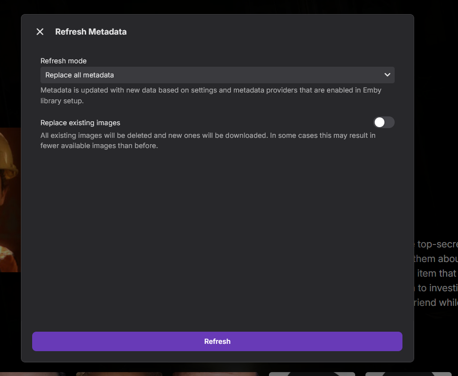

GrimReaper 4926 Posted April 3, 2025 Posted April 3, 2025 3 minutes ago, Smitty018210 said: Ok, so I edited the cast order in TMM and refreshed the emby library and emby is still no showing updated list? thanks for the help. Still unsure what I am doing wrong. Wild guess would be you're Refreshing Metadata>Search for missing instead of Replace all: Quote 2025-04-03 05:33:00.457 Info App: Refresh metadata requested on 376529 2025-04-03 05:33:00.457 Info Server: http/1.1 Response 204 to host1. Time: 0ms. POST http://192.168.0.19:8096/emby/Items/376529/Refresh?Recursive=true&ImageRefreshMode=Default&MetadataRefreshMode=Default&ReplaceAllImages=false&ReplaceAllMetadata=false&X-Emby-Client=Emby Web&X-Emby-Device-Name=Firefox Windows&X-Emby-Device-Id=0d8f9329-0585-4458-8c66-c99d554519e0&X-Emby-Client-Version=4.8.11.0&X-Emby-Token=x_secret1_x&X-Emby-Language=en-us 2025-04-03 05:33:11.676 Info Server: http/1.1 POST To recapitulate, you should: 1) Reorder cast in TMM (NFOs should be automatically updated/rewritten); if they're already in the desired order: right-click>Rewrite NFO on desired level (TV show or episode) in case Emby had overwritten those in the meantime 2) Refresh Metadata selecting Replace all in the dialog

GrimReaper 4926 Posted April 3, 2025 Posted April 3, 2025 2 minutes ago, Smitty018210 said: In TMM I use the (scrape metadata for selected episode) option, but have do not overwright turned on. As I don't want TMM changing this after I've manual updated things either. Scraping is different process and it doesn't affect your current issue (whether you overwrite existing data or not). Right-click>Re-writing NFOs from context menu simply writes whatever is in TMMs database at the moment (that'd include your manual updates) to the NFO. 5 minutes ago, Smitty018210 said: The issues seems to be that emby is not updating from the new/saved/updated /nfo file even after re-scanning the library. Re-scanning might not pick up all the changes, personally I always refresh metadata on item I'm changing/updating, i.e. if I'm updating episode, I'm refreshing metadata on that particular episode - if I'm updating TV show, I'm refreshing TV show metadata. YMMV.
Smitty018210 147 Posted April 3, 2025 Author Posted April 3, 2025 5 minutes ago, GrimReaper said: Scraping is different process and it doesn't affect your current issue (whether you overwrite existing data or not). Right-click>Re-writing NFOs from context menu simply writes whatever is in TMMs database at the moment (that'd include your manual updates) to the NFO. Re-scanning might not pick up all the changes, personally I always refresh metadata on item I'm changing/updating, i.e. if I'm updating episode, I'm refreshing metadata on that particular episode - if I'm updating TV show, I'm refreshing TV show metadata. YMMV. Are you talking about refreshing from here? As far as I know that is the only place to refresh at the episode level and after turning of all metadata freacher would that even work?
GrimReaper 4926 Posted April 3, 2025 Posted April 3, 2025 Just now, Smitty018210 said: Are you talking about refreshing from here? Yes. Just now, Smitty018210 said: As far as I know that is the only place to refresh at the episode level and after turning of all metadata freacher would that even work? It will, and it should read your updated NFO.
Smitty018210 147 Posted April 3, 2025 Author Posted April 3, 2025 1 minute ago, GrimReaper said: Yes. It will, and it should read your updated NFO. Ok, so that did not work. TMM is showing the corrected order and the nfo file is correct, but for what ever reason emby is refusing to update any changes to the metadata and is still displaying the old order. Could the nfo be cached somewhere in the emby database and it's not being updating correctly?
