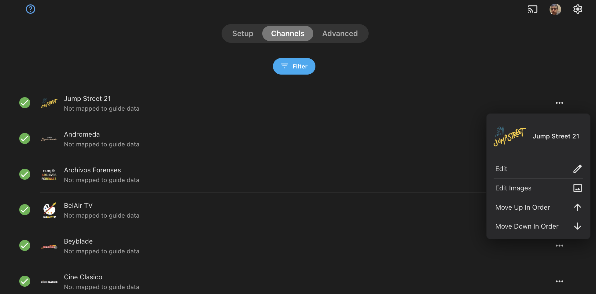

DarkStar1977 120 Posted April 4, 2025 Author Posted April 4, 2025 3 hours ago, Luke said: hi, you can do this in live tv setup, in the channels tab. No, I can't There's no Delete option.
Carlo 4561 Posted April 4, 2025 Posted April 4, 2025 9 hours ago, DarkStar1977 said: No, I can't There's no Delete option. Click on the green circle to the left of the channel. That determines if the channel is used or not.
DarkStar1977 120 Posted April 4, 2025 Author Posted April 4, 2025 Just now, Carlo said: Click on the green circle to the left of the channel. That determines if the channel is used or not. Thanks, very aligned with the rest of the interface ... XD In any case is not what I'm requesting, I want to remove it from the channel list.

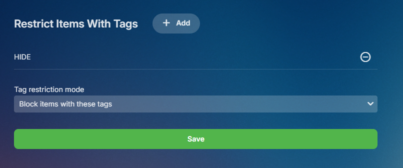

Carlo 4561 Posted April 4, 2025 Posted April 4, 2025 Emby is always going to show you the channels it has imported in that list. However, for your potential use, you may want to try testing this: Edit a channel's metadata and add a tag such as HIDE and then save it. Now go to users, select yourself as a test and go to the Parental Control tab. Set it to look like this and save it. You should no longer see this channel in general use of Emby. Once satisfied, add the parental restriction to each user on the system and no one will see it. You can pretty much use the HIDE tag anywhere on the system to hide things.
DarkStar1977 120 Posted April 21, 2025 Author Posted April 21, 2025 On 4/4/2025 at 5:53 PM, Carlo said: Emby is always going to show you the channels it has imported in that list. However, for your potential use, you may want to try testing this: Edit a channel's metadata and add a tag such as HIDE and then save it. Now go to users, select yourself as a test and go to the Parental Control tab. Set it to look like this and save it. You should no longer see this channel in general use of Emby. Once satisfied, add the parental restriction to each user on the system and no one will see it. You can pretty much use the HIDE tag anywhere on the system to hide things. Guys, you always do the same: Someone request a feature based on a simple example on why is requesting this and you provide a what you believe is a workaround because you only see the simple example provided. If I request a "delete" is because I need a delete not a way to go channel by channel flagging it with a HIDE tag. I have those tv sources: That provide around 14.000 channels and 3rd of them are duplicated or not working because are geo-blocked. I want to delete it one by one once imported with a simple "Delete button", not going one by one, editing the metadata, and putting a tag to not seeing it. Said that, no one answered to my 2nd request: 2,- In HomeScreen View today you can only see: I would like to have the ability to see only channels marked as "Favourites". Thanks.

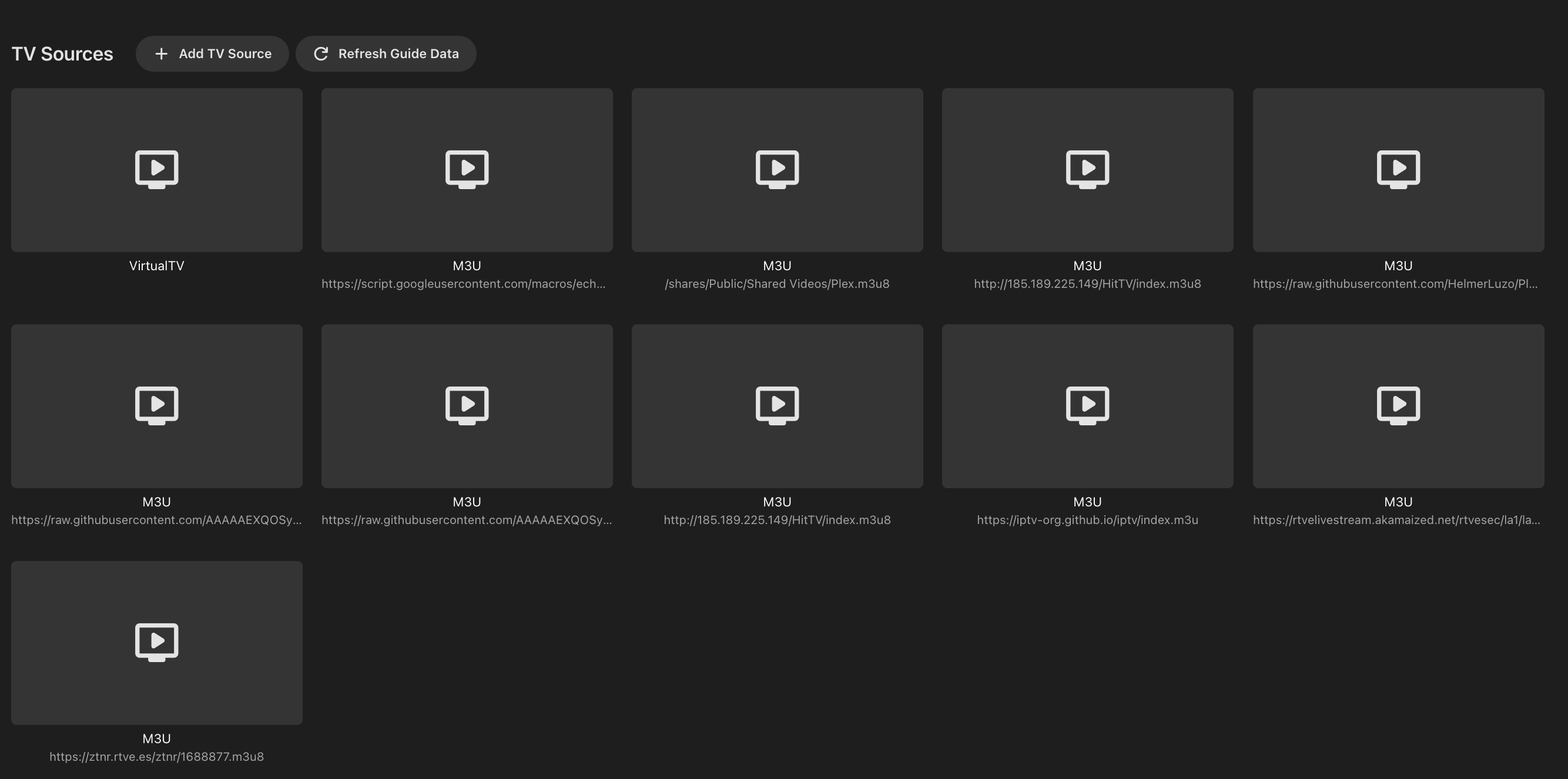

Luke 42241 Posted April 23, 2025 Posted April 23, 2025 On 4/21/2025 at 10:20 AM, DarkStar1977 said: Guys, you always do the same: Someone request a feature based on a simple example on why is requesting this and you provide a what you believe is a workaround because you only see the simple example provided. If I request a "delete" is because I need a delete not a way to go channel by channel flagging it with a HIDE tag. I have those tv sources: That provide around 14.000 channels and 3rd of them are duplicated or not working because are geo-blocked. I want to delete it one by one once imported with a simple "Delete button", not going one by one, editing the metadata, and putting a tag to not seeing it. Said that, no one answered to my 2nd request: 2,- In HomeScreen View today you can only see: I would like to have the ability to see only channels marked as "Favourites". Thanks. HI, did you try simply unchecking it from live tv channel management?
DarkStar1977 120 Posted April 23, 2025 Author Posted April 23, 2025 7 hours ago, Luke said: HI, did you try simply unchecking it from live tv channel management? Yes and it's very complicated to handle it this way. You may first go to a channel, check if it works or it's duplicated. Then you must go to channel management and look for it, but the ordering is based on imported m3u filles tthis means that you may manually look for it over 14.000 channels because there are only filter options based on the guide, not even an option to sort them by channel number or name, and then once u've found it, uncheck it. As you can imagine takes so much long time, that's why I want a "delete" button, if the channel is duplicated or does not work (geo-blocked), right click -> Delete from the channel directly.
