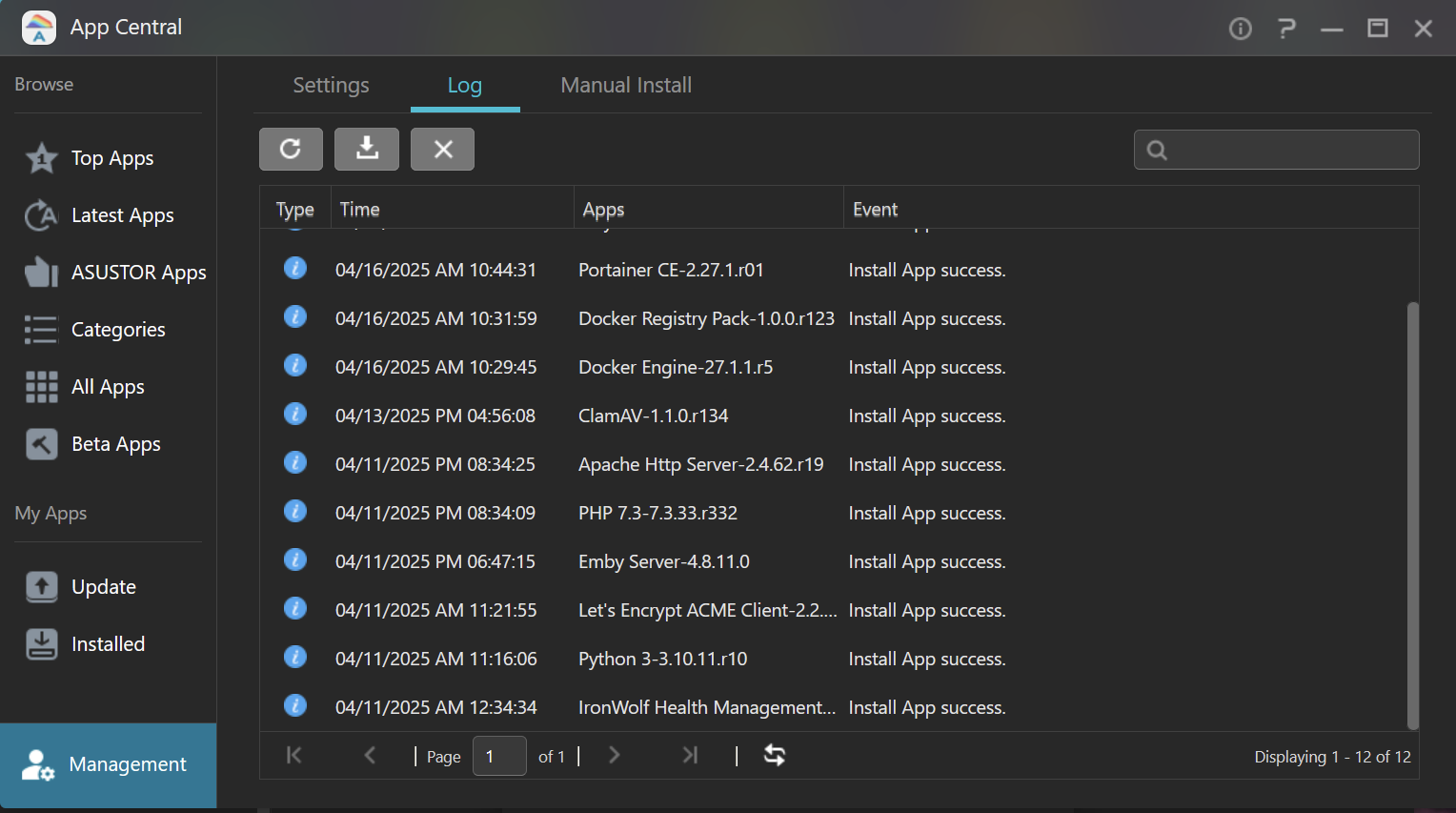

tedfroop21 89 Posted April 21, 2025 Posted April 21, 2025 4.8 works fine too. Set it up last week. On 13/04/2025 at 02:52, ALLSTAR1986 said: That's not the problem with the ports, I have the ports for adm and emby far apart. Everything was fine until the adm 5.0 update. According to an asustor employee it is due to the new Linux kernel which was updated by asustor and therefore emby no longer works. Something has changed in the code. @Lukehow long do you need for a fix? I have emby Premiere and have not been able to use it for 1 week. I would tend not to believe the Asustor employee.... When there is a problem with the Kernel it would affect every ones installation. I would more believe there is a network issue preventing connection.
