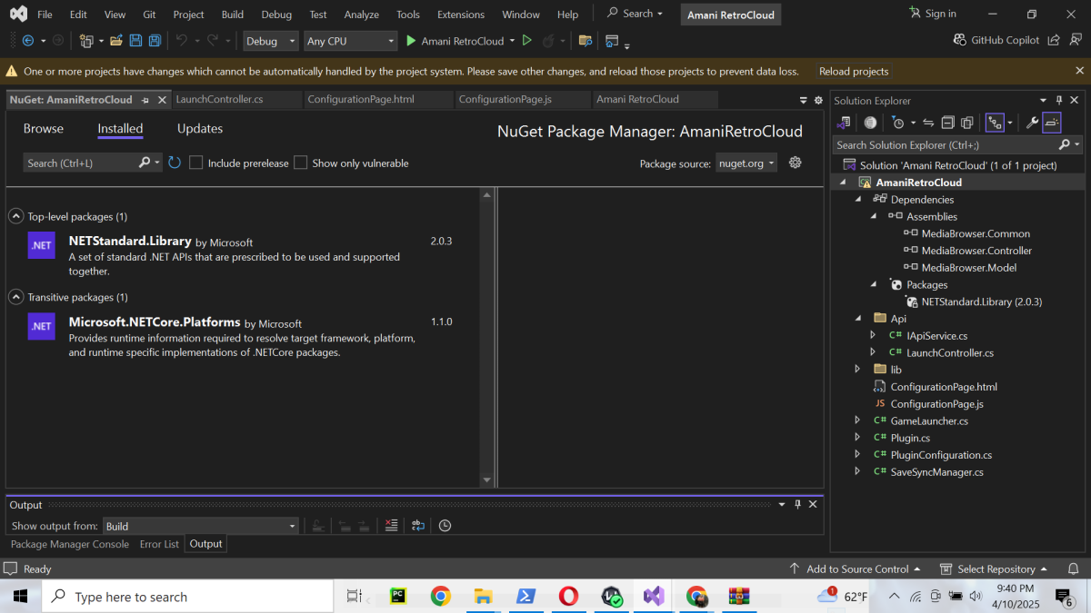

Syntax24 4 Posted April 10, 2025 Author Posted April 10, 2025 going into the file that I am copying them from and looking at the properties. In nuget manager in Visual Studio not all of the dll files I need are in there to download.
jelum 36 Posted April 10, 2025 Posted April 10, 2025 @Syntax24what Luke wants to say: In your last log: ---- 2025-04-07 22:20:14.905 Info App: Emby Server Version: 4.8.11.0 ... Could not load file or assembly 'MediaBrowser.Model, Version=4.9.0.12, ---- That means that the dependency (a nuget reference) in your project is 4.9.0.12, but the Emby server is 4.8.11.0. Change the dependency version to 4.8.11.0, rebuild the project and use the new DLL 1

Syntax24 4 Posted April 11, 2025 Author Posted April 11, 2025 This might be a dumb question but is mediabrowser.model.signed the same as mediabrowser.model?

Luke 42150 Posted April 11, 2025 Posted April 11, 2025 This is all covered in the first two sections here: https://github.com/MediaBrowser/Emby/wiki/How-to-build-a-Server-Plugin 1

Syntax24 4 Posted April 12, 2025 Author Posted April 12, 2025 Is it best to pull all Emby dependencies via NuGet or manually reference local DLLs?
Luke 42150 Posted April 12, 2025 Posted April 12, 2025 1 hour ago, Syntax24 said: Is it best to pull all Emby dependencies via NuGet or manually reference local DLLs? The guide that I linked to above, what does that say? That's what the best thing to do is 1
