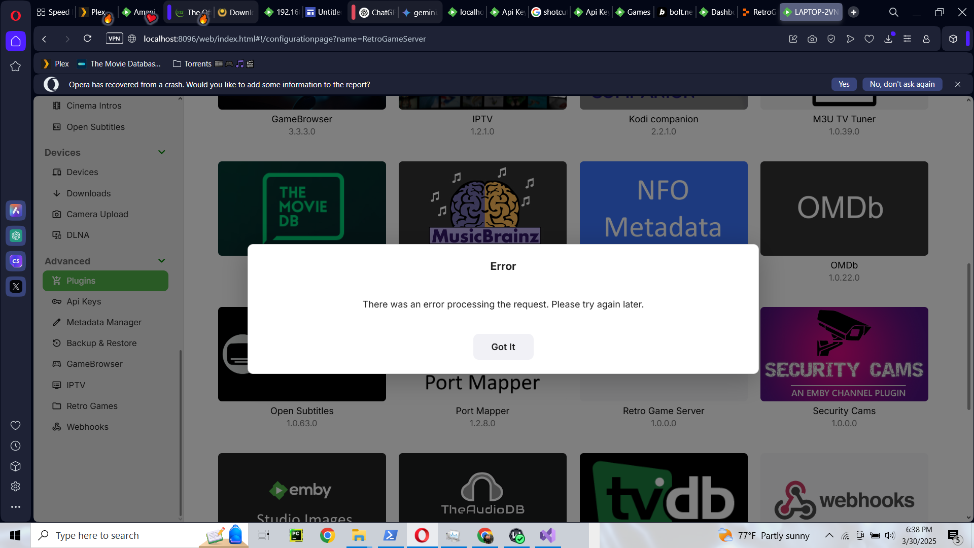

Syntax24 4 Posted March 29, 2025 Posted March 29, 2025 QQs: When developing a Plugin in Visual Studio what should the build action be set to? Is there a prefered Framework Version - Example net6.0, net2.0, etc. Image attached shows where I always get stuck at. I also attached Log File. Thank you in advance! embyserver (4).txt

Syntax24 4 Posted March 30, 2025 Author Posted March 30, 2025 I am still stuck and cannot move past this point no matter what I do, I have even used AI to check my code compared to https://github.com/MediaBrowser/Emby/wiki/How-to-build-a-Server-Plugin and https://dev.emby.media/doc/plugins/ui/index.html even having it review videos to see if my steps have been accurate ...

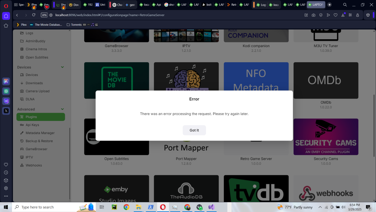

Syntax24 4 Posted March 30, 2025 Author Posted March 30, 2025 Every time I try to click on my plug-in that I am creating I get the error message that is in the above screenshot. It’s a possibility that my file structure isn’t correct. Is there a good place for me to go and reference that?
Syntax24 4 Posted March 30, 2025 Author Posted March 30, 2025 This is the error I consistently receive no matter what I change or adapt

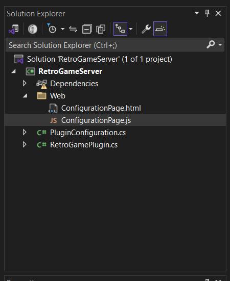

Syntax24 4 Posted March 31, 2025 Author Posted March 31, 2025 Are you asking the folder layout or for the script?
Luke 42255 Posted March 31, 2025 Posted March 31, 2025 But also how you wired it up in RetroGamePlugin.cs

Syntax24 4 Posted April 8, 2025 Author Posted April 8, 2025 (edited) @LukeI am missing something when it comes to having Emby recognize an html file. For some reason I can get the plugin page to load as long as there isn't an html in the files, once I create an html I can never get my custom settings screen to load. Any Pro Tips. I am marking them as an embedded resource. I have also attached a copy of my Log Files. The Plugin is named "Amani RetroCloud". embyserver (16).txt Edited April 8, 2025 by Syntax24
Luke 42255 Posted April 8, 2025 Posted April 8, 2025 Make sure you're using a nuget package that has a version number that is equal to or less than the version of the server you are running, not greater. 1
