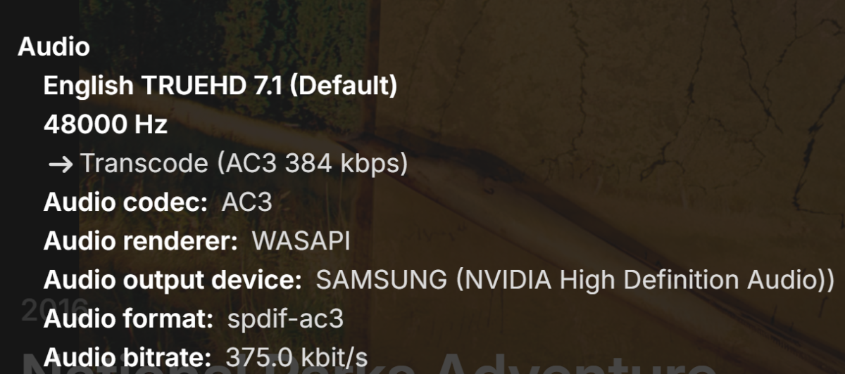

hamzanadim 5 Posted March 29, 2025 Posted March 29, 2025 (edited) Hello guys , I'm connecting my laptop to my Samsung Q80R TV using HDMI cable Samsung TV is connected to Samsung Onebar Q990D (which supports most audio including TrueHD 7.1 Atmos) using eARC, the problem is i try playing some content that are in TrueHD however it gets transcoded to DolbyDigital, in order to analyze where the problem is coming from , i downloaded that exact content from Emby and played it using the Windows Movies & TV app which can passthrough audio and the result is that my Soundbar decodes it as Dolby TrueHD with no problem and plays perfectly which leaves me with the only conclusion is that perhaps there is something im missing on the Emby Windows App or it the windows version of the app doesn't support that. can you guys please advice ? many thanks in advance NOTE : the only settings in the Emby windows app that i can see is this option and i checked all of them here are the content STATS Edited March 29, 2025 by hamzanadim more clarification

Guest Posted March 30, 2025 Posted March 30, 2025 (edited) I think @softworkz has a hard limit set when probing the audio devices. The device capabilities are probed through the HDMI, and with soundbars, that has resulted in varying results. Theater didn't probe, it lets mpv handle everything, which is why it works. This will need to be checked once again. My opinion would be to let mpv handled it. It does it better. The server thinks your soundbar (based on the probe result), doesn't support truehd. It probably thinks it's ARC not eARC. Along the same lines, you also have an AC3 audio track. Why the app isn't switching to that instead of transcoding is confusing. Seems it would a logical choice to make if its available. The video stuff in the previous comments are irrelevant. They aren't even the vo in use. This is all about the Emby backend audio config. You've shown that it plays correctly in other players. So WASAPI supports your hardware capabilities. Edited March 30, 2025 by generiq

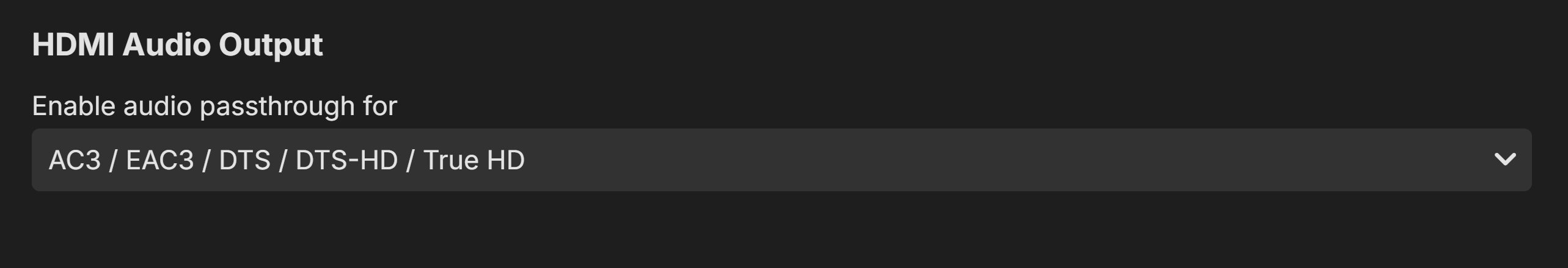

softworkz 5133 Posted April 1, 2025 Posted April 1, 2025 @hamzanadim Please try to enable Exclusive audio mode and set Speaker Layout to Auto:

softworkz 5133 Posted April 6, 2025 Posted April 6, 2025 On 4/3/2025 at 5:26 PM, hamzanadim said: but i also tried Emby Windows app (from microsoft store) also doesnt pass TrueHD Have you made the settings that I've shown? (exclusive audio enabled, Emby Windows Store app) Could you please post a log file from that, as in your mpv log above, exclusive audio was not enabled. Thanks
