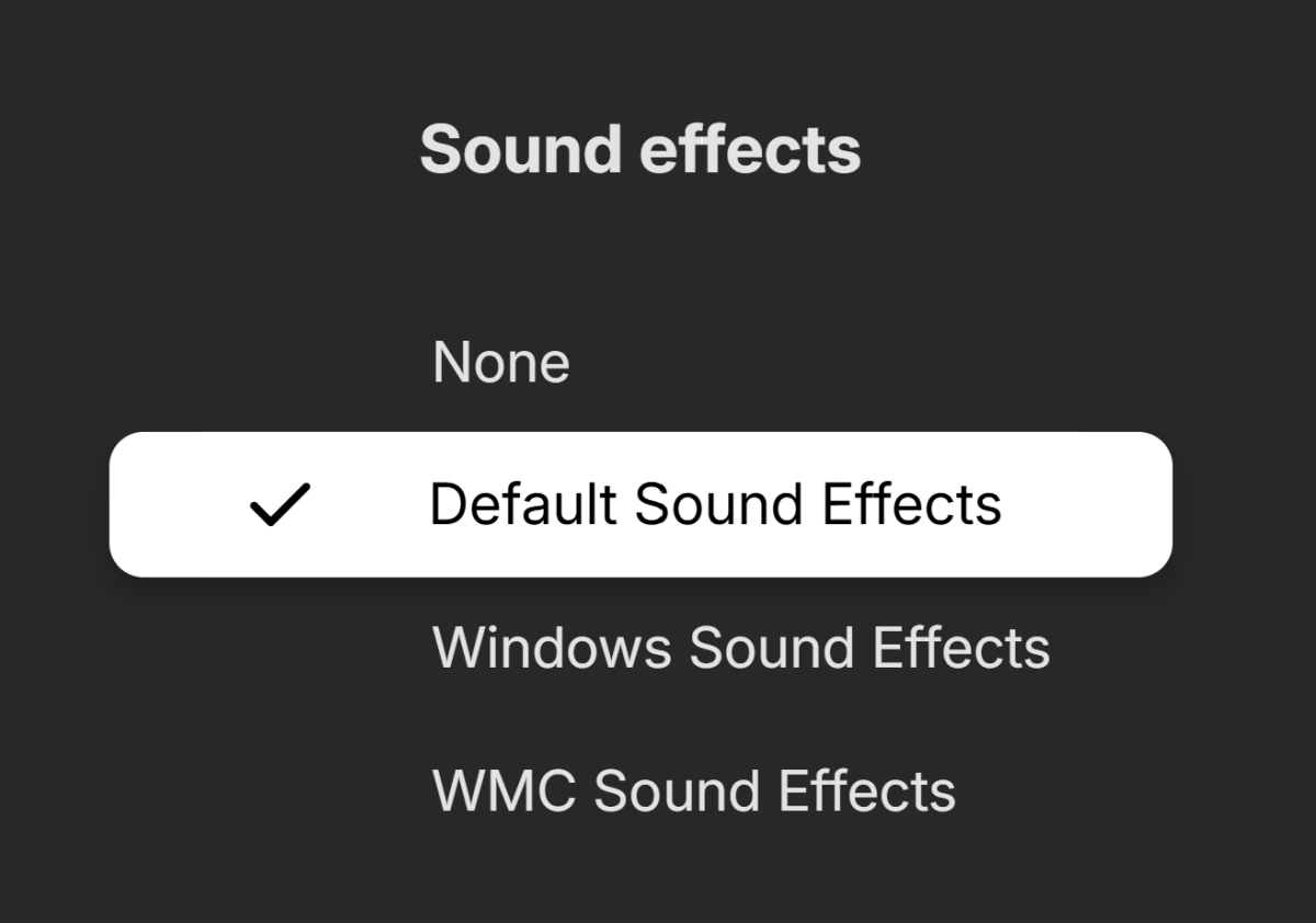

frankmb 41 Posted April 3, 2025 Author Posted April 3, 2025 On 4/1/2025 at 8:39 PM, softworkz said: Is this reproducible after app restarts? Yes. After restarting it continued with double sound. On 4/1/2025 at 8:39 PM, softworkz said: What happens when you change the sound scheme? Does the sound change? And for the "double sound", does one change or both? Sound Effect setting was initially at None yet I heard Double Sounds when using Enter key to select 1: Change to Default Sound Effect: Exact same Double Sounds when using Enter key to select. Both sounds of the "double" are the same. 2: Change to Windows Sound Effects: Different Double Sounds when using Enter key to select. Both sounds of the "double" are the same. 3: Change to WMC Sound Effects: Again Different Double Sounds when using Enter key to select. Both sounds of the "double" are the same. 4: Change to None: No Sound at all So the Sound Effect setting started to apply properly once I changed it once.

softworkz 5133 Posted April 8, 2025 Posted April 8, 2025 Very mysterious! To synchronize on the expected result. This is how it sounds here and how it's supposed to be: EmbyApp_Sounds.mp4
frankmb 41 Posted April 9, 2025 Author Posted April 9, 2025 The settings menu is not where the problem occurs. As I said, it happens in the main area when you navigate TV shows and episodes On 3/28/2025 at 8:33 PM, frankmb said: The problem is in the main area. It does not happen in the left side bar, nor on the items in the top area (home, favorites, search icon...)
