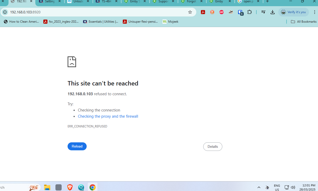

narayansmate 4 Posted March 28, 2025 Posted March 28, 2025 Hi. I have installed Emby on my QNAP TS-464C. However when I go to open it I get this message "This site can’t be reached. 192.168.0.103 refused to connect". I do not know how to open the port or allow the connection in my QNAP firewall. Can anyone provide me with step by step instructions? Hoping someone can help me. Thanks.
GrimReaper 4894 Posted March 28, 2025 Posted March 28, 2025 Not a QNAP user so I'll likely be of little assistance there, but I see in your screenshot you're using port 8920 - that is https port and typically not used in local network, have you tried connecting to default port 8096, i.e. http://192.168.0.103:8096?
narayansmate 4 Posted March 28, 2025 Author Posted March 28, 2025 Hi. 8096 does not work either. The port 8920 was what the Emby app used after clicking on it. But thank you.

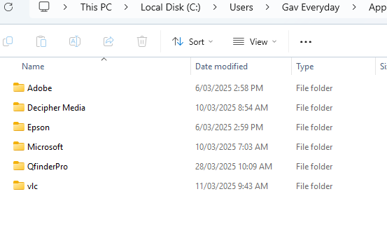

Luke 42239 Posted March 28, 2025 Posted March 28, 2025 14 minutes ago, narayansmate said: See attached. But this is the C drive of your Window machine. I thought you said you installed the server on QNAP? Did you click the link I provided to learn how to locate the server data folder on your QNAP? Emby Server Data Folder
narayansmate 4 Posted March 28, 2025 Author Posted March 28, 2025 Hi. Sorry. Have to install another app to see that share. I am doing that now but have to wait as the QNAP is doing something that is holding up the process... I am so sorry. I will be able to try again later. Thanks for bearing with me as a self professed newb...
narayansmate 4 Posted March 28, 2025 Author Posted March 28, 2025 Morning. I cannot seem to be able to find the Emby share folder or any folders. I am so sorry but I am a complete newb. How can I navigate to that folder? Is there a particular app I need to use?

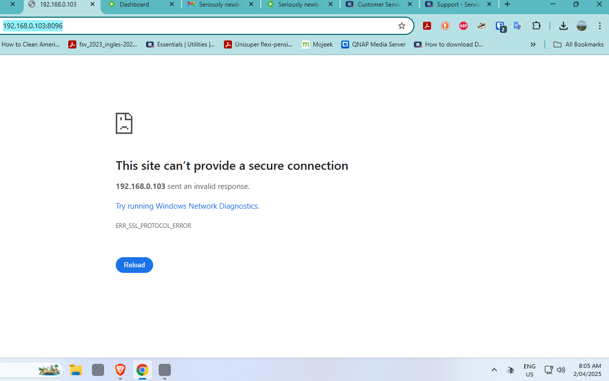

narayansmate 4 Posted April 1, 2025 Author Posted April 1, 2025 Hi Luke. Many, many thanks. So, QNAP have solved most of the issues, whatever they were (they did not say). I had downloaded the most up to date Emby package at that date, that is all. I have now downloaded the new update and installed it. Almost everything is working now, except for one thing, which I do not know how to fix. When I click on the Emby icon in QNAP server, it goes to this address: https://192.168.0.103:8920/. Which of course is incorrect, as the addresses are: In-Home (LAN) access: http://192.168.0.103:8096 and Remote (WAN) access: http://101.166.38.65:8096. When I first type in the address manually, I get a blank page, per attached, even if I manually change the port to 8096. However if I click on the internal address given inside Emby, it works a treat. Any ideas or help? Thanks. Gavin
Luke 42239 Posted April 1, 2025 Posted April 1, 2025 Quote When I click on the Emby icon in QNAP server, it goes to this address: https://192.168.0.103:8920/. There's no way to stop that unfortunately. We mark our QNAP package as https-capable, and by doing this, QNAP will always want to open the https address. But of course this will only work if you've setup https on your server. If you're not going to do that, then the best thing to do is just bookmark the http url.
