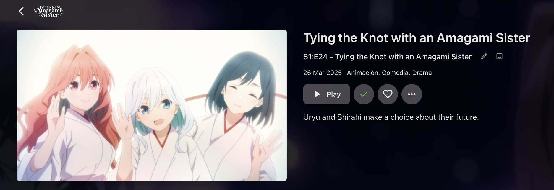

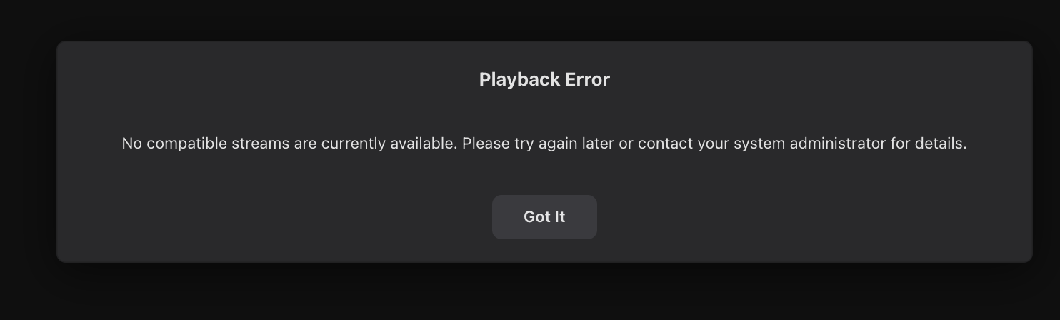

DarkStar1977 122 Posted March 26, 2025 Posted March 26, 2025 (edited) I'm suffering an issue with recent added episodes of some anime series, this one is an example: Emby is not capable to identify any language or subtitles even the file has it. Trying to play this from web browser present this error: But can be played on Apple TV but the Apple TV interface is not presenting the language or subtitles buttons in the OSD, even speed playing is not presented. This is the Media Info of the File: General Unique ID : 86082866430386832513262636567637939878 (0x40C2F4FEFB0FD7CDC153C342007A56A6) Complete name : /Volumes/-NASDATA-SHARED/ANIME (VO) 2/AMAGAMI-SAN CHI NO ENMUSUBI (TYING THE KNOT WITH AN AMAGAMI SISTER)/S01E24 - Episode 24.mkv Format : Matroska Format version : Version 4 File size : 146 MiB Duration : 23 min 40 s Overall bit rate : 862 kb/s Frame rate : 23.976 FPS Encoded date : 2025-03-25 19:35:24 UTC Writing application : mkvmerge v27.0.0 ('Metropolis') 64-bit Writing library : libebml v1.3.6 + libmatroska v1.4.9 Attachments : ARIALBD_2.TTF / arialbd_3.ttf / arialbi_2.ttf / ariali_1.ttf / ARIALNB_0.TTF / ARIALNB_1.TTF / Arial_1.ttf / Arial_2.ttf / ariblk_1.TTF / comicbd_0.ttf / comici_0.ttf / comicz_0.ttf / comic_0.ttf / georgiab_0.ttf / georgiai_0.ttf / georgia_0.ttf / impact_0.ttf / tahomabd_2.ttf / Tahoma_0.ttf / timesbd_2.ttf / timesbd_3.ttf / timesbi_0.ttf / timesi_0.ttf / times_1.ttf / trebucbd_0.ttf / trebucbi_0.ttf / trebucit_0.ttf / trebuc_0.ttf / verdanab_0.ttf / verdana_0.ttf / AdobeArabic-Bold.otf / AdobeArabic-BoldItalic.otf / AdobeArabic-Regular.otf Video ID : 1 Format : HEVC Format/Info : High Efficiency Video Coding Format profile : Main@L4@High Codec ID : V_MPEGH/ISO/HEVC Duration : 23 min 39 s Bit rate : 587 kb/s Width : 1 920 pixels Height : 1 080 pixels Display aspect ratio : 16:9 Frame rate mode : Constant Frame rate : 23.976 (24000/1001) FPS Color space : YUV Chroma subsampling : 4:2:0 (Type 0) Bit depth : 8 bits Bits/(Pixel*Frame) : 0.012 Stream size : 99.3 MiB (68%) Writing library : x265 3.5+1-f0c1022b6:[Mac OS X][clang 14.0.3][64 bit] 8bit+10bit+12bit Encoding settings : cpuid=1111039 / frame-threads=4 / wpp / no-pmode / no-pme / no-psnr / no-ssim / log-level=2 / input-csp=1 / input-res=1920x1080 / interlace=0 / total-frames=0 / level-idc=40 / high-tier=1 / uhd-bd=0 / ref=3 / no-allow-non-conformance / no-repeat-headers / annexb / no-aud / no-eob / no-eos / no-hrd / info / hash=0 / temporal-layers=0 / open-gop / min-keyint=24 / keyint=240 / gop-lookahead=0 / bframes=4 / b-adapt=0 / b-pyramid / bframe-bias=0 / rc-lookahead=15 / lookahead-slices=6 / scenecut=40 / no-hist-scenecut / radl=0 / no-splice / no-intra-refresh / ctu=64 / min-cu-size=8 / no-rect / no-amp / max-tu-size=32 / tu-inter-depth=1 / tu-intra-depth=1 / limit-tu=0 / rdoq-level=0 / dynamic-rd=0.00 / no-ssim-rd / signhide / no-tskip / nr-intra=0 / nr-inter=0 / no-constrained-intra / strong-intra-smoothing / max-merge=2 / limit-refs=3 / no-limit-modes / me=1 / subme=2 / merange=57 / temporal-mvp / no-frame-dup / no-hme / weightp / no-weightb / no-analyze-src-pics / deblock=0:0 / sao / no-sao-non-deblock / rd=2 / selective-sao=4 / no-early-skip / rskip / fast-intra / no-tskip-fast / no-cu-lossless / no-b-intra / no-splitrd-skip / rdpenalty=0 / psy-rd=2.00 / psy-rdoq=0.00 / no-rd-refine / no-lossless / cbqpoffs=0 / crqpoffs=0 / rc=crf / crf=24.0 / qcomp=0.60 / qpstep=4 / stats-write=0 / stats-read=0 / vbv-maxrate=30000 / vbv-bufsize=30000 / vbv-init=0.9 / min-vbv-fullness=50.0 / max-vbv-fullness=80.0 / crf-max=0.0 / crf-min=0.0 / ipratio=1.40 / pbratio=1.30 / aq-mode=2 / aq-strength=1.00 / cutree / zone-count=0 / no-strict-cbr / qg-size=32 / no-rc-grain / qpmax=69 / qpmin=0 / no-const-vbv / sar=1 / overscan=0 / videoformat=5 / range=0 / colorprim=1 / transfer=1 / colormatrix=1 / chromaloc=1 / chromaloc-top=0 / chromaloc-bottom=0 / display-window=0 / cll=0,0 / min-luma=0 / max-luma=255 / log2-max-poc-lsb=8 / vui-timing-info / vui-hrd-info / slices=1 / no-opt-qp-pps / no-opt-ref-list-length-pps / no-multi-pass-opt-rps / scenecut-bias=0.05 / no-opt-cu-delta-qp / no-aq-motion / no-hdr10 / no-hdr10-opt / no-dhdr10-opt / no-idr-recovery-sei / analysis-reuse-level=0 / analysis-save-reuse-level=0 / analysis-load-reuse-level=0 / scale-factor=0 / refine-intra=0 / refine-inter=0 / refine-mv=1 / refine-ctu-distortion=0 / no-limit-sao / ctu-info=0 / no-lowpass-dct / refine-analysis-type=0 / copy-pic=1 / max-ausize-factor=1.0 / no-dynamic-refine / no-single-sei / no-hevc-aq / no-svt / no-field / qp-adaptation-range=1.00 / scenecut-aware-qp=0conformance-window-offsets / right=0 / bottom=0 / decoder-max-rate=0 / no-vbv-live-multi-pass / no-mcstf / no-sbrc Default : Yes Forced : No Color range : Limited Color primaries : BT.709 Transfer characteristics : BT.709 Matrix coefficients : BT.709 Audio ID : 2 Format : E-AC-3 Format/Info : Enhanced AC-3 Commercial name : Dolby Digital Plus Codec ID : A_EAC3 Duration : 23 min 40 s Bit rate mode : Constant Bit rate : 224 kb/s Channel(s) : 2 channels Channel layout : L R Sampling rate : 44.1 kHz Frame rate : 28.711 FPS (1536 SPF) Compression mode : Lossy Stream size : 37.9 MiB (26%) Title : Japanese Language : Japanese Service kind : Complete Main Default : Yes Forced : No Dialog Normalization : -31 dB dialnorm_Average : -31 dB dialnorm_Minimum : -31 dB dialnorm_Maximum : -31 dB Text #1 ID : 3 Format : ASS Codec ID : S_TEXT/ASS Codec ID/Info : Advanced Sub Station Alpha Duration : 23 min 18 s Bit rate : 139 b/s Frame rate : 0.237 FPS Count of elements : 332 Compression mode : Lossless Stream size : 23.9 KiB (0%) Title : Español Language : Spanish Default : No Forced : Yes Text #2 ID : 4 Format : ASS Codec ID : S_TEXT/ASS Codec ID/Info : Advanced Sub Station Alpha Duration : 23 min 18 s Bit rate : 143 b/s Frame rate : 0.242 FPS Count of elements : 338 Compression mode : Lossless Stream size : 24.4 KiB (0%) Title : English Language : English Default : No Forced : No Menu 00:00:00.000 : ja:Episode 00:19:10.000 : ja:Credits Start 00:20:40.000 : ja:Credits End Same file is played perfectly using Infuse over the Emby Server, with all options present: And of course is perfectly identified and played by VLC, INAA and other Media Players, all except emby. This episode has the same encode options of all previous 23 that are perfectly identified and played. I've had the same issue on another show, but in that case the subtitles were .VOB and emby was unable to identify anything related to audio or subtitles presenting errors on web browser and playing correctly in Apple TV, but this is not the case of the issue today, subtitles are ASS. What's happening ? It is very anoying have to use Infuse to play things from the emby server because emby clients fails to read the file information. Attached Emby Server log and transcode log ffmpeg-transcode-ab595700-c542-4b24-8f19-97c21db965c7_1.txt embyserver.txt Edited March 26, 2025 by DarkStar1977

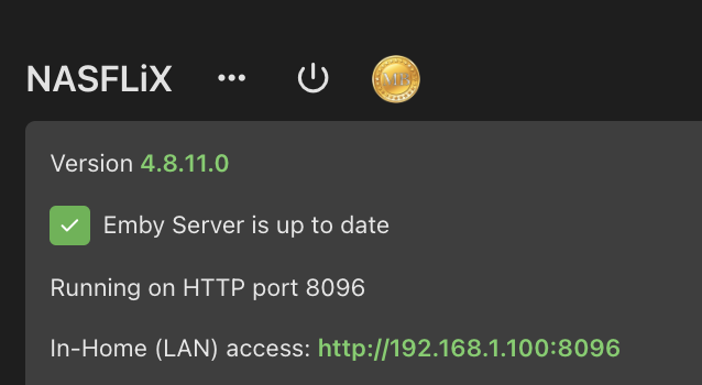

DarkStar1977 122 Posted March 26, 2025 Author Posted March 26, 2025 1 hour ago, Happy2Play said: Doubt it will change anything but probably should update to latest release 4.8.11.0. Emby Server Version: 4.8.10.0 I don't konw why the log says that. Server is upgraded to 4.8.11.0 already:

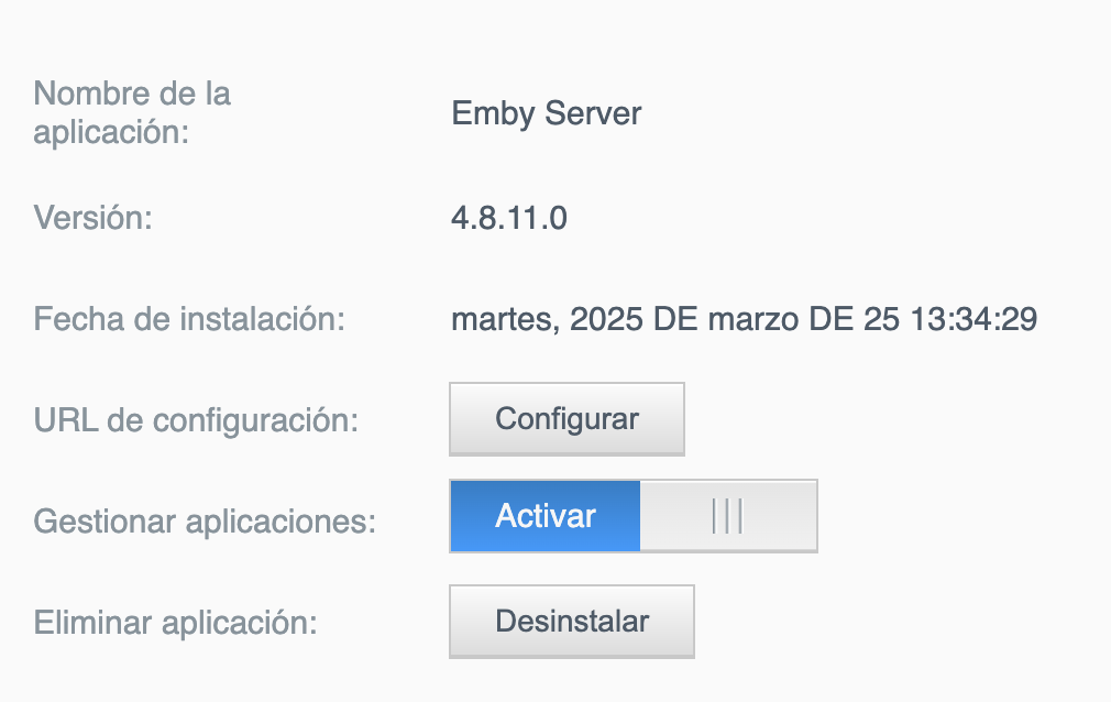

DarkStar1977 122 Posted March 26, 2025 Author Posted March 26, 2025 1 minute ago, Luke said: I would try rebooting the machine. Emby is running on a WD PR4100 NAS, I've not rebooted the machine but I've stopped and re-enabled the service: BTW, I'm seeing that those files are the 1st uploaded into emby after the upgrade, are u sure the upgrade did not break something ? Various fixes with SMB folder access on Linux, macOS and Android servers Those files are hosted in another NAS server that's mounted via SMB into EMBY Server NAS .....

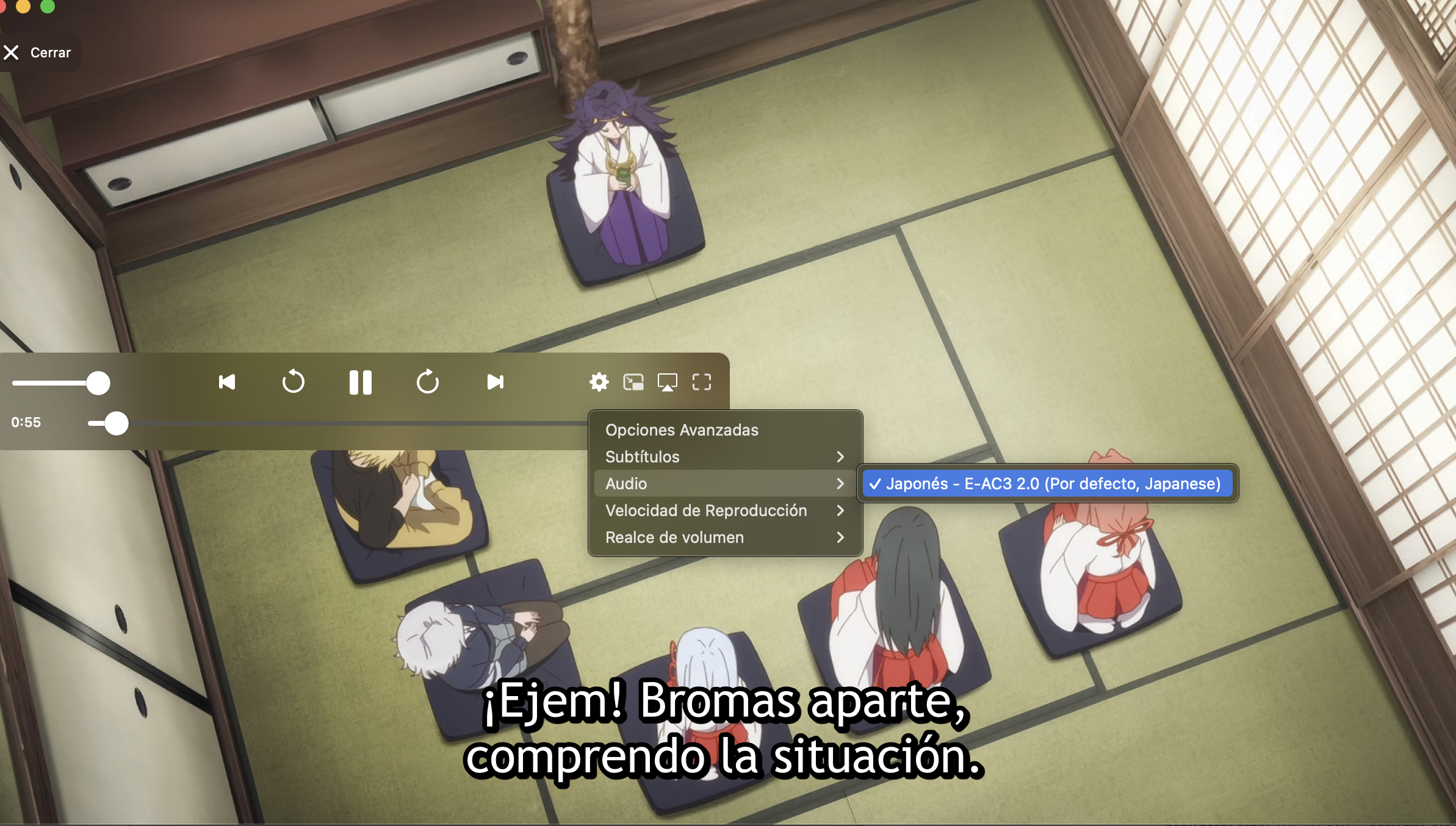

DarkStar1977 122 Posted March 26, 2025 Author Posted March 26, 2025 Forget it. Restarted the server twice and now all audio and subtitles info is there ....
