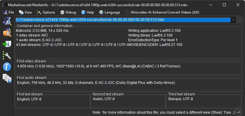

visproduction 335 Posted March 26, 2025 Posted March 26, 2025 (edited) The short video sample above has this audio: Audio 768 kb/s 48.0 kHz, 32 bits, 6 channel, E-AC-3 JOC (Dolby Digital Plus with Dolby Atmos) There are also 43 subtitles embedded in the media. On Plex, is the TV actually playing back Atmos or a converted lower quality transcoded audio and just listing the original as EAC-3 5.1 audio? If Emby is transcoding because of not recognizing this audio can play through an Ethernet or Wifi to the TV, then it can be the transcoding causing the stuttering. This is high end audio. What kind of server speed / hardware combination can transcode this in real time? Can your server do this and transmit the change to the TV smoothly? What demand does 43 subtitles add to the transcoding? Do you need more hardware to do this? Playback with other methods like Plex is not proof that it should work smoothly with Emby transcoding of Atmos, subs and Wifi transmission in real time. The playback is handled by completely different software and is not pushing the results to the same player. Does the earlier .mov file show that EAC-3 5.1? Is that Dolby Atmos delivered or is the info on the screen showing just the original file information. I found this discussion about Atmos and TV playback with a lot of details. Again, the idea seems to be to send it through HDMI to get the correct audio. https://www.avsforum.com/threads/dolby-digital-plus-dd-atmos-over-hdmi-arc.2378442/ Edited March 26, 2025 by visproduction
Terriman 1 Posted March 26, 2025 Author Posted March 26, 2025 8 minutes ago, visproduction said: The short video sample above has this audio: Audio 768 kb/s 48.0 kHz, 32 bits, 6 channel, E-AC-3 JOC (Dolby Digital Plus with Dolby Atmos) There are also 43 subtitles embedded in the media. On Plex, is the TV actually playing back Atmos or a converted lower quality transcoded audio and just listing the original as EAC-3 5.1 audio? If Emby is transcoding because of not recognizing this audio can play through an Ethernet or Wifi to the TV, then it can be the transcoding causing the stuttering. This is high end audio. What kind of server speed / hardware combination can transcode this in real time? Can your server do this and transmit the change to the TV smoothly? What demand does 43 subtitles add to the transcoding? Do you need more hardware to do this? Playback with other methods like Plex is not proof that it should work smoothly with Emby transcoding of Atmos, subs and Wifi transmission in real time. The playback is handled by completely different software and is not pushing the results to the same player. Does the earlier .mov file show that EAC-3 5.1? Is that Dolby Atmos delivered or is the info on the screen showing just the original file information. I found this discussion about Atmos and TV playback with a lot of details. Again, the idea seems to be to send it through HDMI to get the correct audio. https://www.avsforum.com/threads/dolby-digital-plus-dd-atmos-over-hdmi-arc.2378442/ Plex is playing direct Atmos, no conversion. Emby is not transcoding, check my previous posts with one picture showing it's direct play. Wifi transmission? Both server and TV are connected in the same house using RJ45 cable. Send the audio through HDMI? WTF? Where? I'm using my TV speakers.
