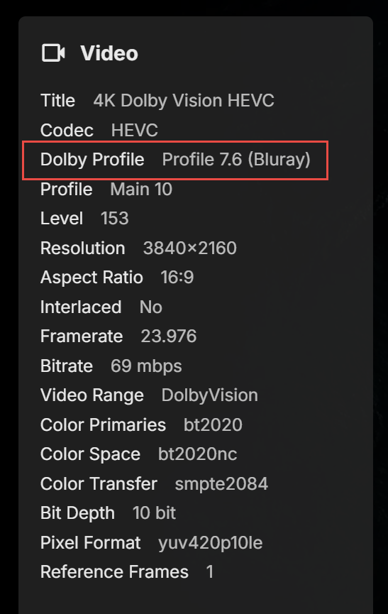

0balbert 6 Posted May 2, 2025 Author Posted May 2, 2025 All the movies that I am having a problem playing have a Dolby ProfileProfile 7.6 (Bluray)

Vivek91 1 Posted May 7, 2025 Posted May 7, 2025 (edited) I'm facing same issue on my tv when playing dolby vision Profile 7.6 (Bluray). It seems emby is unable to decode the dovi profile 7 and my my case emby does not play hdr version of that file. On my tv although i'm unable to play dv7 but hdr1O works fine, but emby does not fallback to hdr profile for same. Can some confirm if emby support fallback to hdr10 from dv7 Edited May 7, 2025 by Vivek91
ebr 16334 Posted May 7, 2025 Posted May 7, 2025 Hi. As noted, that is a Disc profile so most streaming devices will not play it.
