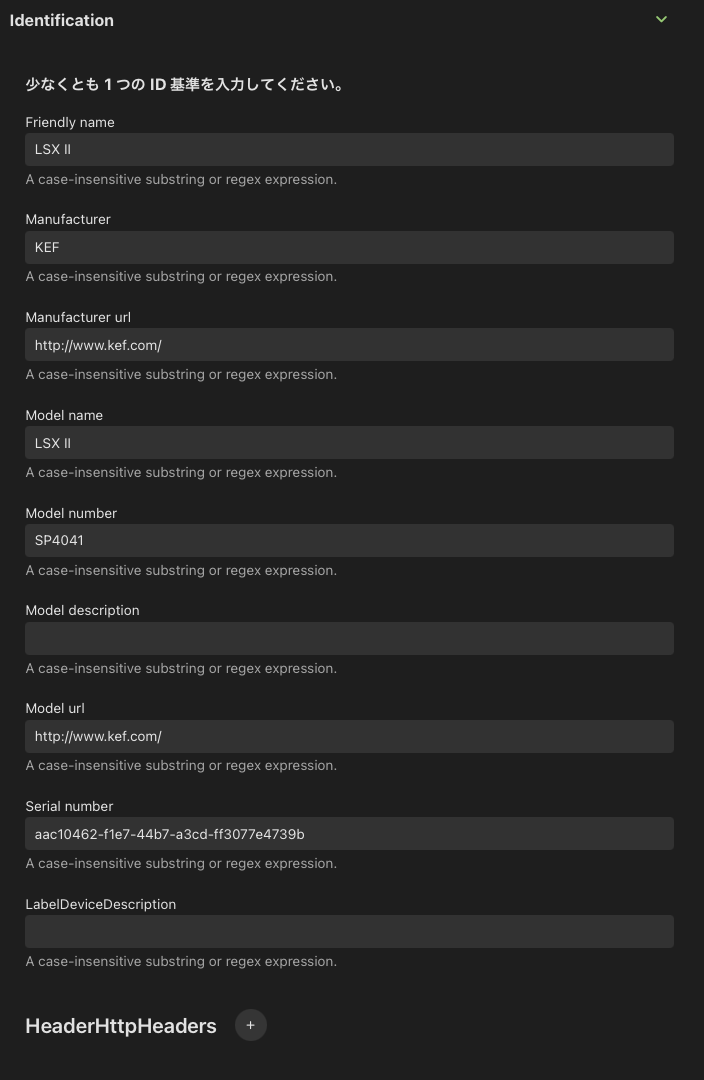

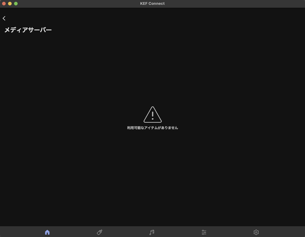

zplusmsz 0 Posted March 24, 2025 Posted March 24, 2025 Hi, I’m having trouble getting Emby to show up in the KEF Connect app via DLNA. I’d appreciate any advice or support. 1.Environment [Emby Server] • NAS: Asustor NAS (AS3304T) • IP: 192.168.0.111 • Emby Version: 4.8.11.0 (Premiere) • “Enable DLNA Play to”: ON • “Enable DLNA Server”: ON • Emby app bundled with the NAS is used [Client] • Speaker: KEF LSX II (Wi-Fi connected / IP: 192.168.0.150) • App: KEF Connect (iOS and Android) 2.Issue The Emby server does not appear in the list of UPnP servers within the KEF Connect app. However, the Emby server does appear and function properly in other UPnP-compatible apps such as mconnect. Additionally, “UPnP Media Server V2” and “MiniDLNA” are successfully detected and playable from KEF Connect. 3.Logs • embyserver01.txt: Log before creating the DLNA profile • embyserver02.txt: Log after creating the DLNA profile embyserver01.txt embyserver02.txt

zplusmsz 0 Posted March 24, 2025 Author Posted March 24, 2025 I restarted the Emby Server while KEF Connect was running, but the issue remains the same. embyserver03.txt

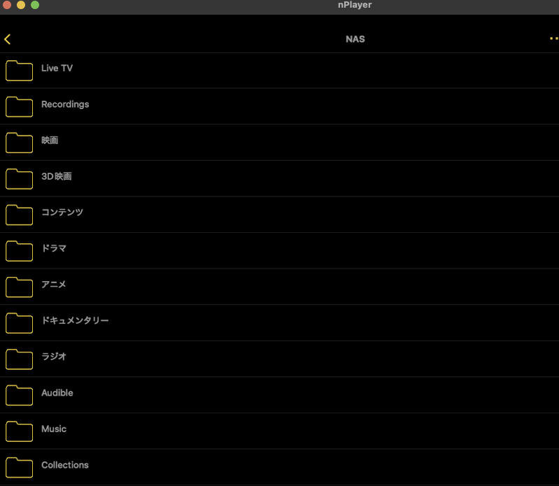

zplusmsz 0 Posted March 31, 2025 Author Posted March 31, 2025 I tried the suggestions above, but unfortunately the issue still persists. To verify the situation, I installed MiniDLNA on the same NAS, and KEF Connect detected it immediately — which strongly suggests the issue is related to Emby’s DLNA advertisement or KEF Connect’s DLNA compatibility. To verify the situation, I installed MiniDLNA on the same NAS, and KEF Connect detected it immediately — which strongly suggests the issue is related to Emby’s DLNA advertisement or KEF Connect’s DLNA compatibility. Environment: - NAS: Asustor AS3304T - Emby Version: 4.8.11.0 (Premiere) - DLNA Settings: DLNA Server: Enabled, DLNA Play To: Enabled - Friendly Name: EmbyServer - KEF Speaker: LSX II - KEF App: KEF Connect (iOS/Android latest) - Network Config: Same subnet (192.168.0.x), IPv4, UPnP enabled What I confirmed: - mconnect and nPlayer apps can access Emby DLNA server via port 8096 without issues. - KEF Connect cannot detect Emby, but it can detect MiniDLNA (on the same NAS). - Emby successfully recognizes the KEF LSX II as a DLNA Renderer, and sends AVTransport control messages to port 16500 on the LSX II. - Emby and LSX II are on the same subnet (192.168.0.111 and 192.168.0.150 respectively). Clarification on Ports: | Port | Purpose | Used By | |-------|---------------------------------------|--------------------------| | 8096 | Emby DLNA server / Web UI | Clients like mconnect | | 16500 | DLNA Renderer control (AVTransport) | Emby → LSX II | → Emby’s server side (8096) is working as expected, but KEF Connect seems to ignore or miss the DLNA advertisement. Log Excerpt (Emby recognizing KEF LSX II): DLNA Session created for LSX II - LSX II. Description url: http://192.168.0.150:16500/... POST http://192.168.0.150:16500/Control/LibRygelRenderer/RygelAVTransport Request: Is there anything I can do on the Emby side to make it more compatible with KEF Connect? Is this a known limitation, or something that could be improved in the SSDP/DLNA announcement behavior? Any suggestions or guidance would be appreciated. Thank you! embyserver.txt
