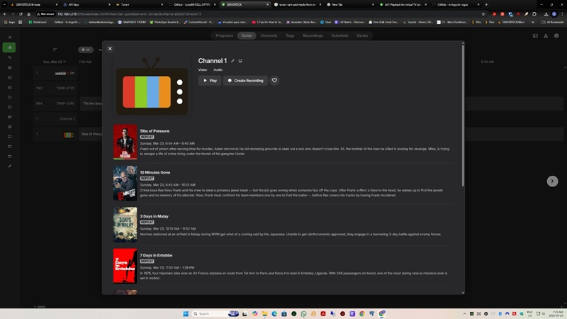

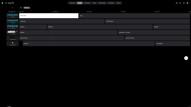

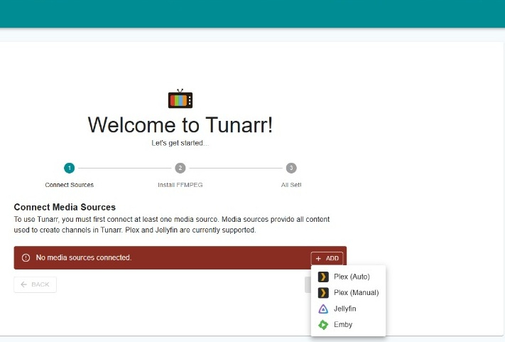

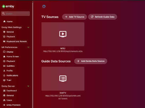

ryzen5000 17 Posted March 23, 2025 Author Posted March 23, 2025 (edited) I figured out a way to make it work. The only reason I needed Jellyfin was because i tried both Plex and Emby and it wouldn't connect through sign in or connect to Emby option was not working however it is in Tunarr but appears to still be under development. This way I can watch my own media as live tv on Emby. 1.Install Tunarr 2.Install Jellyfin Media Server and add all your libraries. 3.Open Tunarr and take the API key from Jellyfin and (you will need this to make Jellyfin into Embys slave or B****) 4.Connect Tunnar to Jellyfin, set to AutoStart if possible on both tunarr and Jellyfin. 5.Create some channels, use logos from here add media and select Play alphabetical, I tried random and it wrongly put the same movie on all channels I added. 6.Copy the m3u and xml tv from Tunarr and put it into Emby in Live TV using M3U selection. Don't add it as HD home run, it doesn't work properly. 7.Leave hls default in Transcoding Settings 8.Refresh guide. 9.If it is all looking good, your tv guide should be working then create more channels. Edited March 23, 2025 by ryzen5000 Uploading another image and correcting capitalization

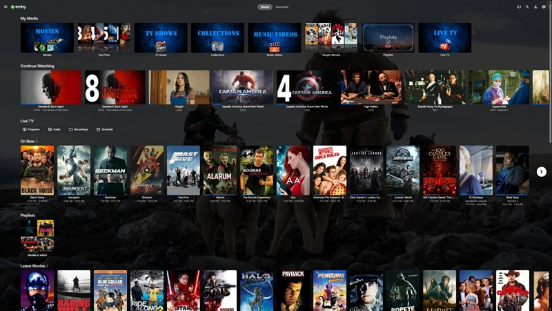

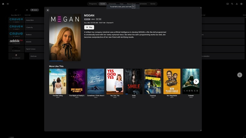

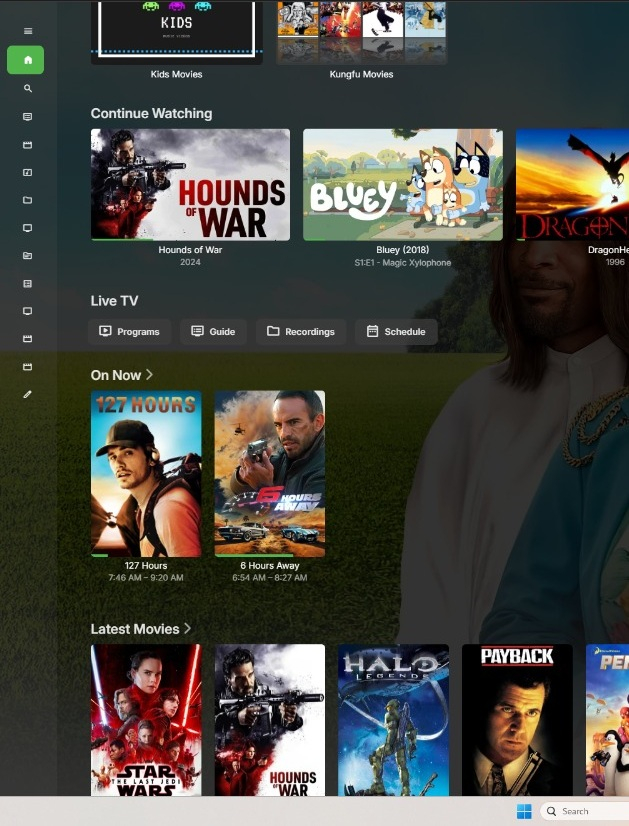

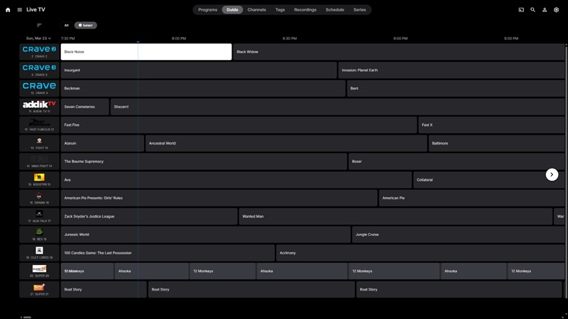

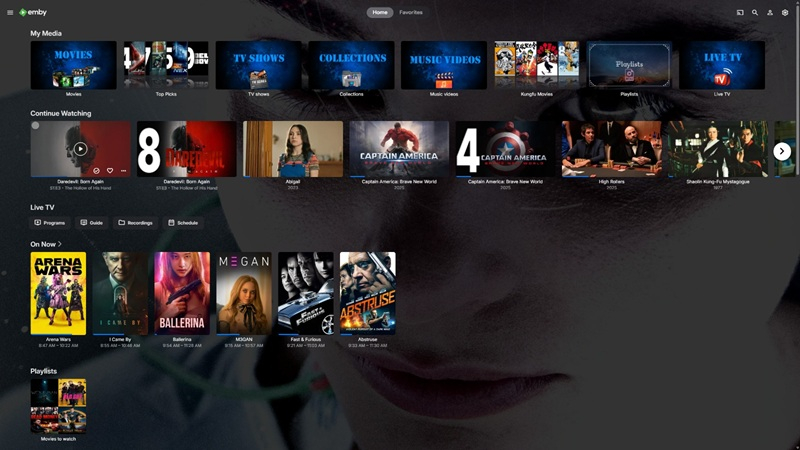

ryzen5000 17 Posted March 23, 2025 Author Posted March 23, 2025 It is going slowly but good, playback is perfect and sound quality is great through Emby on live TV using my own media. I actually feel better about having a separate app like tunarr vs a plugin because I can share it with other apps too and if Emby were to crash, doesn't happen often. All my efforts are backed up by appdata backup on unraid. Anyways this is my progress so far. I plan on making more channels. The guide works perfectly.

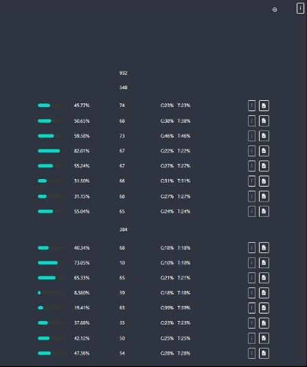

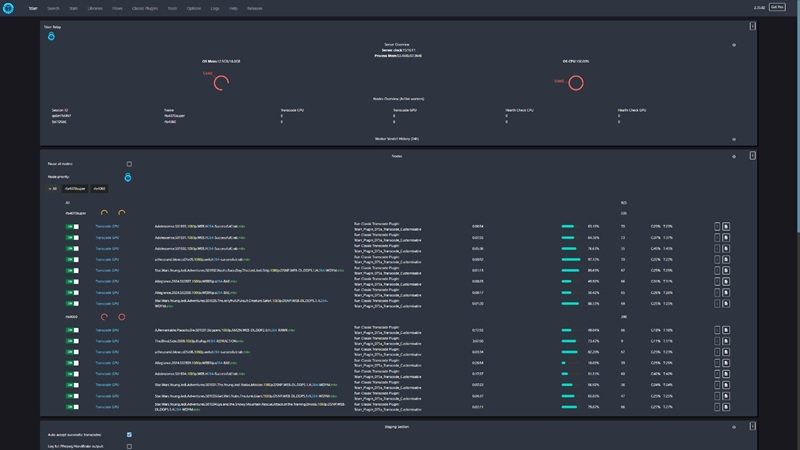

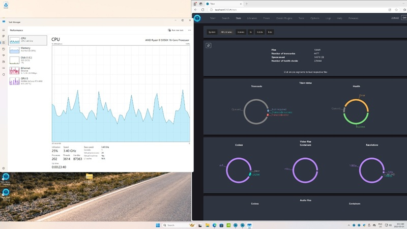

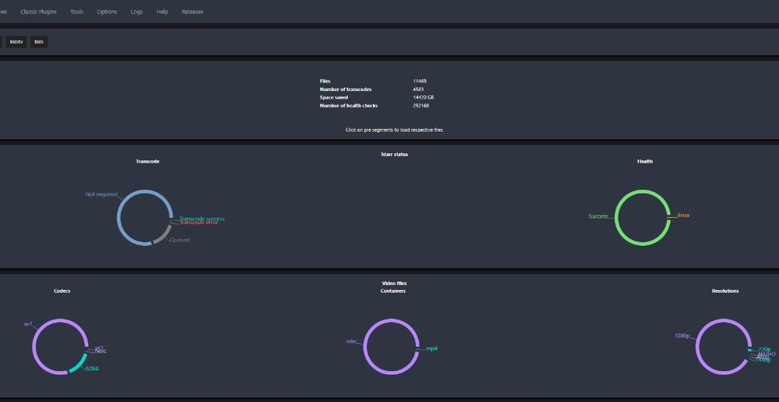

ryzen5000 17 Posted March 24, 2025 Author Posted March 24, 2025 Yes, no problem. I tested it and it would have worked perfectly except for my library now has the AV1 codec. But in the future maybe plugins or architecture will adapt as more people are converting their libraries to save space. Here are some examples of my AV1 conversion guide working in case anyone is interested. I am using a rtx 4060, rtx 4070 super to do the work. Video quality is very good and with my guide you can adjust it tweak it even more or use the presets I already made.
