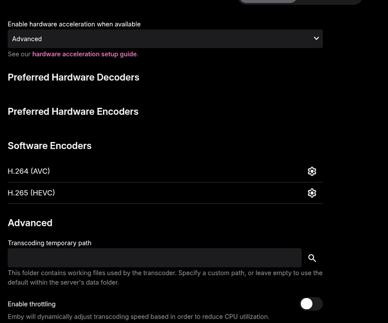

I was updating my FFMPEG today and now I dont see my video card or decoder options anymore. How do I get them back?
Hi, wise exactly did you do?
sftech13
updated FFMPEG to current and ensured NVENC was working. It wasnt working for transcoding before.
I used a custom built FFMPEG
Edited by sftech13
Custom built with Emby?
sftech13
No but still use the emby path for FFMPEG

Are you able to revert what you did?
sftech13
I dont think so.
I tried to roll back to the version I found in a old log. Didnt seem to fix it.

sftech13
Reinstall fixed it.
