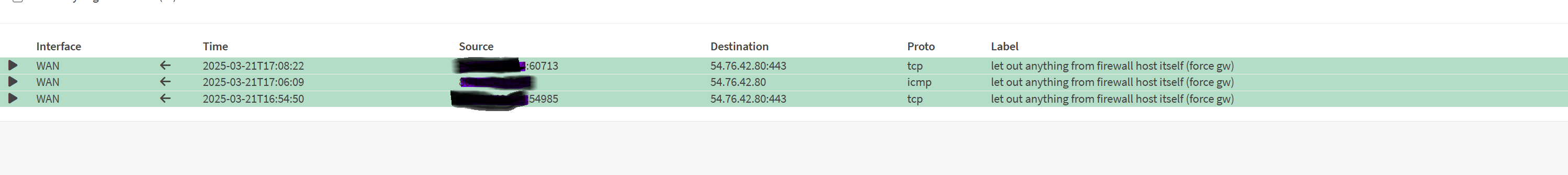

OlliePlimsoles 0 Posted March 21, 2025 Posted March 21, 2025 (edited) No i still have the same problem and do not have any VPN installed, I looked in OPNSense and that can see everything going out fine I Have even reverted my router to its defaults so its just going straight out to the Internet, I also changed from PFsense to OPNSense literally to see what is going on but no joy. Do they block IPS or something for to many requests maybe? Edited March 21, 2025 by OlliePlimsoles
