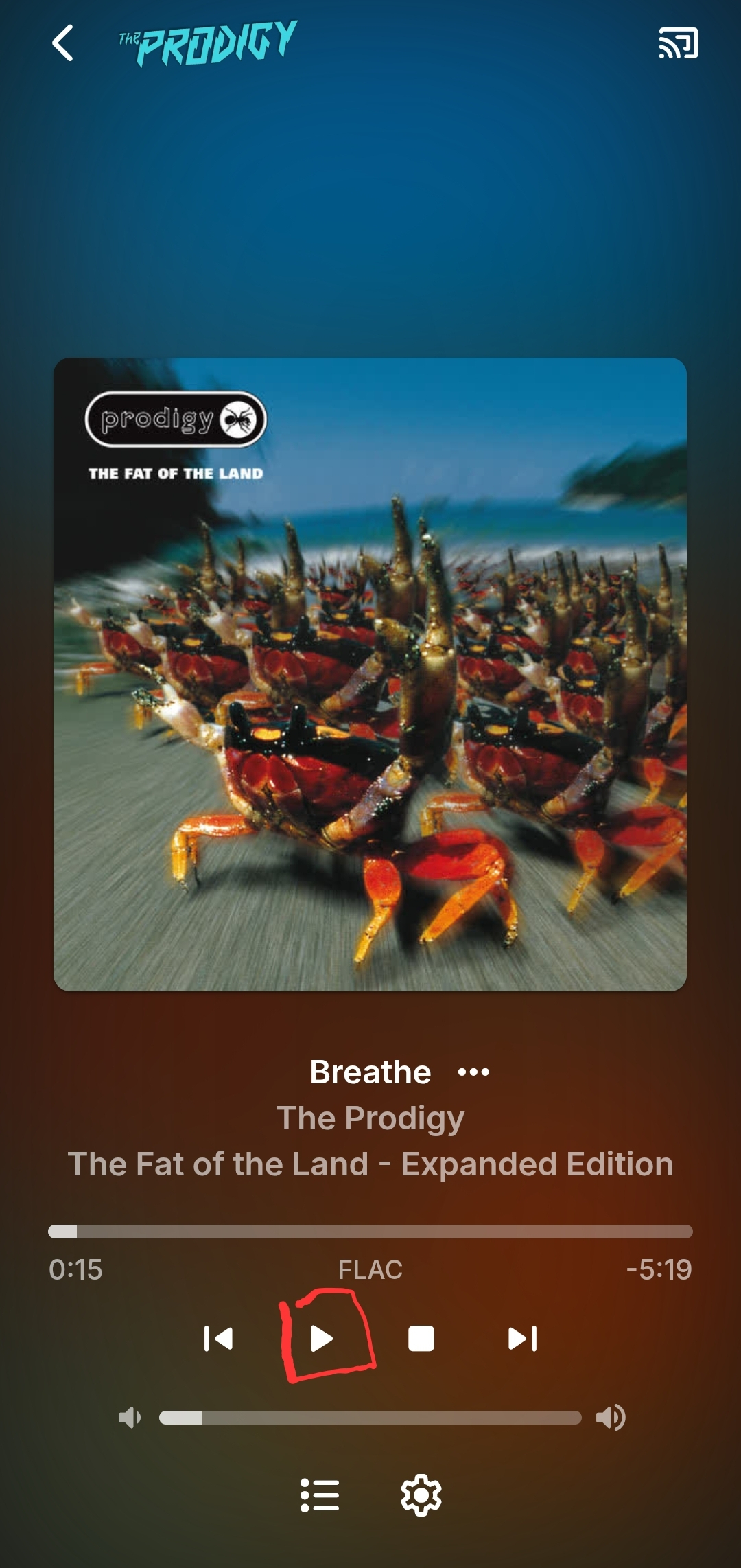

liamthexpl0rer 1 Posted April 8, 2025 Author Posted April 8, 2025 12 hours ago, Luke said: Can you please show a Screenshot example? Thanks. Not really. When I play a song (Song1) the slider move forward. When the next Song (Song2) starts playing, the Song2 will be showed, but in the UI it seems like the Song is paused and the slider wont move. After I have reloaded the site oder reopen the App everything is normal again.
Luke 42237 Posted April 9, 2025 Posted April 9, 2025 7 hours ago, liamthexpl0rer said: Not really. When I play a song (Song1) the slider move forward. When the next Song (Song2) starts playing, the Song2 will be showed, but in the UI it seems like the Song is paused and the slider wont move. After I have reloaded the site oder reopen the App everything is normal again. Hi there, please attach the Emby server log from when the problem occurred: How to Report a Problem Thanks!

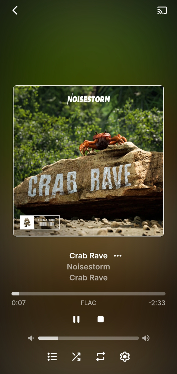

liamthexpl0rer 1 Posted April 10, 2025 Author Posted April 10, 2025 (edited) Good morning, here is my Server Log and a screenshot from the beginning of Song2. In the screenshot, the song is playing. embyserver(3).txt Edited April 10, 2025 by liamthexpl0rer Wrong explaintaion and Log without the error.
