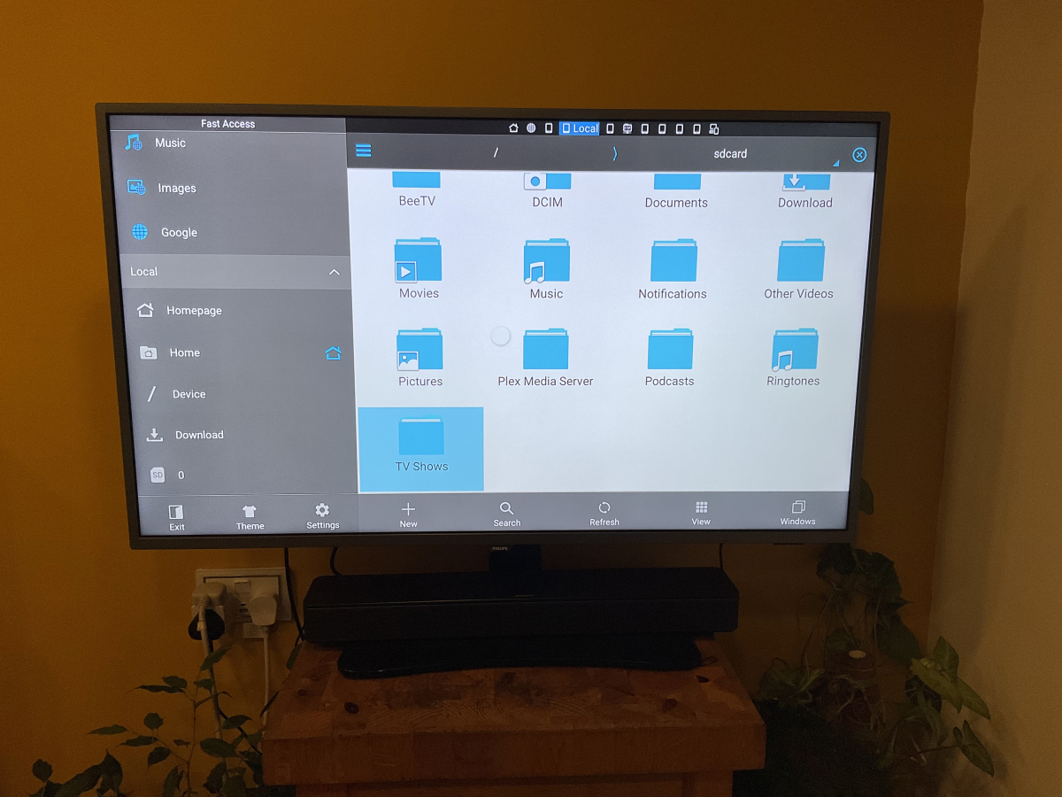

Sion30uk 0 Posted March 20, 2025 Author Posted March 20, 2025 (edited) I have installed a file manager and I can see part source/emulate/0 but nothing beyond that the problem is that on my shield the password still works so I can access my movies etc I tried logging out and then going back in on shield hoping that I would get a prompt to reset my password but rather than the prompt to put in a password it just goes straight back in like the password is stored somewhere on my shield or in another place what I need is to be able to access Emby via my ipad are there instructions as to how to do this it feels like I am going to have to delete everything and start again. I don’t have a pc only a Mac mini or ipad and iPhone the shield is the only thing I have that is android. the network does allow me access I now have a file manager saved on my shield but it’s doesnt show me the Emby folder , is there a recommend file manager I should use on my shield. Since my shield is working is there a way to just set up Emby on my ipad with a separate server and not use the one on my shield rather than them be linked because I have paid for 1 Emby account on my iPad and 1 on my shield. I am using ES File Explorer to NVIDIA Shield TV Thanks for your help so far Edited March 20, 2025 by Sion30uk

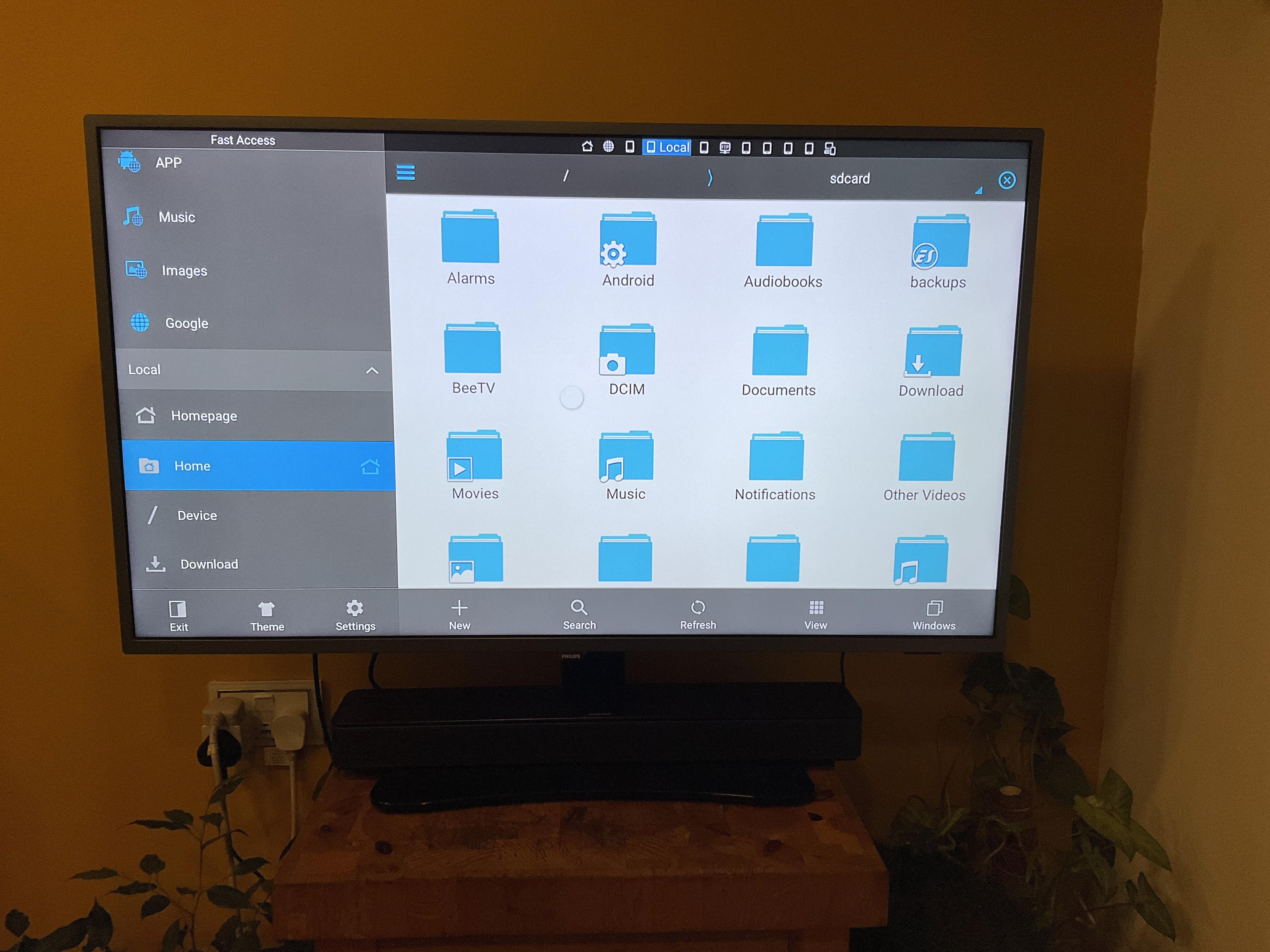

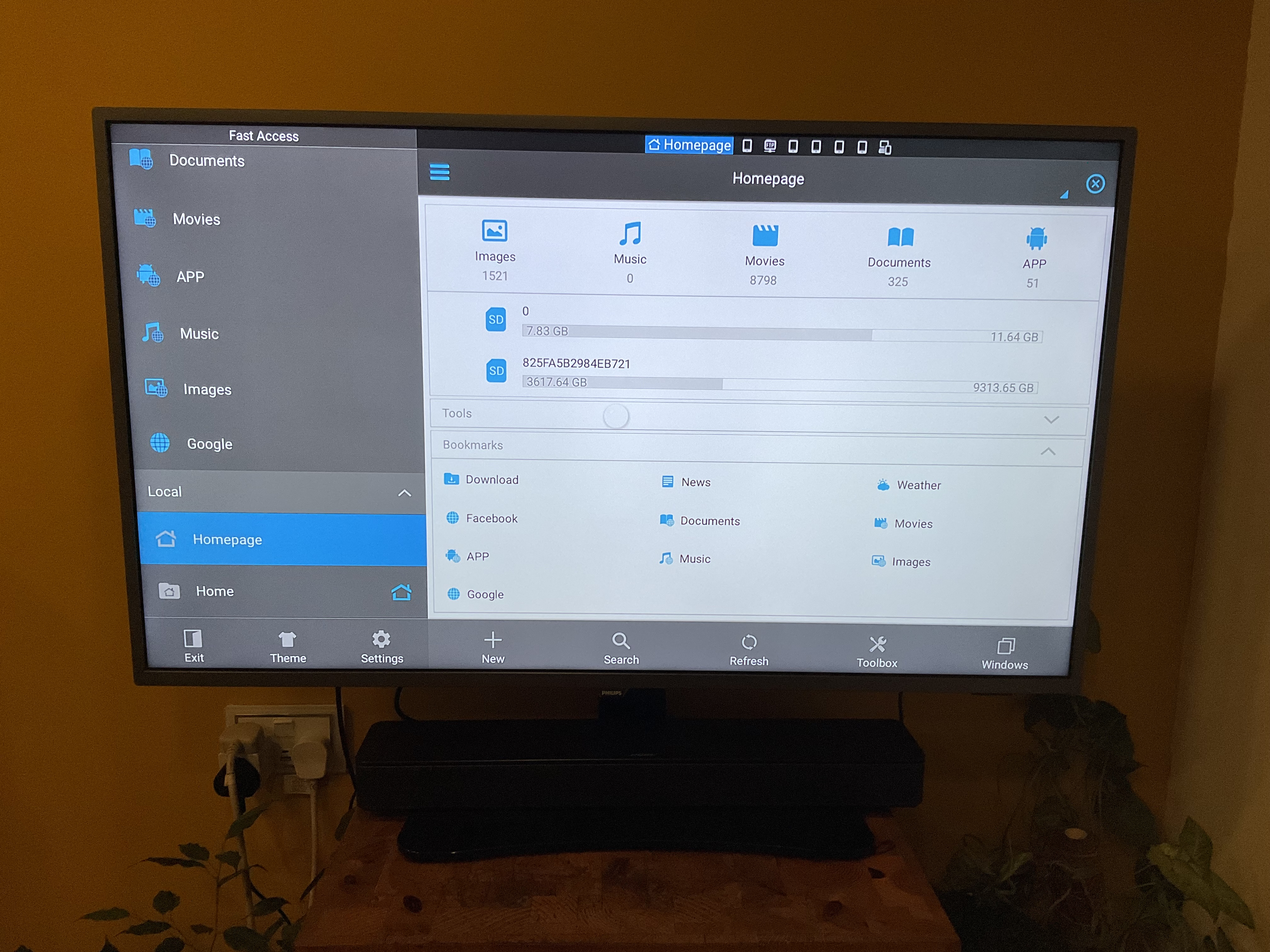

GrimReaper 4893 Posted March 20, 2025 Posted March 20, 2025 1 hour ago, Sion30uk said: I am using ES File Explorer to NVIDIA Shield TV Can you share a screenshot or photo of what you see when you select Home in ES?

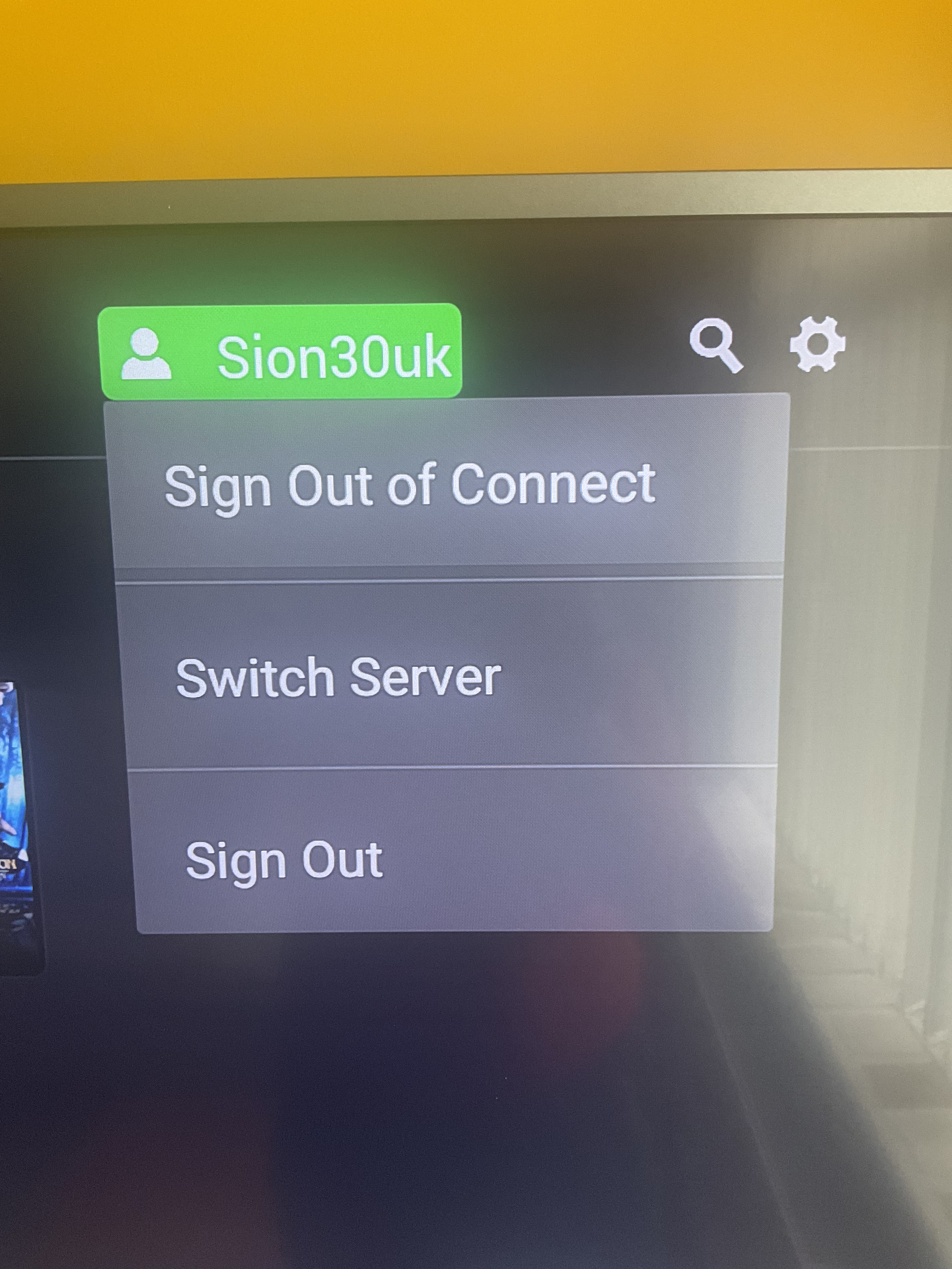

Sion30uk 0 Posted March 20, 2025 Author Posted March 20, 2025 (edited) Yes the only choices are sign out of connect, switch server or just sign out..I have tried all of those and I end up back in the same place, which is the Home Screen of my Emby log back in.. The only other things at the top right are a search permission and the cog which only changes settings.. the only time I have been offered the option of any related to a password was when I try to log on to my local host on my ipad which then gives me the option to reset and then gives me an android location for the 4 digit passcode to enter to reset my local host Because I can’t get the local host on my shield to generate a link to a 4 digit code file manager won’t work, I need to find a way to come out of Emby on the shield so I can reset it all. Edited March 20, 2025 by Sion30uk
Luke 42237 Posted March 20, 2025 Posted March 20, 2025 What happens when you click the cog? Have you explored that?

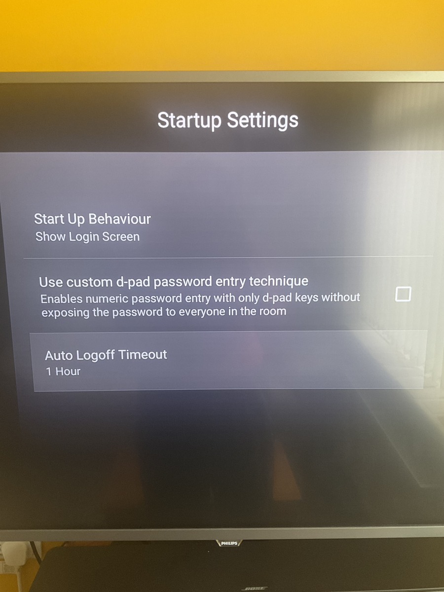

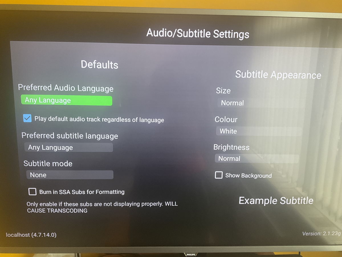

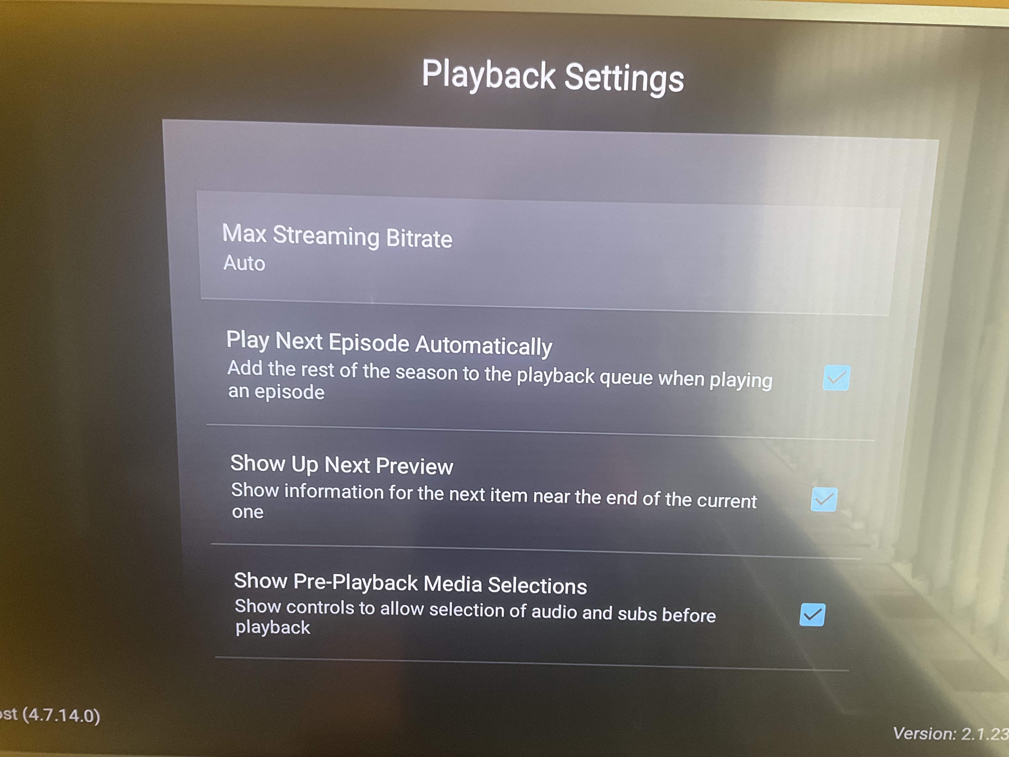

Sion30uk 0 Posted March 20, 2025 Author Posted March 20, 2025 Yes the only options in there are related to the functionality or appearance and sound.

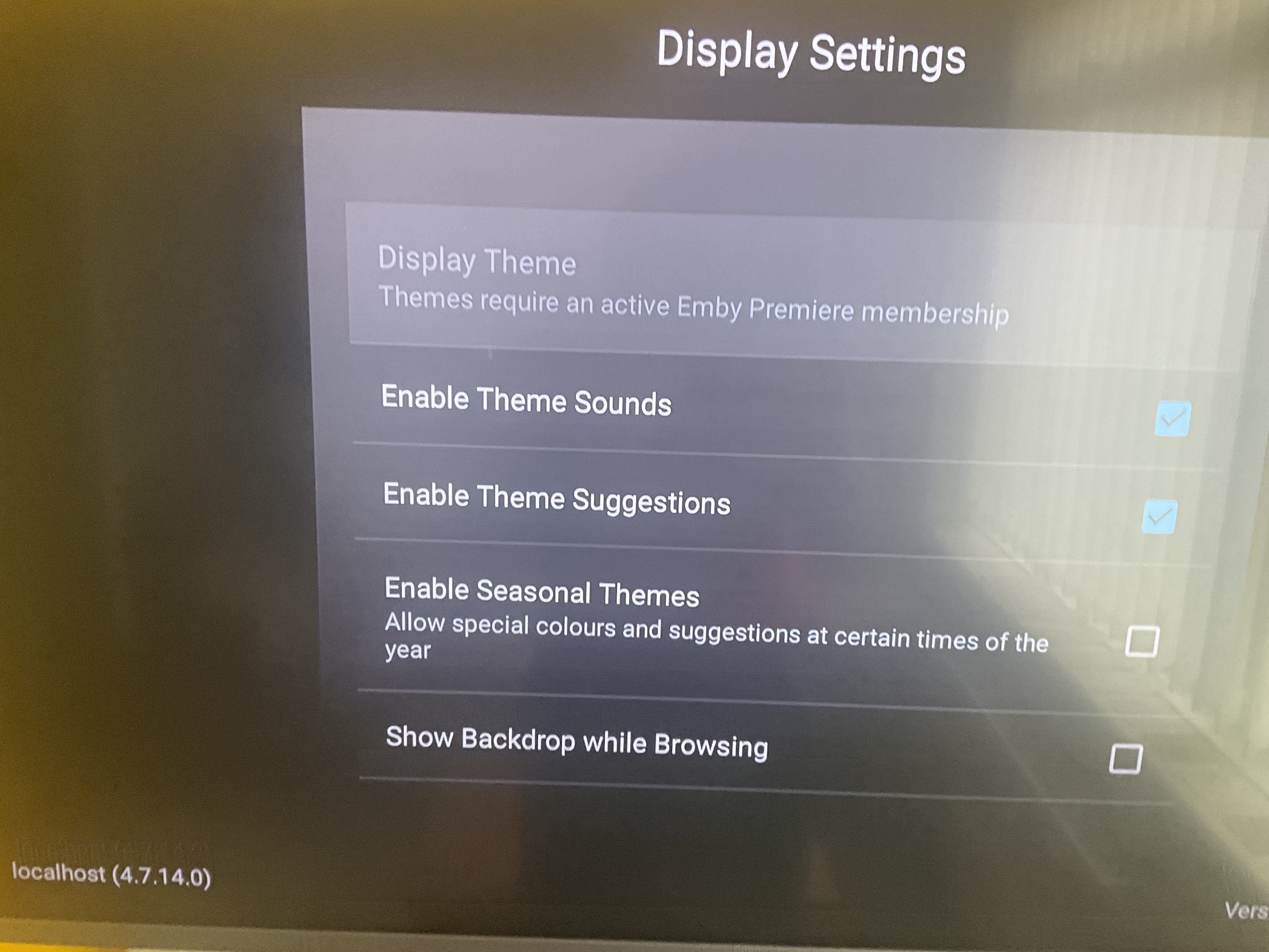

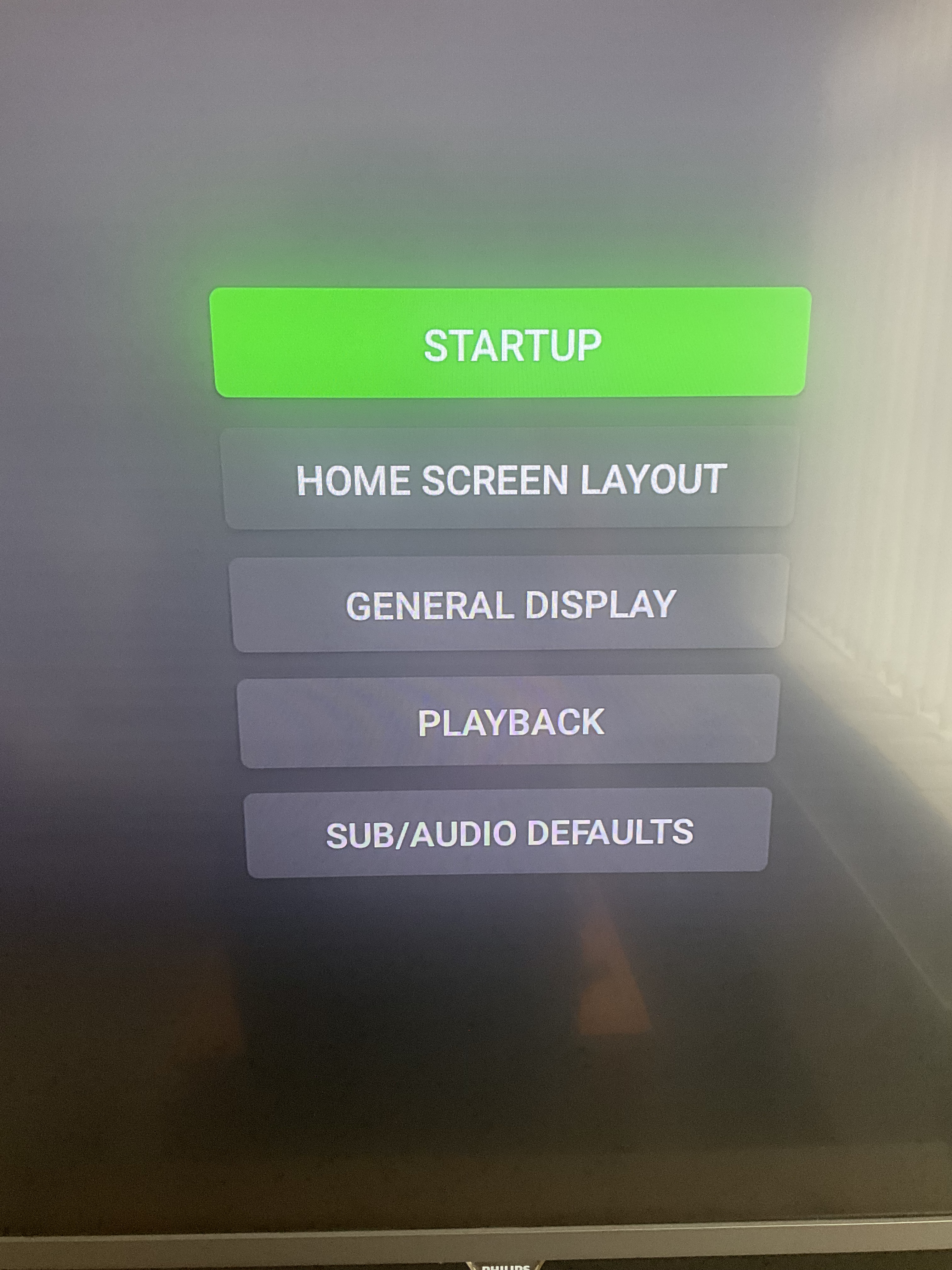

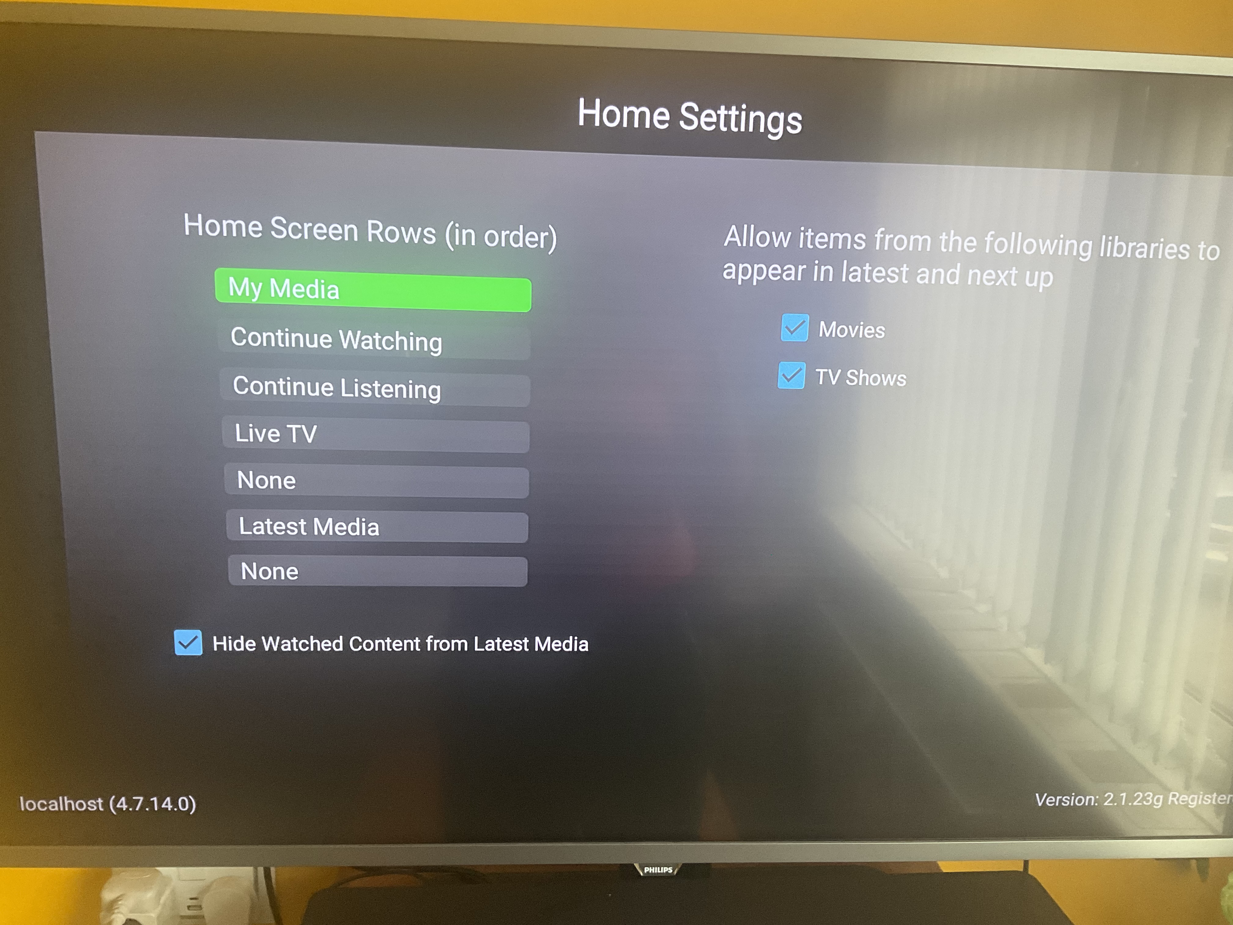

Luke 42237 Posted March 20, 2025 Posted March 20, 2025 1 minute ago, Sion30uk said: Yes the only options in there are related to the functionality or appearance and sound. Can you please show a screenshot?
Sion30uk 0 Posted March 21, 2025 Author Posted March 21, 2025 Here are the options and what is in them
Luke 42237 Posted March 21, 2025 Posted March 21, 2025 OK that is the TV client app for the Shield. Since you are also running the server on the Shield, I thought you meant the web interface. What device did you use to control the web interface when you first setup the server?
