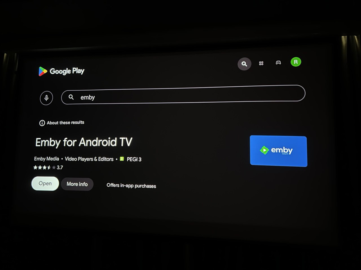

razclud 5 Posted March 31, 2025 Author Posted March 31, 2025 (edited) In the app store, the one i have installed, is the only one displayed when i search for emby. Like in the picture attached. Following the link you gave me is another version of it? Different from the one in the app store? Edited March 31, 2025 by razclud
seanbuff 1356 Posted March 31, 2025 Posted March 31, 2025 @razcludIn the Play Store, if you actually search for "Emb" (without the Y) you will see two results for Emby... The team are asking you to install and try the one named "Emby for Android" without TV in the name. You can install both apps and they will happily co-exist on the same device.
razclud 5 Posted March 31, 2025 Author Posted March 31, 2025 4 minutes ago, seanbuff said: @razcludIn the Play Store, if you actually search for "Emb" (without the Y) you will see two results for Emby... The team are asking you to install and try the one named "Emby for Android" without TV in the name. You can install both apps and they will happily co-exist on the same device. Hence the skit reference... thank you Sean! Luke, this is how you should have said it. There are dummies like me around... 1
