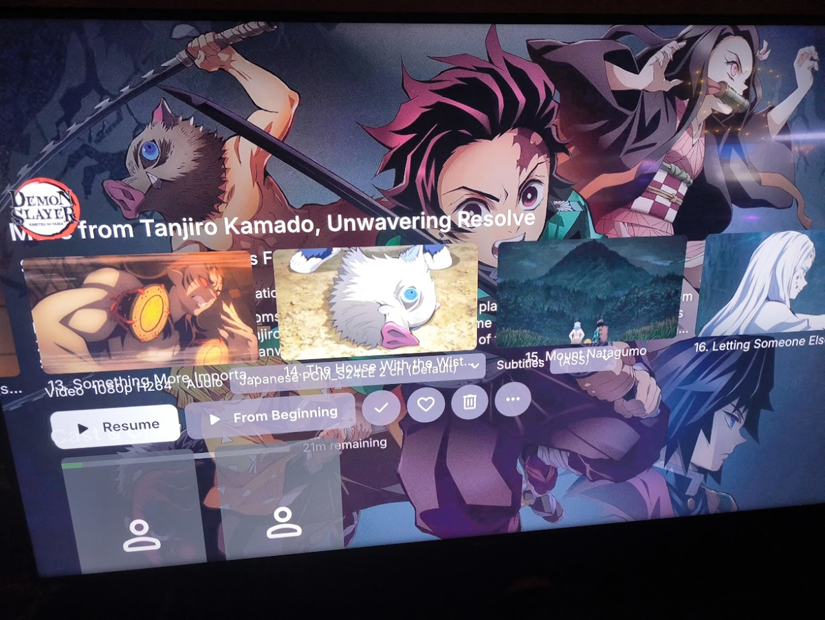

verdynius 9 Posted March 20, 2025 Author Posted March 20, 2025 Sorry to inform you, but the issue wasn't resolved by the new version. However the UI is broken, see attached screenshot.
verdynius 9 Posted March 20, 2025 Author Posted March 20, 2025 Yep, settings look okay. Login is also fine. Only the screens where you start the playback (as seen on the attached photo) seem to be broken.
Luke 42239 Posted March 21, 2025 Posted March 21, 2025 OK please try the 2.0.0 update and let me know if this resolves the UI. We are still looking at the subtitle problem. Thanks.
verdynius 9 Posted March 21, 2025 Author Posted March 21, 2025 The UI is back to normal with the 2.0.0 update. 1

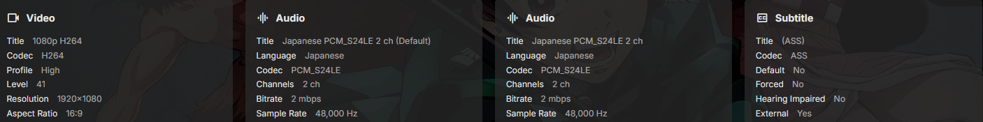

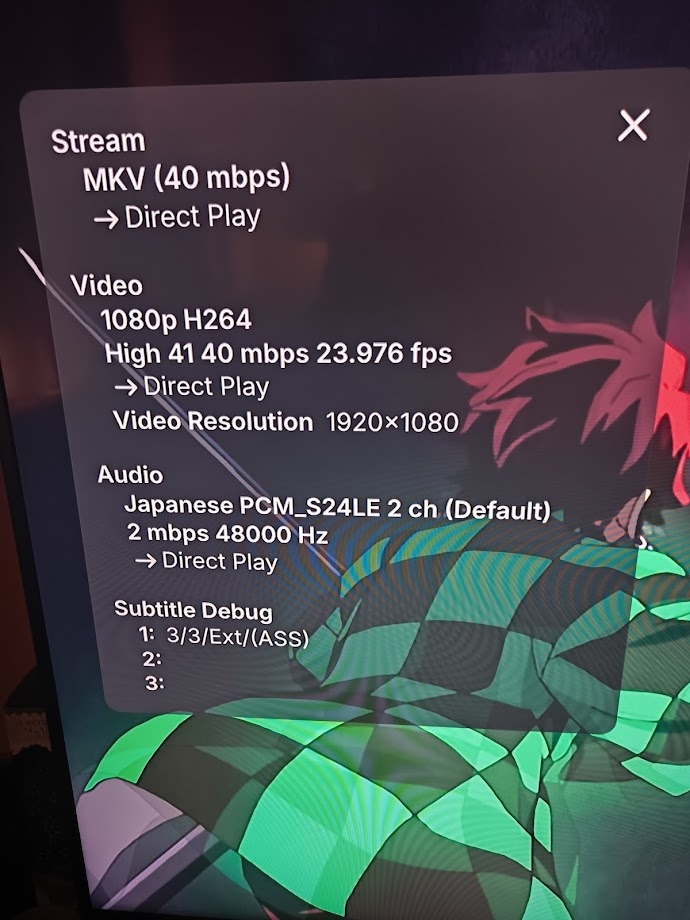

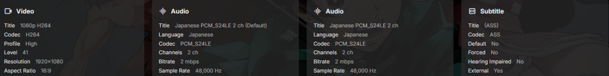

SamES 1084 Posted March 24, 2025 Posted March 24, 2025 1 hour ago, verdynius said: Still no luck, just tried it the usual way Strange, it was working for me after this fix. Did you wait for up to a minute? What language is the ASS supposed to display? Have you tried a few different files with ASS? Is this file using DirectPlay? Can you attach any logs from your test? Can you post the full media info for this file from the bottom of the details screen on the server?
verdynius 9 Posted March 24, 2025 Author Posted March 24, 2025 Answers in order: Yes, I did wait, more than a minute. Switched subtitle off, then on, waited again. The language of the subtitle is hungarian. Haven't had the time to try with other content, will get to it once I have some more time. However, the subtitle for the content I'm trying to watch worked before the update. I'm using direct play. The rest is attached to this post. embyserver.txt
