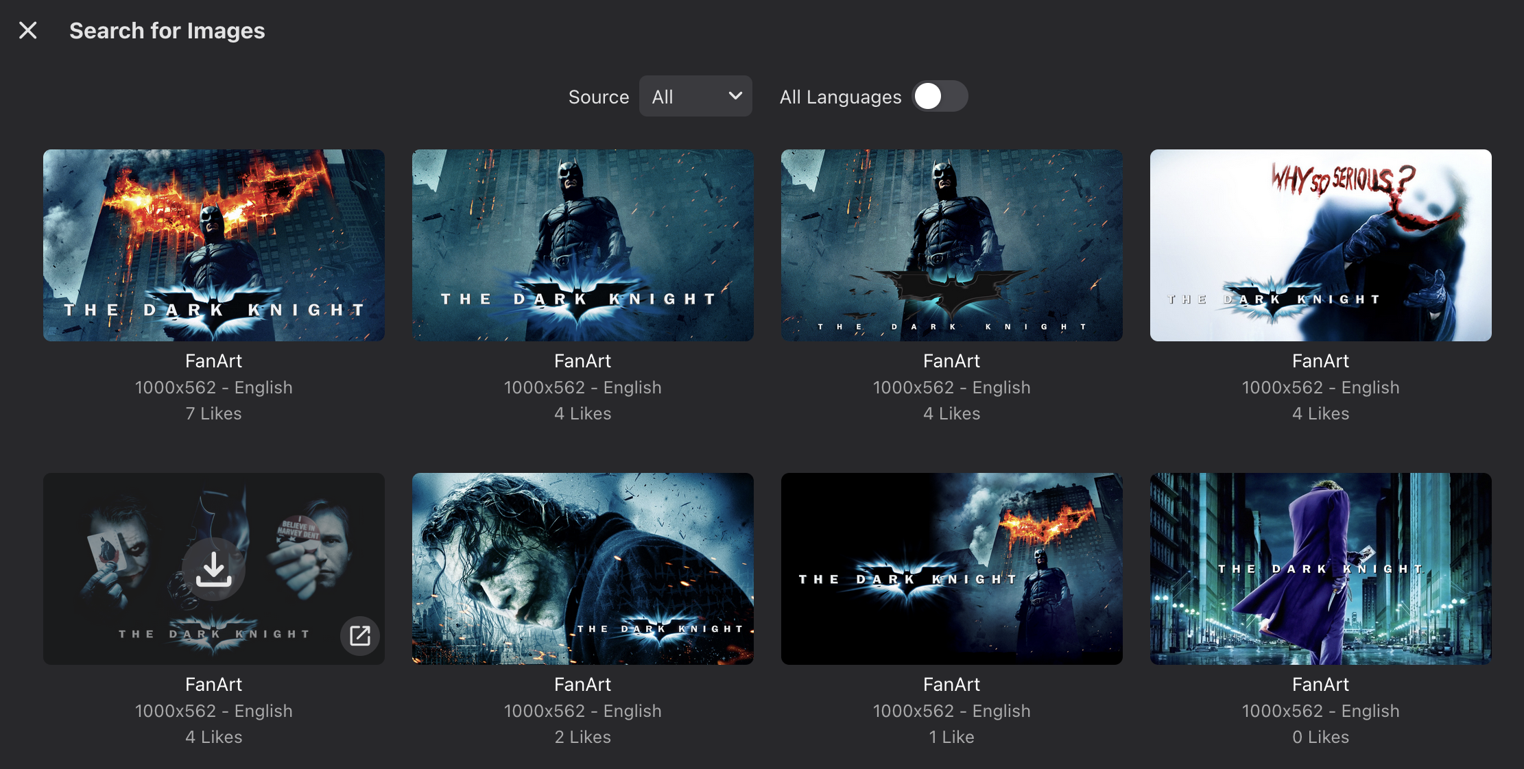

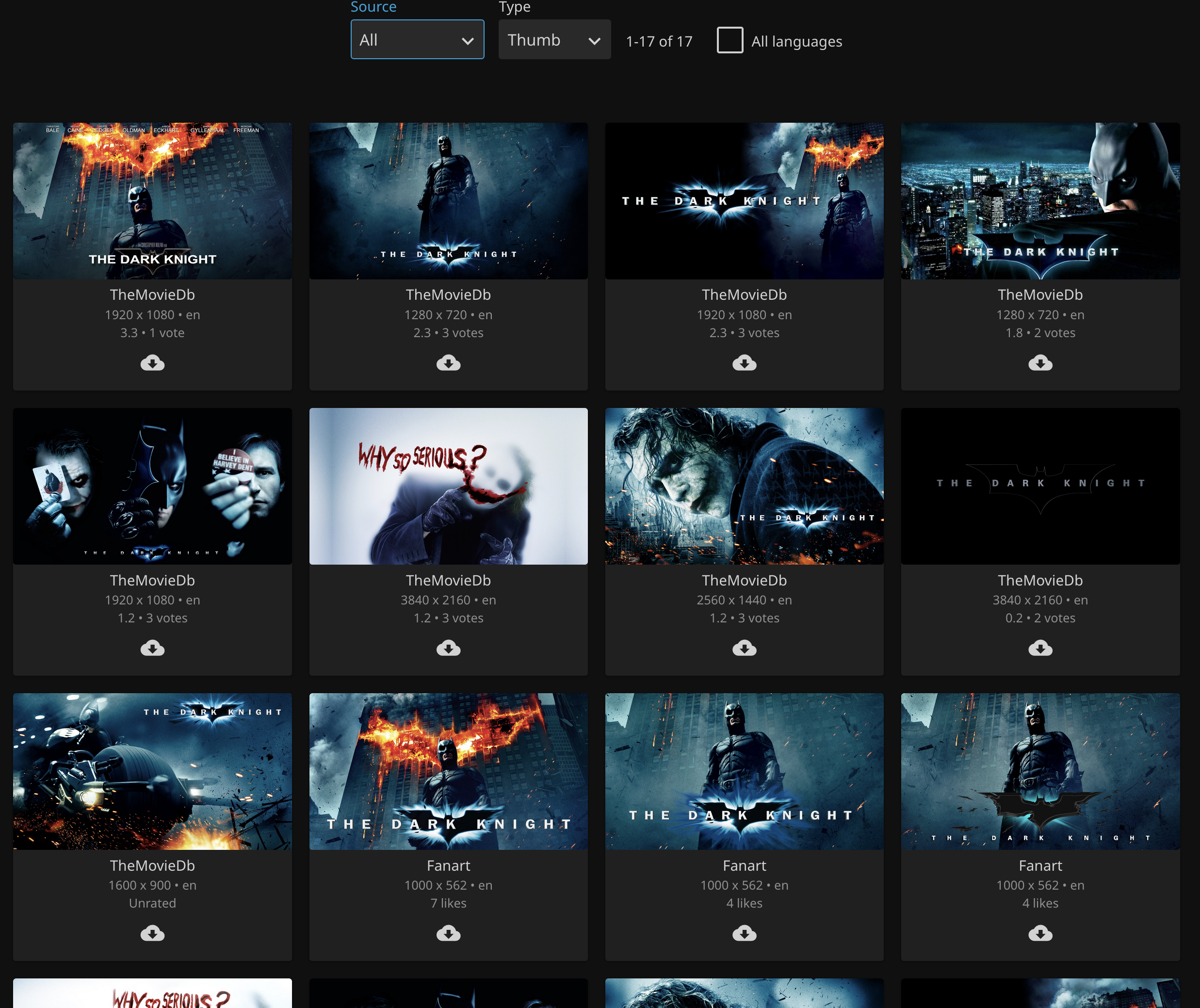

Interesting. I am seeing a discrepancy between the thumb images Emby and Jellyfin provides. It sounds like you are saying there may not be a problem, that Emby is getting the images it is intending. And by extension, maybe Jellyfin is getting images that are unintended to be thumbs? I also may have muddied the issue slightly, as doing a bunch of tests in Jellyfin right now, I'm only getting extra images from TMDB, not from TVDB.
Attached are screenshots of the Thumbs results from Emby and Jellyfin. The extra images Jellyfin provides from TMDB generally appear to be similar to the ones Fanart provides, except that that they are of a higher resolution. Those images aren't "thumbs" ?
As you can see technically no as Emby has not taken the time to port/map them to thumbs and have removed them as even backdrop options.
