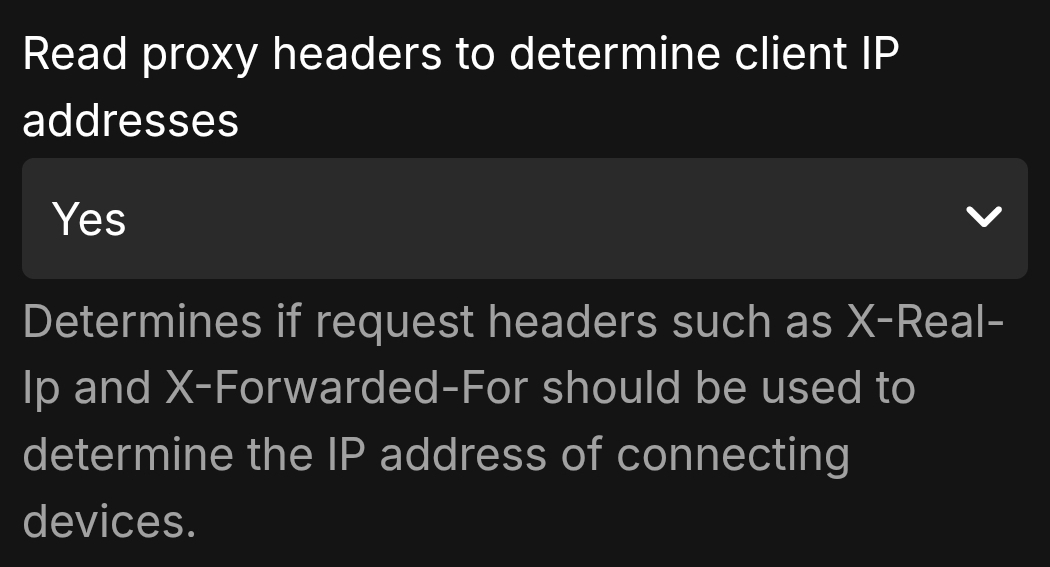

darkassassin07 668 Posted March 18, 2025 Posted March 18, 2025 (edited) proxy_set_header X-Real-IP $remote_addr; proxy_set_header X-Forwarded-For $proxy_add_x_forwarded_for; You need these two headers set. These are the lines directly from nginxs config; I'm not sure how you enable/set them in NPM as I don't use that. You must also set this setting in Emby > Network Edited March 18, 2025 by darkassassin07 1
dustart 8 Posted March 18, 2025 Author Posted March 18, 2025 2 hours ago, darkassassin07 said: proxy_set_header X-Real-IP $remote_addr; proxy_set_header X-Forwarded-For $proxy_add_x_forwarded_for; You need these two headers set. These are the lines directly from nginxs config; I'm not sure how you enable/set them in NPM as I don't use that. You must also set this setting in Emby > Network I tried this already , nothing changes .. Stil showing ip from docker..
