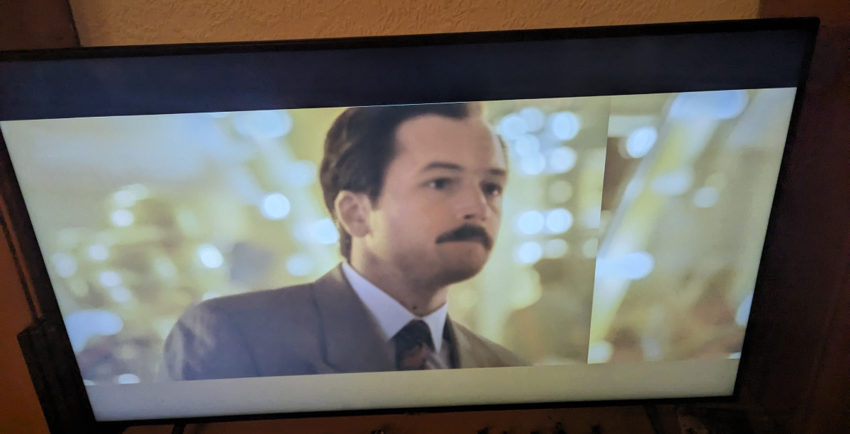

phunzie 42 Posted March 17, 2025 Posted March 17, 2025 (edited) I have a Samsung tv that obviously doesn't support Dolby Vision, only HDR10+. When using a Fire Stick 4K Max with the Emby app to play an mkv that includes both DV and HDR10+ encoding, playback is completely screwed up. If I play an mkv with only HDR10+ it plays fine. Kodi has a setting that allows you to choose which HDR type to play, HDR10+ or Dolby Vision, and has no problem playing the files without issue. Any setting like this for Emby? Edited March 17, 2025 by phunzie
phunzie 42 Posted March 17, 2025 Author Posted March 17, 2025 i read in another thread about the 2 different Emby apps. Tried both, same results with each when playing mkv that includes both HDR types, DV and HDR10+.

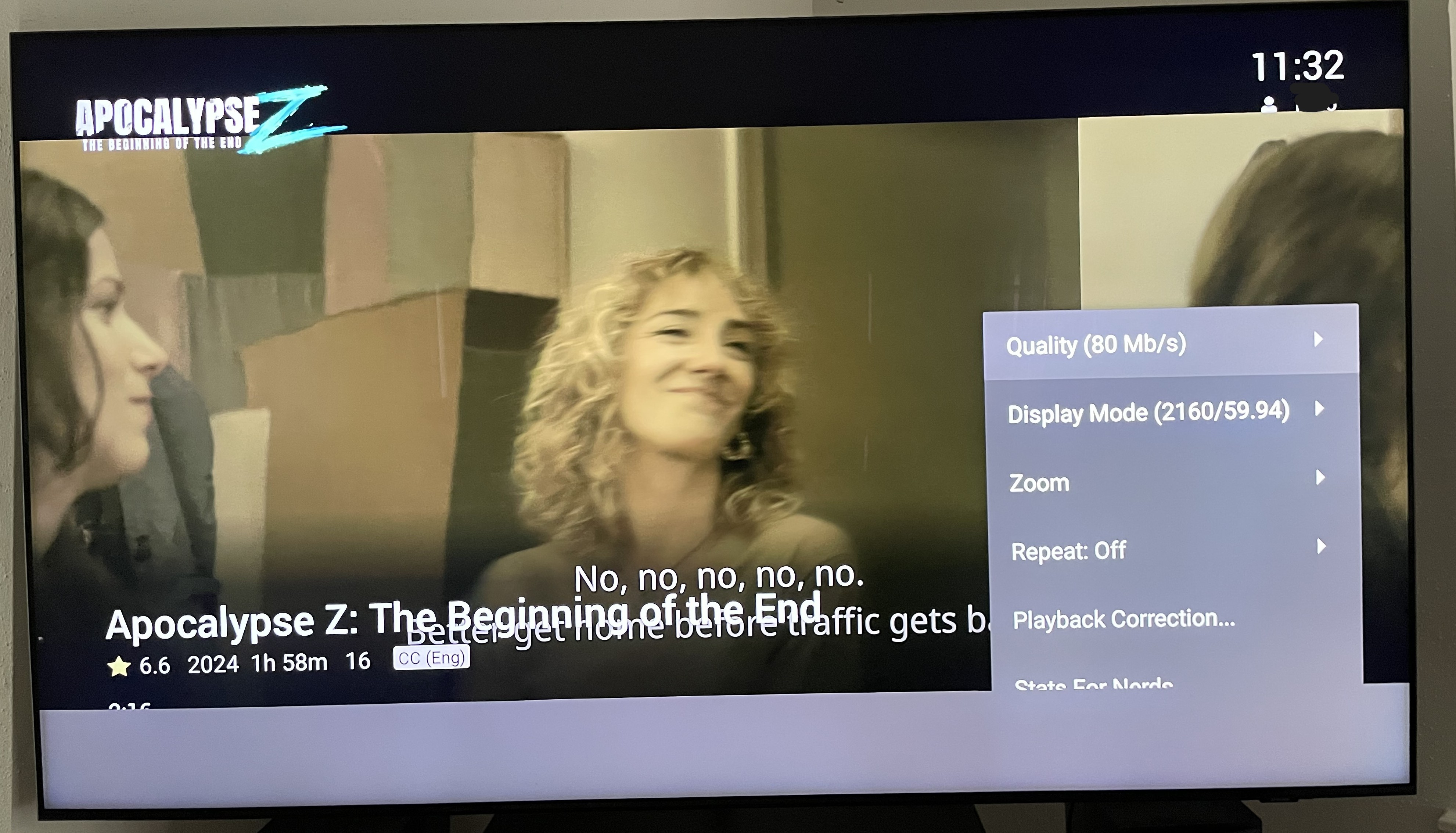

phunzie 42 Posted March 19, 2025 Author Posted March 19, 2025 (edited) thanks for pointing out the Playback Correction tool...solved my problem!...but it took some playing around to find the setting, as my playback issue didn't result in a black screen like many others, but rather the tv image was shifted like 20% to the left, and there was an opaque gray band along the bottom of the screen, which blocked me from seeing the choices available after pushing the down button...had to figure out i had to push Down button, then blindly press Right button 6 times , then Enter, to access the Playback settings menu i also noticed the Playback Correction tool doesn't seem to be available in the regular Android version of the Emby app Edited March 19, 2025 by phunzie added pic 1
