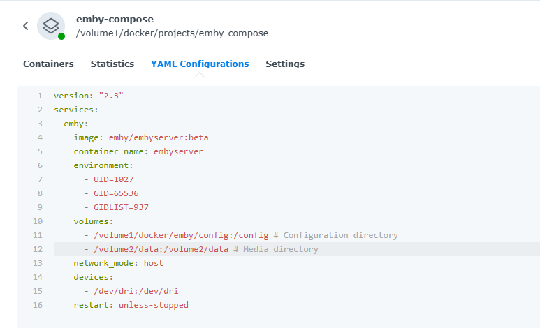

Sparker 44 Posted March 16, 2025 Posted March 16, 2025 Can I use the restore from backup if I migrate from Synology DSM 7.2x app to Docker? I will be using the same version of Emby (4.9.0.42 beta) and the media files will be the same path /volume2/data I've read the documentation and I am ready to go, but it is late here and I want to watch some TV before bed (I did not uninstall the app yet either). Here is my docker-compose version: "2.3" services: emby: image: emby/embyserver:beta container_name: embyserver environment: - UID=1027 #dockerlimited - GID=65536 #dockergroup - GIDLIST=937 #retrieved from ssh intel igpu device group id volumes: - /volume1/docker/emby/config:/config # Configuration directory - /volume2/data:/data # Media directory network_mode: host devices: - /dev/dri:/dev/dri restart: unless-stopped I use Watchtower for my other containers, so Emby will be auto-updated and take the hassle out of updating once every x weeks/months.

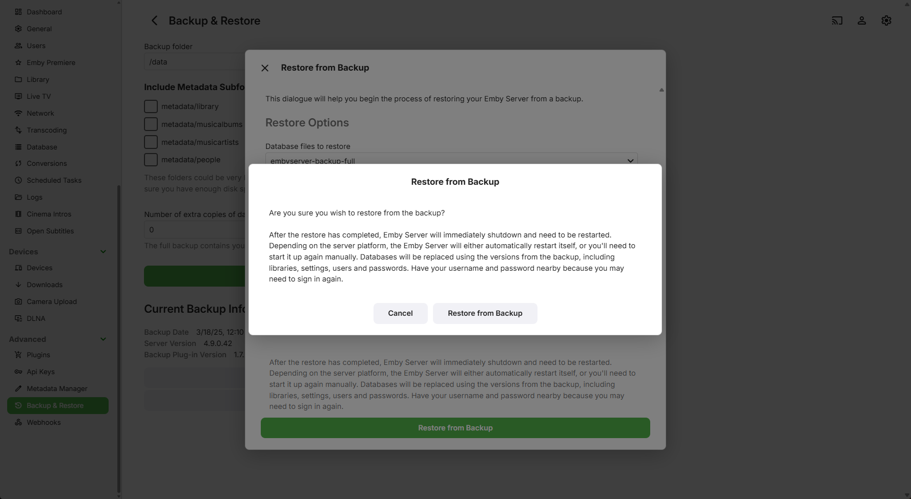

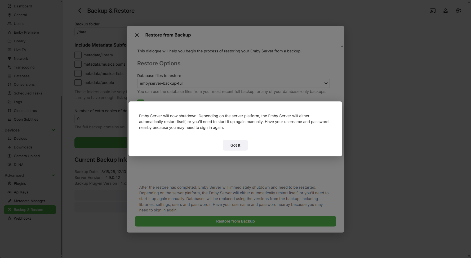

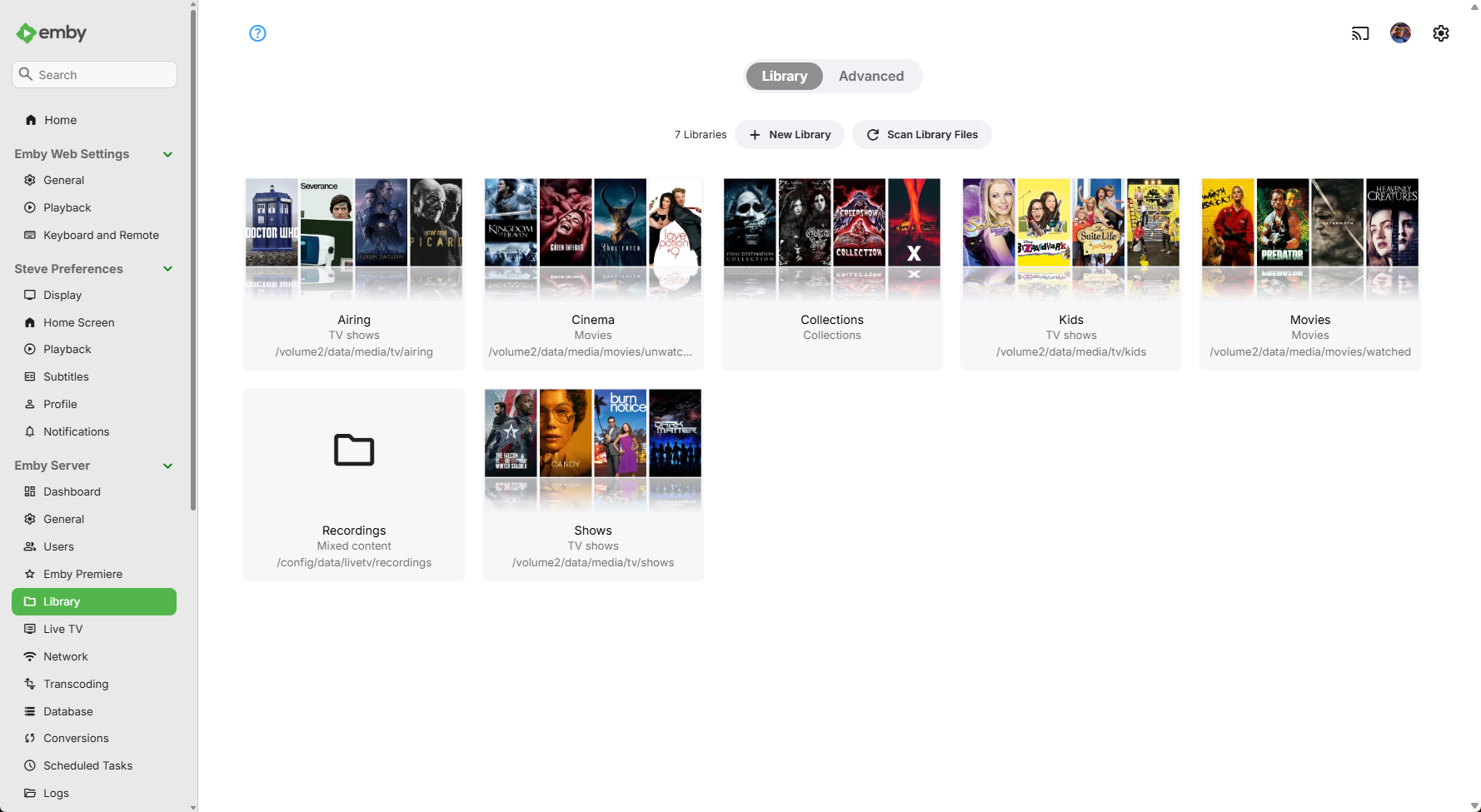

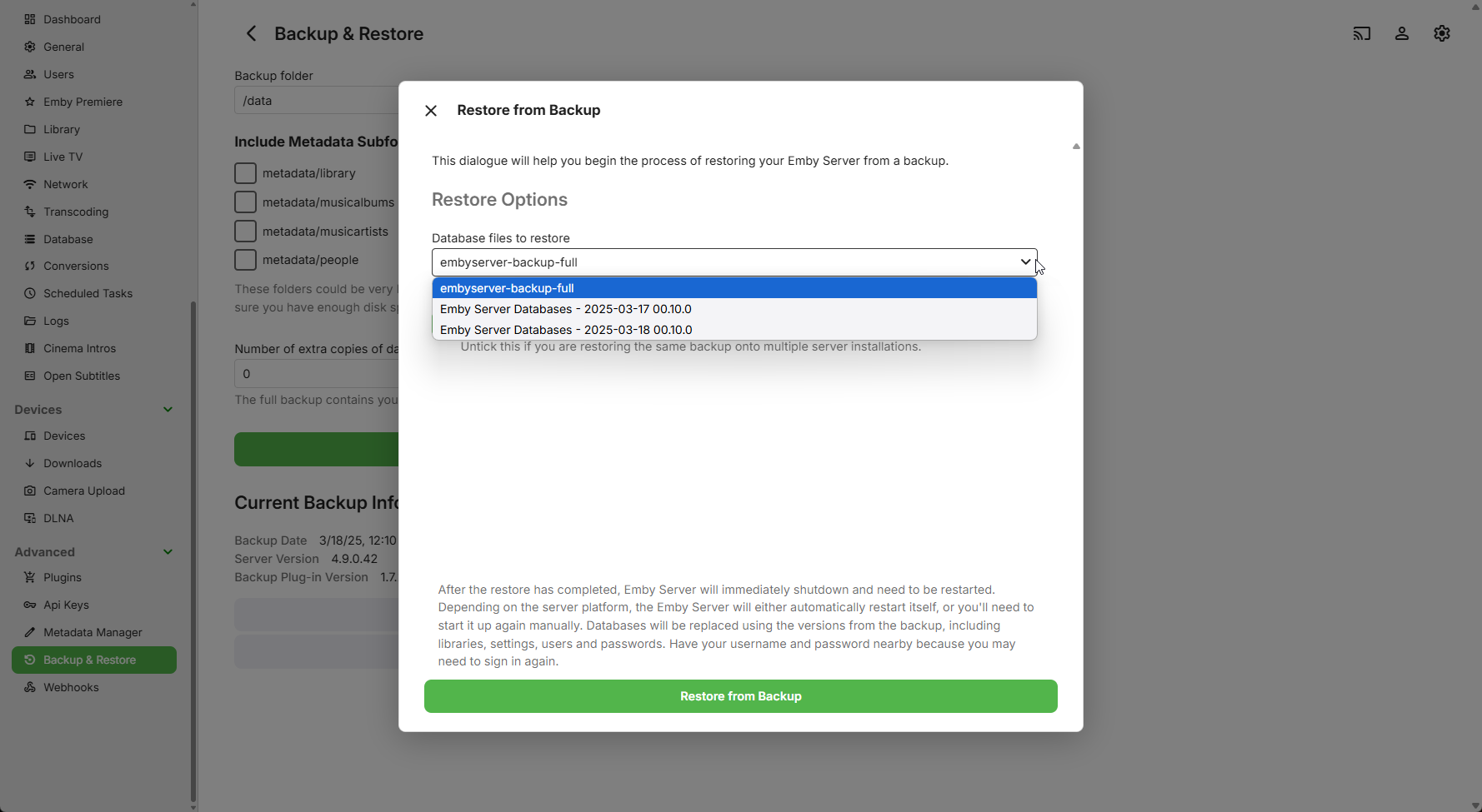

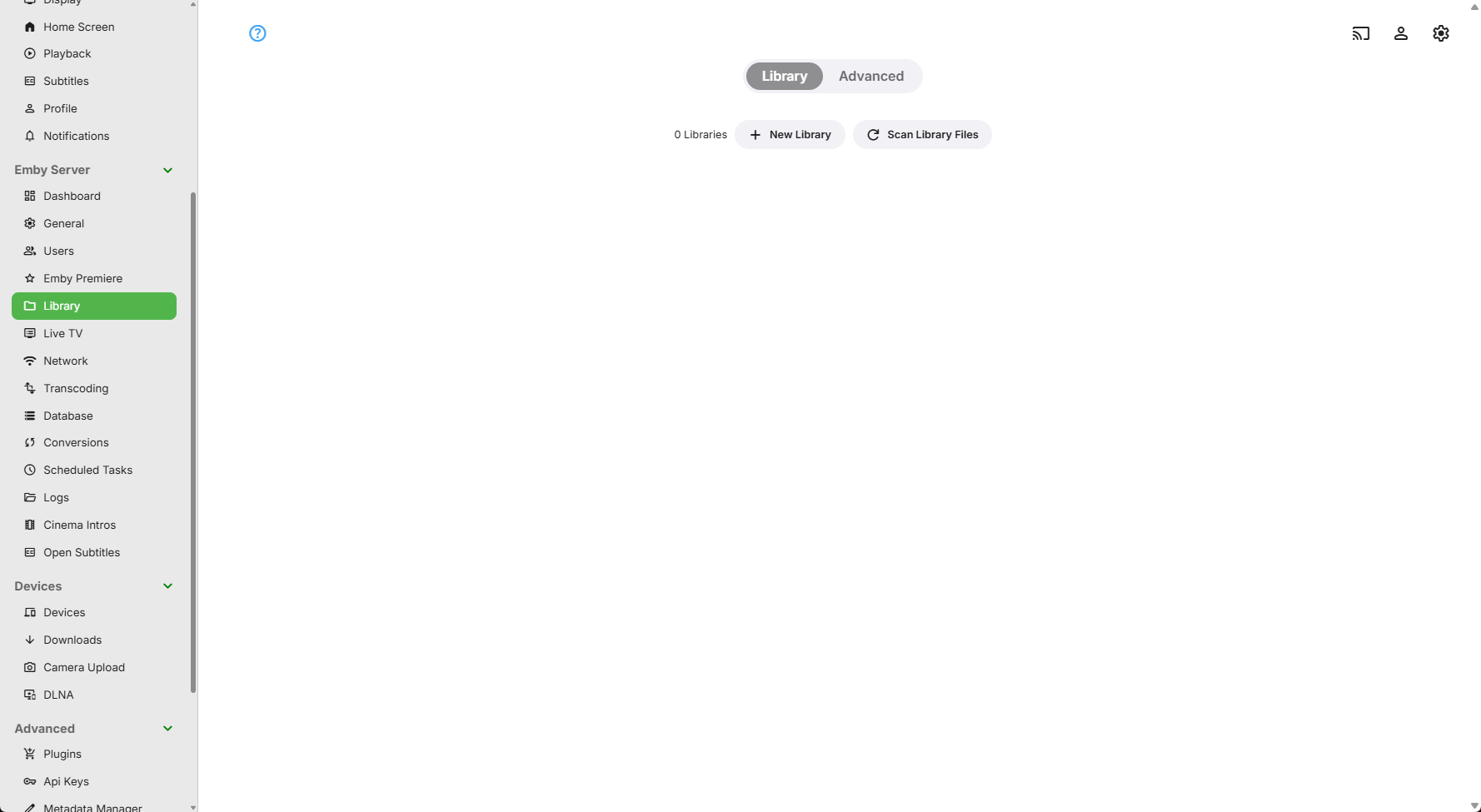

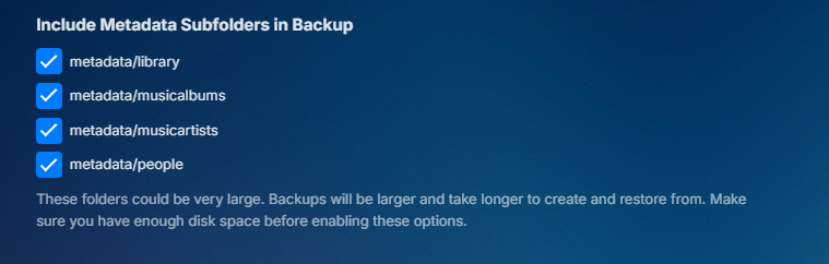

Sparker 44 Posted March 18, 2025 Author Posted March 18, 2025 22 hours ago, Carlo said: Did you try it yet? How did it go? Yes, it seemed to work! I stopped the EmbyServer package in DSM (I did not uninstall it) I built the EmbyServer docker project skipped setting up a library Logged into Emby and added my premiere key I set backup path to the same one as from Package install I was offfered Full recent backup and a couple of metadata snapshots Before After It looks like a bunch of images are missing @Lukewhat task should I kick to repopulate the metadata? Or is there a path I could copy all the metadata from the app install on DSM to the Docker config directory to repopulate images/subtitles etc? Then I need to add the new Docker instance api key to Sonarr, Radarr, Watchstate etc etc 1
Happy2Play 9811 Posted March 18, 2025 Posted March 18, 2025 (edited) Does your backup include all Metadata folders? Otherwise you will probably need to do a complete Refresh of all your media somewhat the same as a new install. You could manually copy this folder over and run the Metadata Folder task. Edited March 18, 2025 by Happy2Play
Sparker 44 Posted March 18, 2025 Author Posted March 18, 2025 1 minute ago, Happy2Play said: Does your backup include all Metadata folders? Otherwise you will probably need to do a complete Refresh of all your media somewhat the same as a new install. You could manually copy this folder over and run the Metadata Folder task. Yeah it did, but unfortunately for me the path to the media was not exactly the same /volume2/data/media (DSM app) vs /data/data/media (Docker) I am updating libraries with the correct path now

Happy2Play 9811 Posted March 18, 2025 Posted March 18, 2025 (edited) 11 minutes ago, Sparker said: Yeah it did, but unfortunately for me the path to the media was not exactly the same /volume2/data/media (DSM app) vs /data/data/media (Docker) I am updating libraries with the correct path now Okay yah with media path changes these cross platform path issues exist and somewhat require database hack or removing/readding libraries. Discussed in many topics but here is one example Edited March 18, 2025 by Happy2Play 1
Sparker 44 Posted March 18, 2025 Author Posted March 18, 2025 (edited) Ugh, I overthought this. I just trashed the Docker container and simply changed the media path to the "old" DSM package one, built it reimported the backup again, and everything is there, metadata and all. Hardware transcoding also enabled fine! Edited March 18, 2025 by Sparker 2 1
