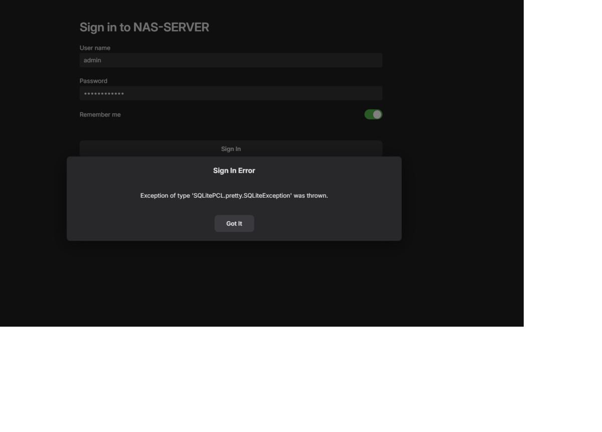

Exception of type 'SQLitePCL.pretty.SQLiteException' was thrown.

Hey everyone,
I'm having an issue with Emby and hoping someone can help. It suddenly stopped working, so I tried updating the app and restarting my server, but now I can't log into my Emby account at all. I've double-checked my credentials, but nothing seems to work.
Has anyone else experienced this issue? Could it be related to the update, or is there something else I should try? Any advice would be greatly appreciated!
Thanks in advance!
Happy2Play
Image is too small to read but devs will need to see the server log.
Hi,
How can I show them the logs if I can't log in?
Happy2Play
Just now, nusuzst said:
Hi,
Every platform is different but will guess you need to ssh into your NAS.  Paths can be found here.
Happy2Play
Ok haven't seen this in awhile but you have got the database in a Locked condition and have to do some digging
SQLiteException: Busy: database is locked
You have to shut down Emby and go to Data path: /share/CACHEDEV1_DATA/.qpkg/EmbyServer/programdata/data and delete the .shm and .wal files.
https://emby.media/support/articles/Corrupt-Database.html?q=corrupt#:~:text=Remove Database Locks
  • Solution
An easy thing to try before going to all of that would be to just reboot the server machine and see if that cures it.
Ok I'll try. Thank you
Please let us know how things go. Thanks.
Restart did help!  Amazing, Thank you so much for the help guys  :)
